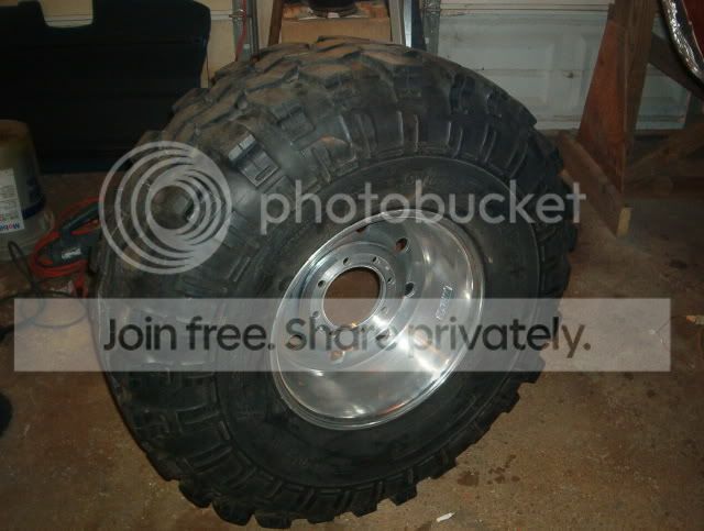

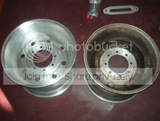

Then I really changed tracks when Odin hooked me up with some Weld Super Singles... Definitely wasn't a way I was looking to go... The theme was supposed to be satin black and copper, steel beadlocks, bumpers, etc, not bling.... But being the rig will be on the street 75% of the time I figured why not, and I've always loved those rims..
top left- back untouched... top right- front untouched.... bottom right-back scrubbed... bottom left - back polished
before and after backs, after flap wheel, wetsand and buff...
TSL's mounted up....

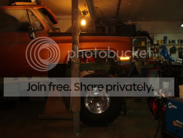

how they look in the wells....

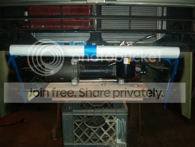

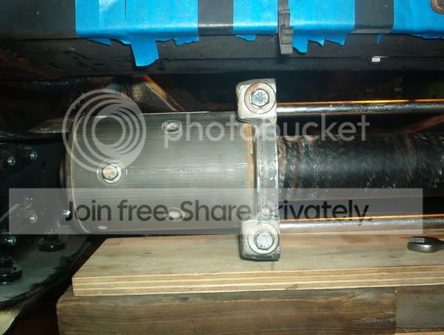

picked up an XD9000 (thanks Obijuan!), and clocked the lever 90 degrees.....

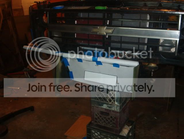

and here's my mockup on the bumper... really was gonna wait on this till it's done, but what the hey.... picking up all the flat and angle iron stuff monday, and hopefully I'll have tube and a bender in a couple weeks...
winch in position... the lever will come thru a hole in the skid...
location in relation to top tube (gotta love oaktag!!)
how the rest of the top tube and removable skid will be... I'm not chopping the horns... the main tube at the end of them allows for some angle to side sections of the main tube...
I'll be running 4 remote filter assemblies behind the main tube, accessable with the skid removed..
obviously the B-52's plate will be lopped off at that angle... also the D-ring mounts are a 3/4 backing plate integrated into the bumper to sandwich the front frame horn.. those will come out straight from the frame and be aprox 1" thick out at the D-ring hole... the skid will be notched to slide over this...
kinda hard to explain, but as I fab it up the next couple weeks, I'll take lots of pics..
also, that tube is 2"... it will then have a stinger from rail to rail on top of that tube that is 2", with angle tubes of 1.75 over to the corners.. and upward 1.75 front supports that run from the forward 2 holes of the B-52 spring mounts to the outer, underside corners...
along the lines of this....
