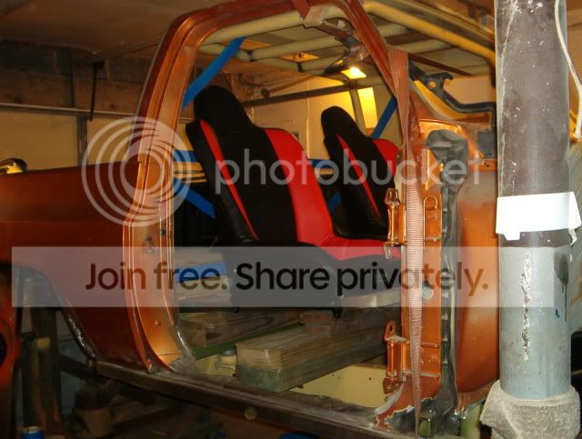

87 K5 Build...Hmmm, whats that Ryoken up to? stay tuned...

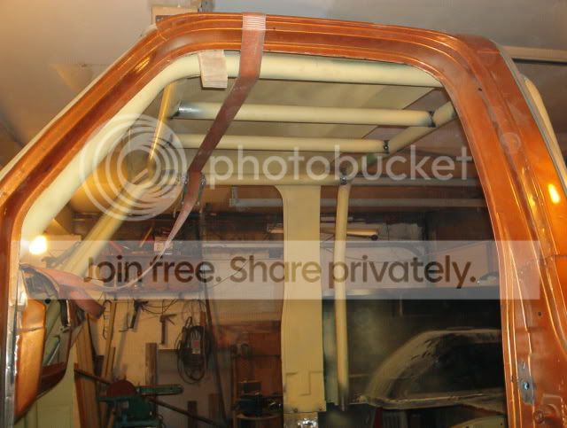

thanks..... Those pics are a bit deceiving... the cage slid down a tad on the strap, it actually goes up and back some... got the center tubes in and fitting up the B-hoop now...

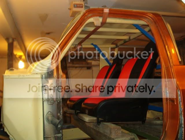

I may actually start on the floor next weekend if I get my cage flanges...

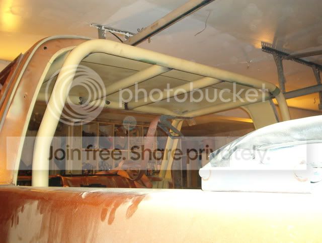

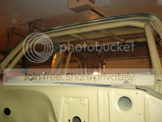

here's the last of the weekend pics... once my gussett's come in, I can drop the cage for the last time....

I'm happy with what I've done so far... that was the pain-in-the-arse stuff... now it gets funner...
it's definitely lacking some triangulation, but I figure with the 2", some gussett's up top, and the triangulation I'm doing for the rest will make up for it...
stoked on getting the 1.5" die at the end of the week... :woot::saweet:

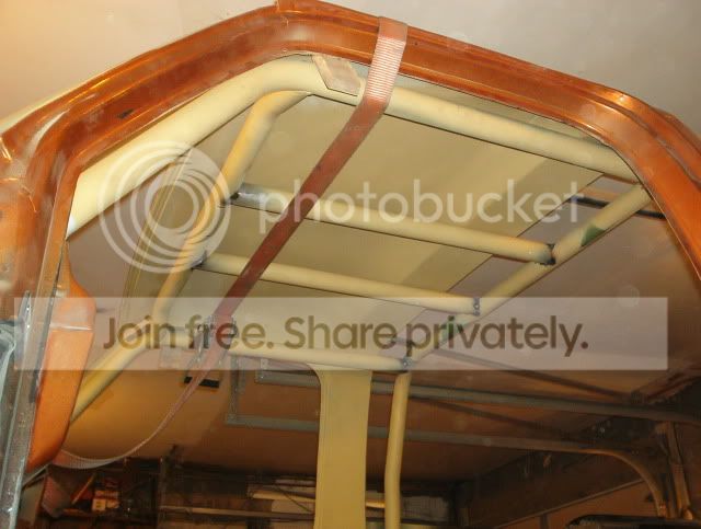

oh, and here's how I'm doing the overhead console...
I'm using Kert's flush panel mount tabs to secure a flat sheet of the black composite I've been using throughout the build between the 2 center tubes.....
I'll be using a combo of those in flush and center, to mount composite panels on the floor console too....

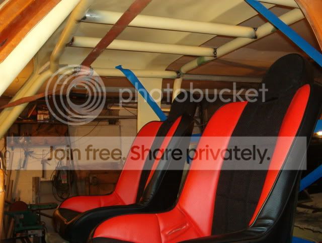

if ya liked the hammer/brush spacers, you'll dig my walmanized seat brackets... no termites for me!!?! :haha:
well, I shortchanged myself on 1.5 tube, which I really need, so, I'm just gonna order a stick, and add 2 more 2", and just finish the back of the cage... :wink1: should have enough for the rear winch bumper too....
guessing those are just mock up seat brackets? I'm sorry.... I'm too drunk and stupid right now to decipher what is sarcasm and what is seriousness.:crazy:
:D:D:D
I thought it was funny... alright, I was bored... ;)
yeah just mockup.. getting some final console lines, tube positions, measurements, etc... I've got it pretty much figured out... the center console is going to be pretty psycho, talk about multi-axis bending.... :doah::haha: pretty revved about it....... :saweet:
yup, at 6' 1"... those are the 4" extra tall... eye level is about 1/2 way up the windshield.. as it sits, my noggin is about 8" to 10" from the side tubes, and about 10, 11" to the roof..
but that is one of my remaining unknowns (to be figured out this weekend) is the blue tape mockup piece that I have there, going from the b-hoop forward on the a-tubes.. not sure if that ones gonna be too close.. might size that one down to 1.75, i'll fit something up and see how it looks... I really want to add it for the triangulation/strength factor...
