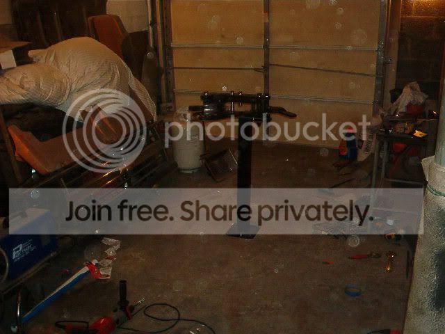

Ryoken... what bender are you using?
Pro Tools 105 HD
oh, a quick review on the bender from me...
works freakin awesome... the only issue I've had was the "cinch" bolt, thru the die to snug the pipe, had to be reworked by me on the 2" die.. for those familiar with the 105...
I found that 3/8 bolt it comes with getting all gnarled up and bent.. I actually had to cut it and drill it out... so, what I did was oversize it and tap it.. now I run a 1/2 fine thread in there, works killer....

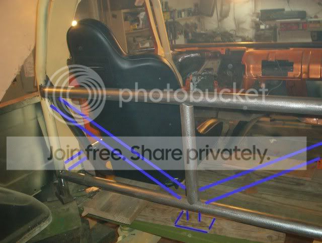

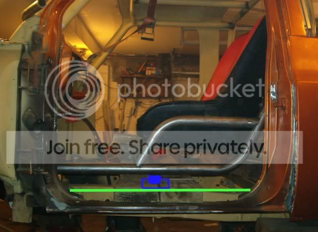

this shows the floor level, and the down tube/ staked cage flange to be installed when the floor goes in...
here's the back... still need to do the 2 diagonals, and the short continuation one from the "armrest" one back to the B-hoop.. the b-hoop also gets a center down tube/cage flange in the middle...
