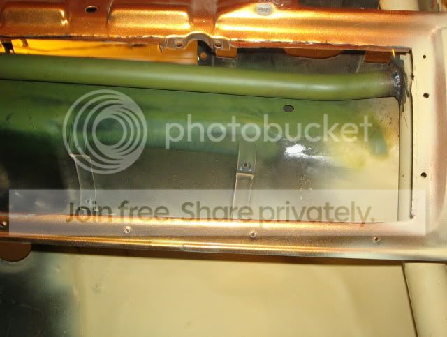

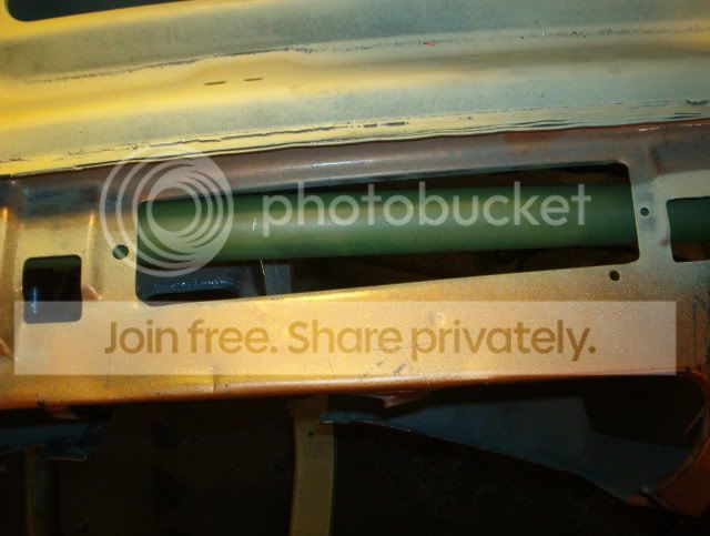

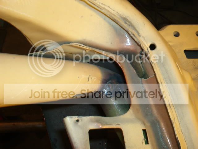

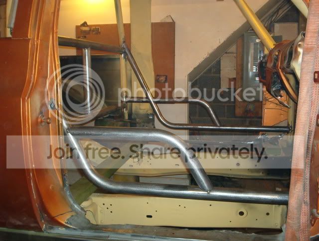

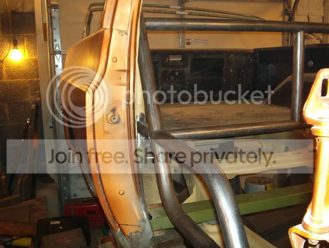

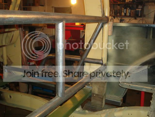

one of the door tube...
tucked in pretty nice... the 2 tubes for the console will come thru the dash and attach to that one..
gotta finish the other door tube and B-pillar, then I get going on the console and seat tubes and the floor...

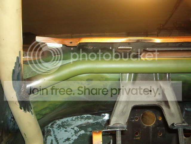

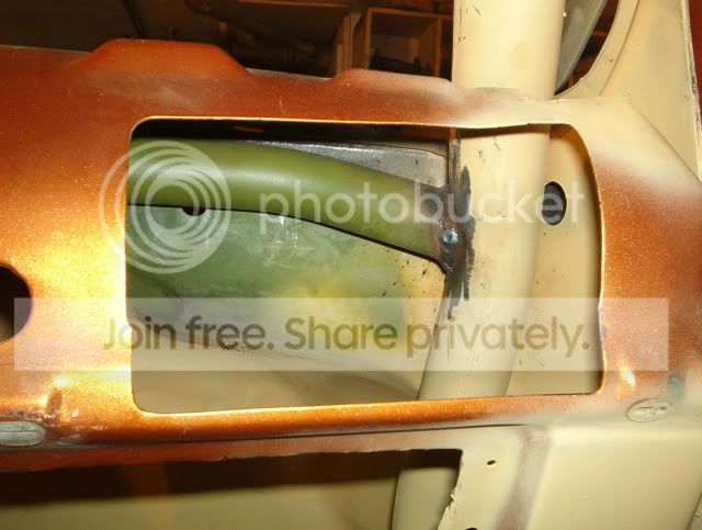

thanks.... I've lucked out on the welding so far, dropped it for all that top stuff.. the dash bar was pretty scary tight, but I managed to nail some decent bead on those... I figure at some point I'll have to try out Rene's "shieldless, flux core" idea... just wish my beads where as sexy as Kerts! :doah::bow:

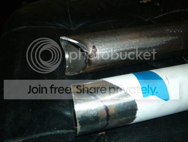

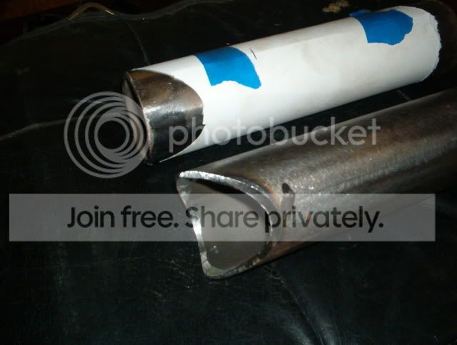

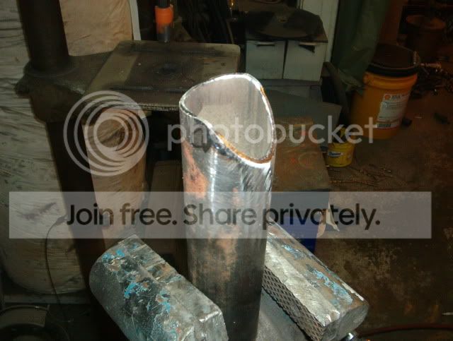

homemade wrappers, for repeating a fishmouth...

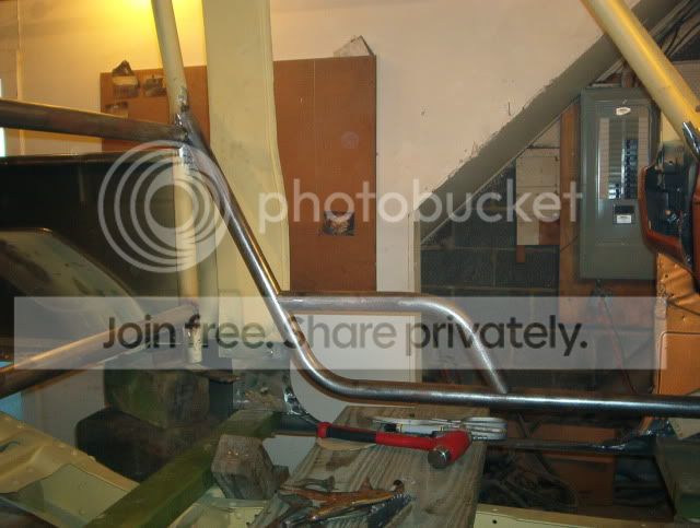

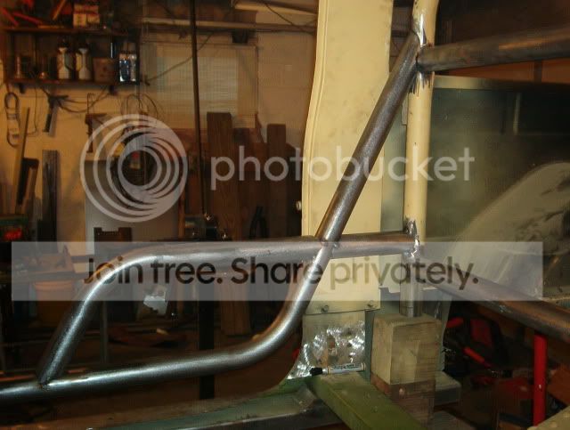

few more pieces to the jungle gym..... tomorrow I'm gonna do the diagonals for the b-hoop and the rear seat tube.....
Paul, have you thought about accessory mounts (fire ext. grab handles, jack mounts, etc.) on the cage anywhere?
yup, to some extent.. I have some tab stuff ordered with Kert... and I've also looked around at stuff on http://fourtreks.com/roll_bar.html
I more than likely will use them for extinguishers, shovel/axe and hi-lift mounts... they're just pricey as he!!..... :eek1::(
shovel/axe and hilift will be on the back portion of the cage.... extinguishers, haven't decided where yet..
I am welding in grab handles up in the a-pillar corners.... just gotta get around to that one...
