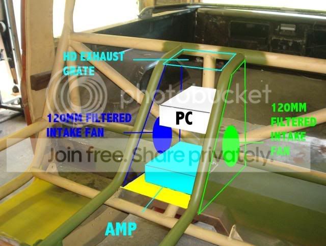

here's some fodder for thought..... a very general design of the PC enclosure... fresh air from behind the seats, exhausted out the top...
just some general ramblings about the above depiction...
the amp/pc locations are subject to change... the PC may end up on the bottom, with the amp mounted to the back wall of the enclosure...
all walls made from composite glass.. the bottom and back will be fixed.... the fanned sides and front will be removable..
I'm thinking a piece of stout expanded steel for the top exhaust, with a light foam element on the inside..
opinions and suggestions appreciated....
