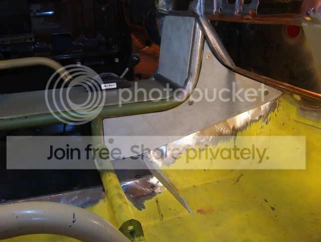

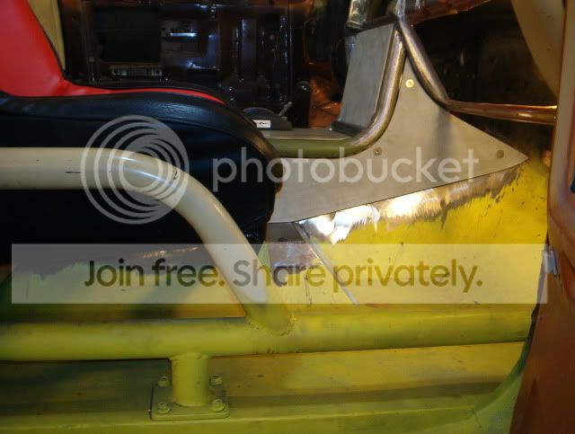

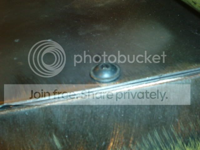

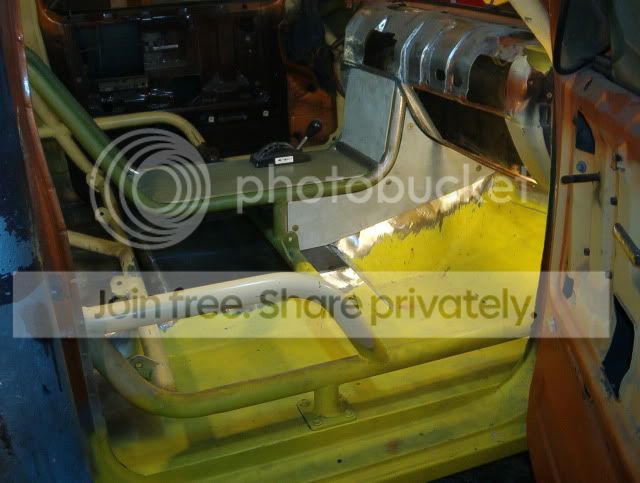

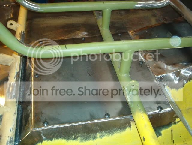

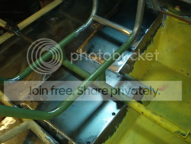

worked the floor a bit today.... got the allen bolts for the cover in with the nuts welded to the underside...
got a little more metal shaping to do still.... the cover will come back out as the floor is brought thru primer, then Imron... then I'll use some 1" wide thin weatherstrip tape on the edge of the floor, then bolt the painted cover back down... then i'll do the floor in Herc...

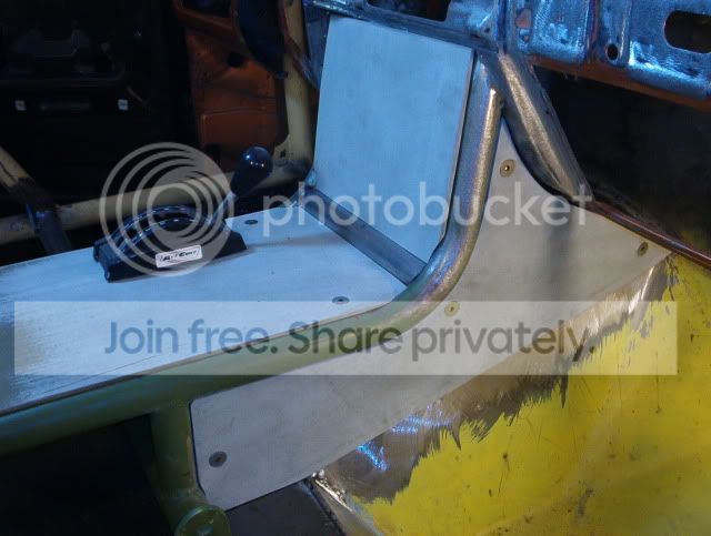

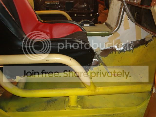

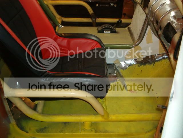

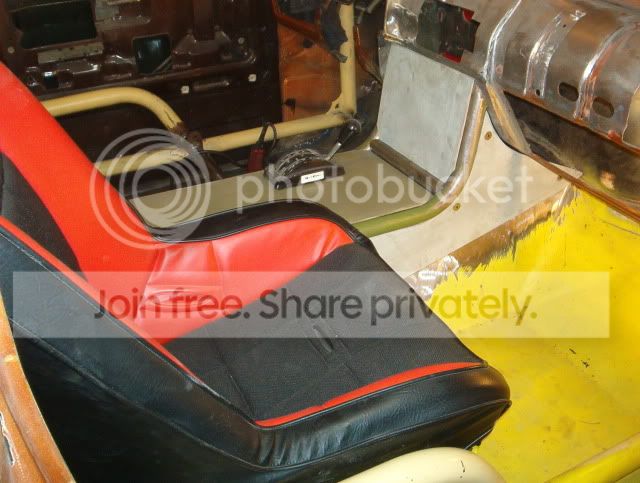

next couple days I'll be cutting side console panels and getting them mounted up.. hopefully the PC box too... so I can get all the panel mounts welded on the cage...
other than the harness tabs, that should take care of all the metalwork in the cab... oh, and I still need to fab up the heater bracket.. I'll probably do that when I'm doing the console sides....

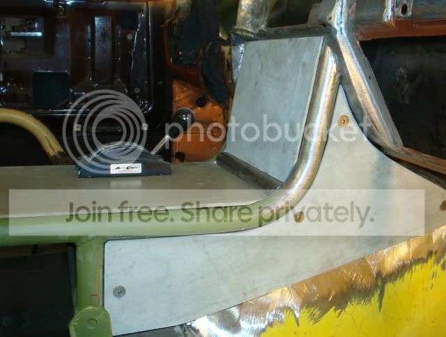

NICE Paul.....looks real good. Are all those panels the laminate?

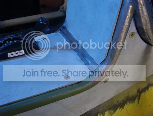

yeah, i'm working on the sides for the PC now..
that just the initial piece for the backwall... I'm doing a 6" deep tool cubby hole thing on the bed side..
but I need that piece up so I can figure out the in-cab side of it, for fitting up the pc sides, etc.....
it's gonna take a couple weeks to get the PC box done, the sides, ds front, etc.. soooo much easier working with glass, albeit itchy....... :doah::wink1:
thats a crap ton of progress over a weekend man.i also love the whole center floor area can be removed if need be.will definitely help with future swaps when the drivetrain has problems.
