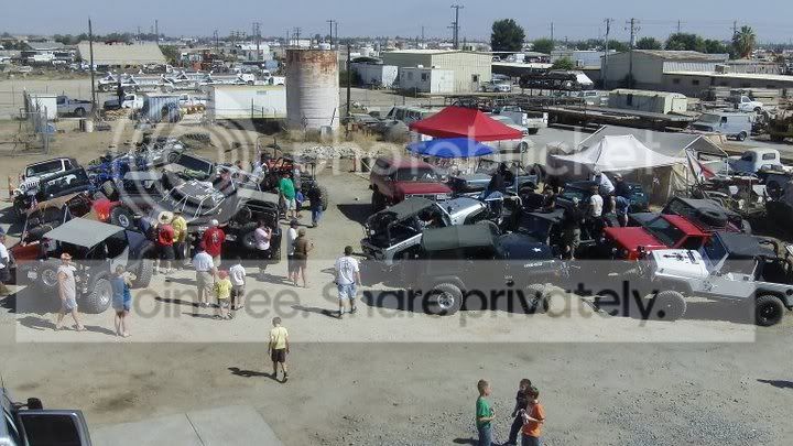

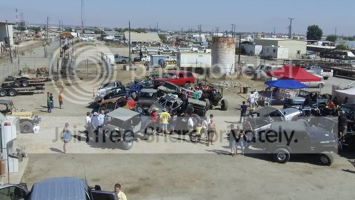

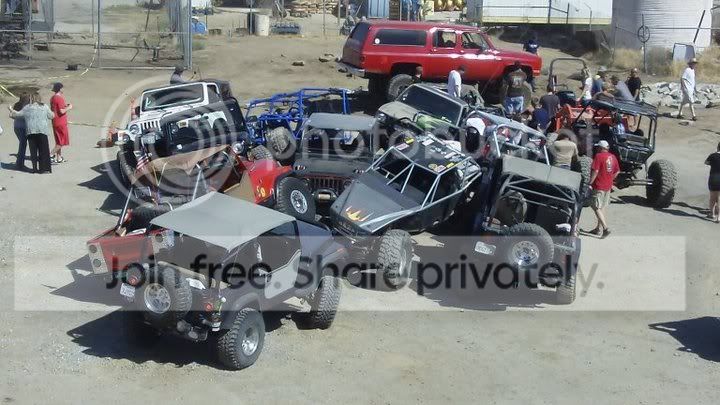

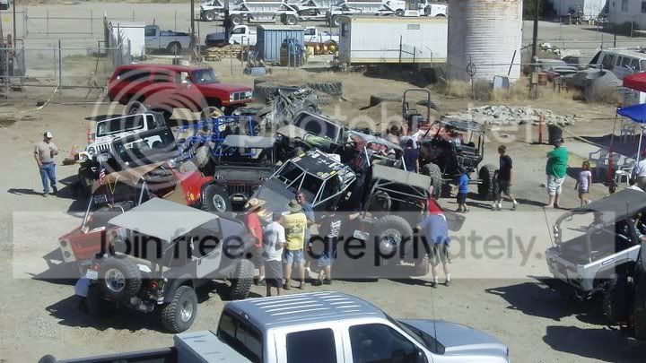

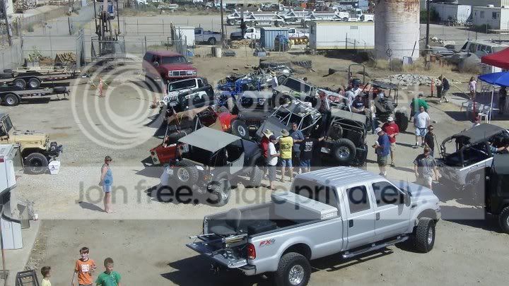

No video, but in the pics, you can see me driving in the back ground. Since the axle had been in for 2hrs., I had no time to fix the steering arm. It would not turn right at all. Everybody wanted me to get in on the jeep stackin competition that was going on. I was trying to get over to a jeep to climb on, but it wouldnt turn so well. And the minivan was in my way, So I just punch it. They said the rear bumper was on the ground. The frontend was pointing to the sky, Its was all downhill from there.
You can see in the pics where the car was before I got stuck. When I hit it It moved like 15ft. By the time i was stuck, I had moved it quite a bit.
