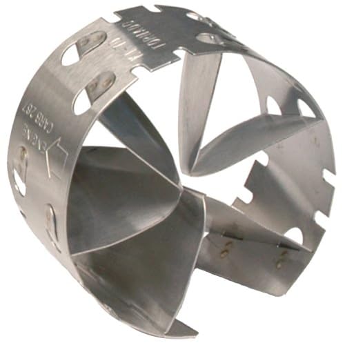

30+whp gain...So good it will make you slap your mama!:doah:
http://www.tornadoair.com/buy1/
