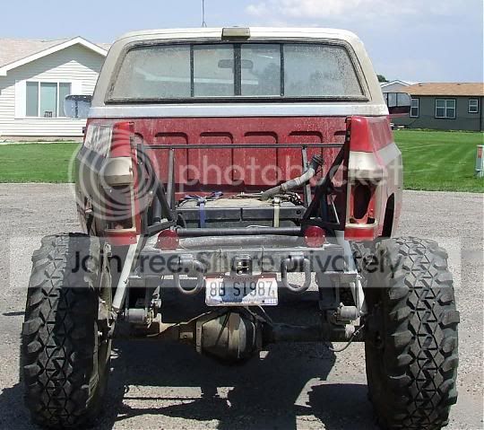

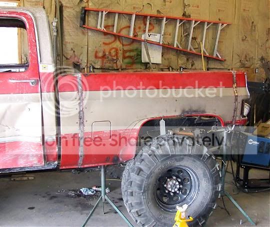

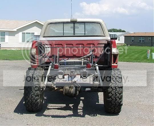

At first they were hinged and looked like this
or this
In this pic you can see how we shortened them up, the wheelbase was decided so we just made the bedsides fit
I took them off after a couple times wheeling cause I was denting them up, thought about trashing them. When took my cab off it didn't look very nice and I still had the bedsides around so on they went.
They are just tacked onto the cage right now but I plan to do some major work to them. Make them removable and stuff
Here is a pic now, I put them back on because it looked stupid without them and it looks awesome with them on. just cut where I needed too and tacked them on.
I don't think I am as likely to dent them as much as I was because I am nearly 6" narrower where they start then I was when the cab was on
