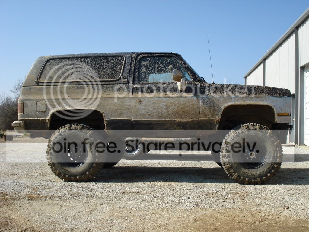

I've got a picture of what it would have looked like with the K5 body and CUCV axles!
Dont see many that color. I was really surprised to see it when I opened the thread.
Good project. I'll be keeping an eye on this one.
It may still look similar to that if the bed turns out like I am thinking. Looks like you stretched the wheelbase on yours too. Thanks for the pic. The floors in mine were just too far gone to keep the original cab. The frame was in great shape though.
