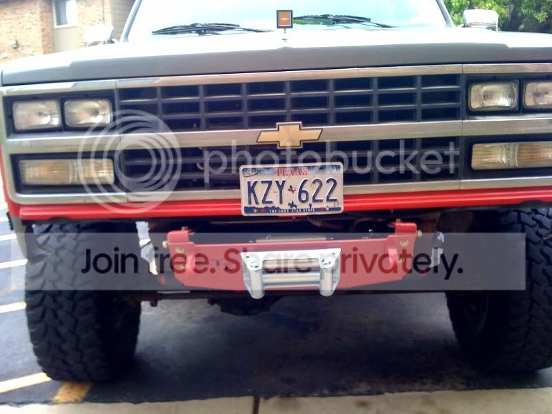

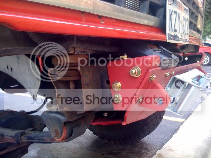

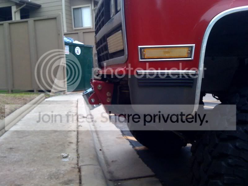

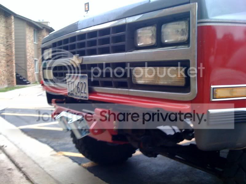

So yesterday some buds came over and they basically did 76.98322234% of the work to install my winch and winch mount/cradle/bumper thingy. The winch solenoid isn't mounted or wired up because this mount was made for a different winch. The winch I have was retarded cheap, $279 brand spanking new and I figured this would be an issue. It was also raining, so I didn't feel like messing with wiring in it. The clearance between the bottom of the radiator and the top of the winch is really tight, so I'll probably need to cut/fab/build/rig/duct tape/zip tie some way to mount it. But it's out of the living room, and on the truck.
Still need to trim the front fenders, it looks retarded with them sticking way down in front.
