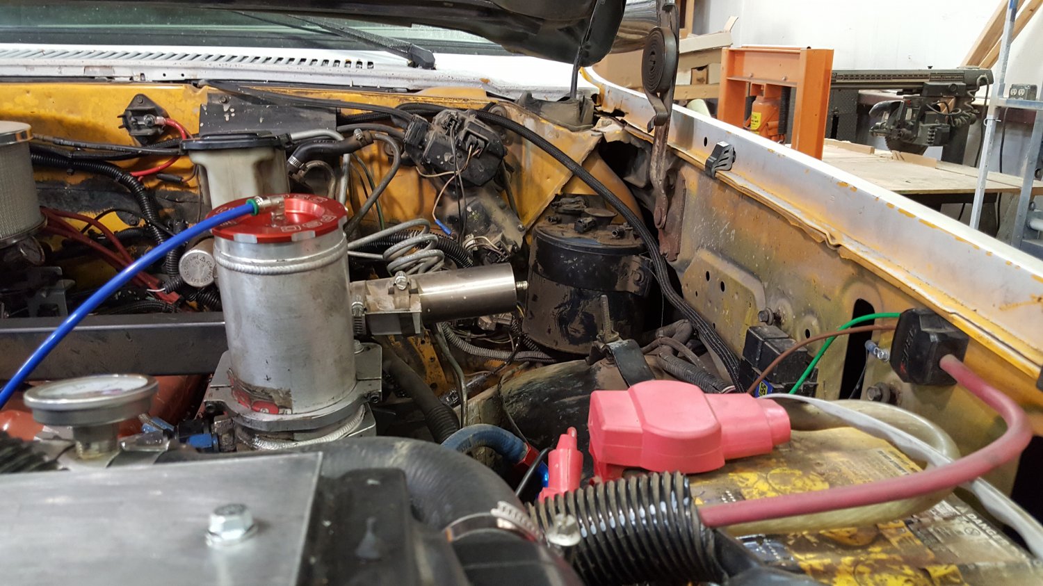

Didn't post pictures where the charcoal canister ended up back on the firewall. I still need to get a longer hose for it.
full

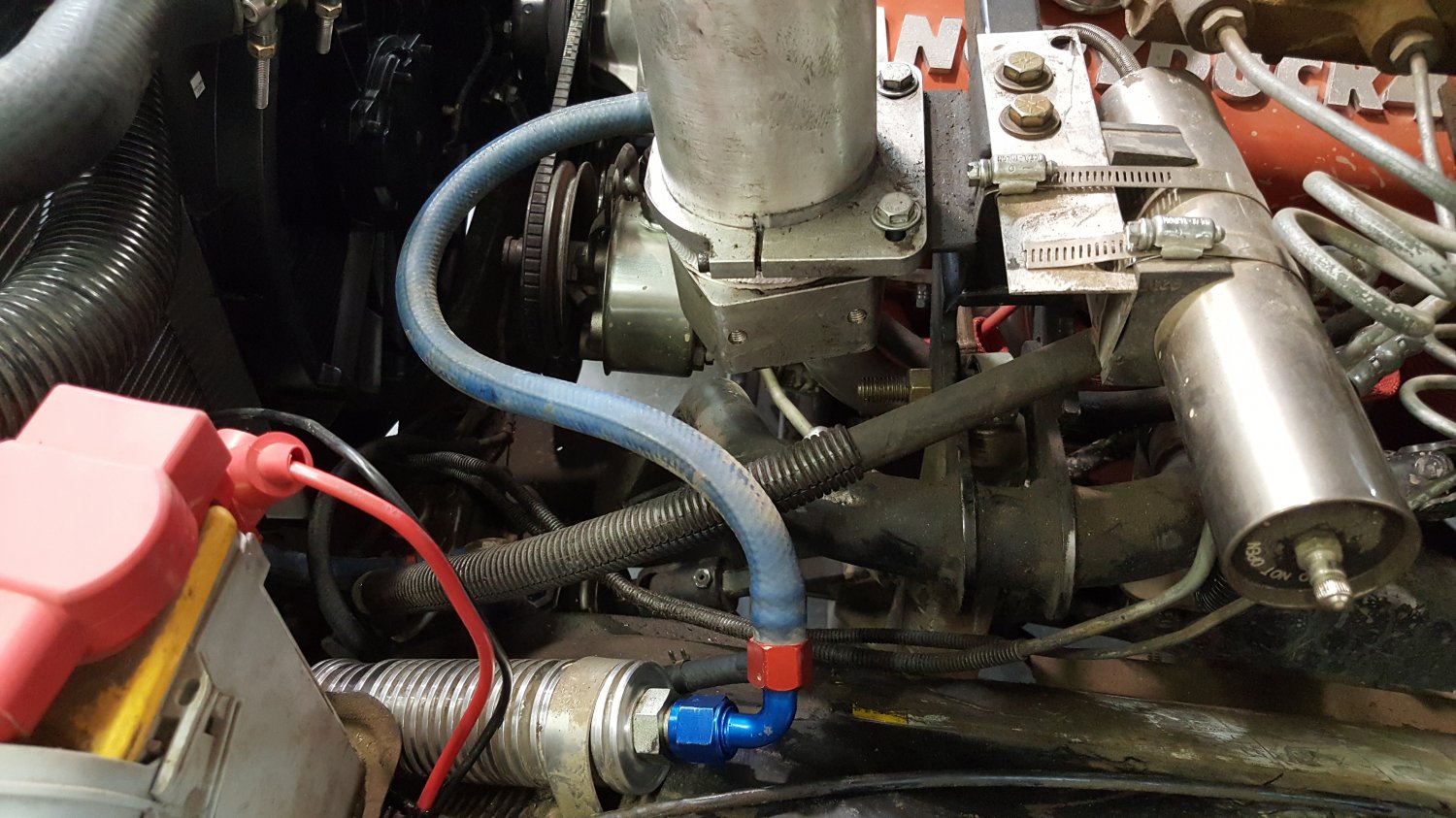

Temporary power steering cooler. Don't think it'll do much cooling here.
full
Need to figure out where I'm going to mount the cooler now.
It occurs to me will the canister even work if I don't have a vacuum like connected to it?
I would think it needs vacuum so it's pulling those fumes back into the intake. Can you tie it into the PCV hose?
Just been doing some reading and it should have a vacuum line connected to a ported vacuum source. I could run a line to the ported vacuum port on the Sniper. I may look for a canister from a late 70s truck because they have fewer ports. Hell I didn't even realize they are serviceable items.
I do too. When I have the 66 in the shop everyone complains about the gas fumes.
I was looking closer at mine and it just has 1 extra fitting for the PCV so I'll just cap that and run a hose to the ported vac port on the Sniper and call it good.
