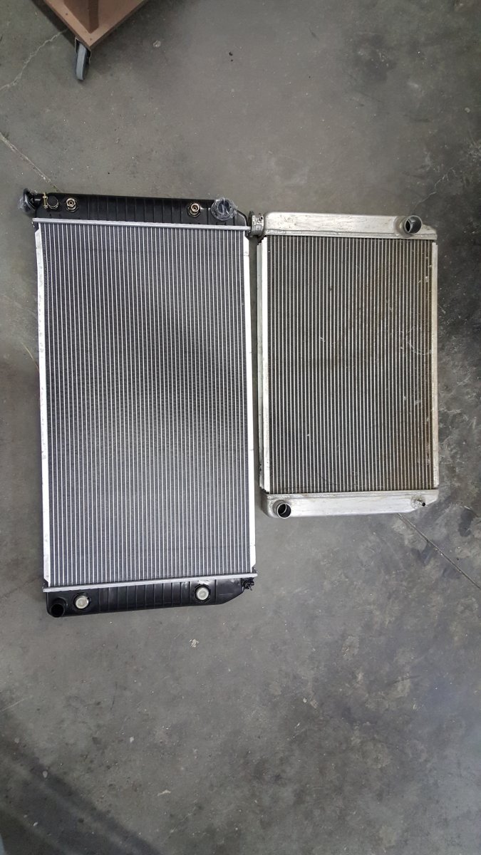

Finally got the bigger radiator installed. The radiator I ended up with is for a 94-00 Chevy/GMC truck with a 454. It measures nearly identical to a 6.2L radiator, but not as expensive. I ordered the top and bottom radiator hoses for the same application. The bottom hose was perfect but the top hose needed a different thermostat housing so I had to improvise. The brackets and isolators for the 6.2L application worked perfect.
These radiators are HUGE. Comparison with the Griffin radiator I had been running.

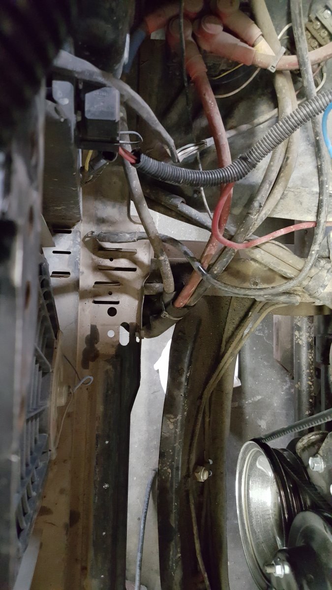

2 things to see in the picture below. First my power steering cooler lines are in the way of the new radiator as well as the charcoal canister. The other thing to see is where the isolator goes on this side.
full
If you look down below the power steering cooler lines you can see where the isolator goes for a standard radiator. It's hard to see the location for the diesel radiator but it's kinda below the bolt the holds clamp for the charcoal canister. Essentially the new radiator is 6" wider than standard.

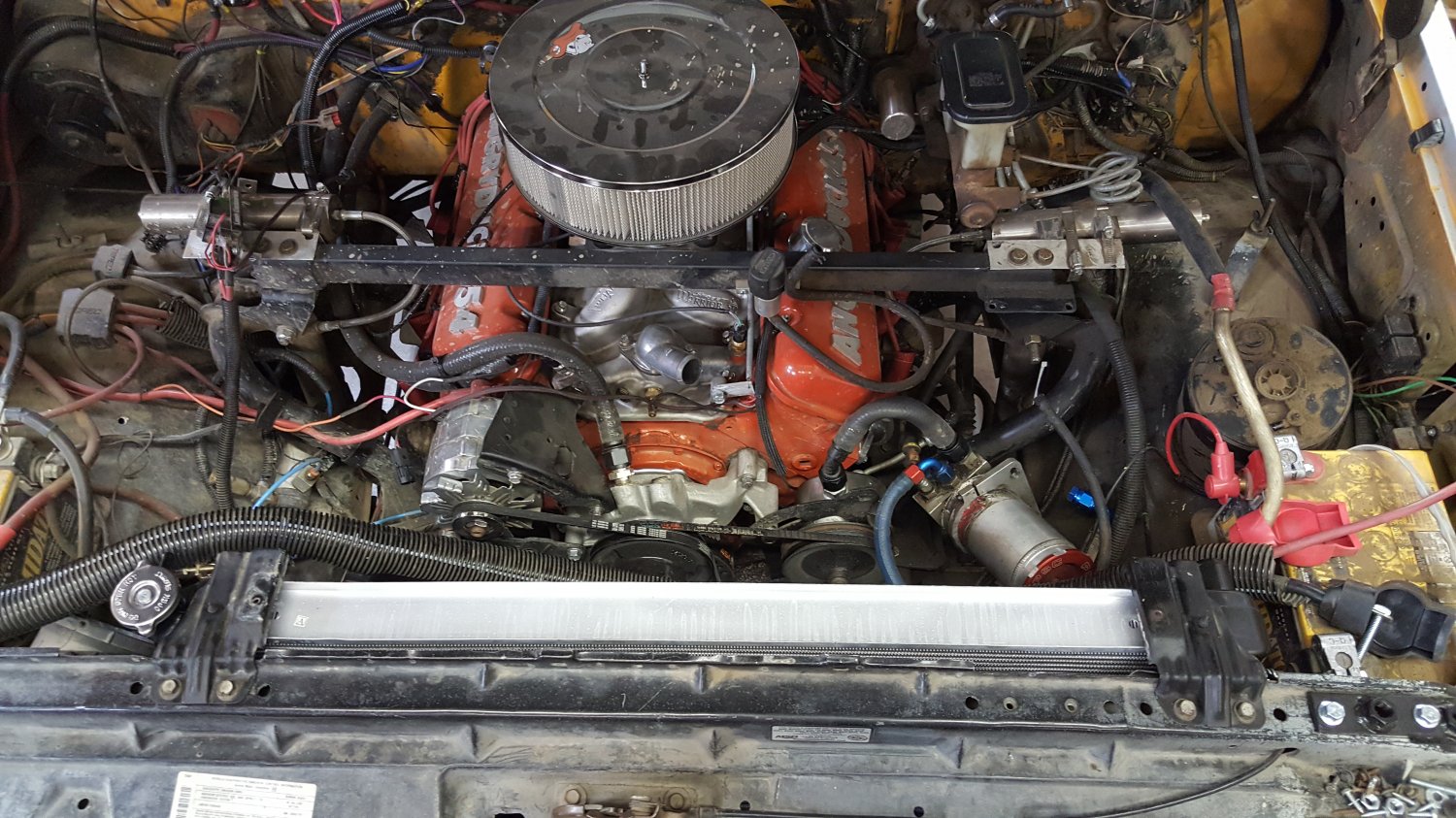

Here it is installed.
full

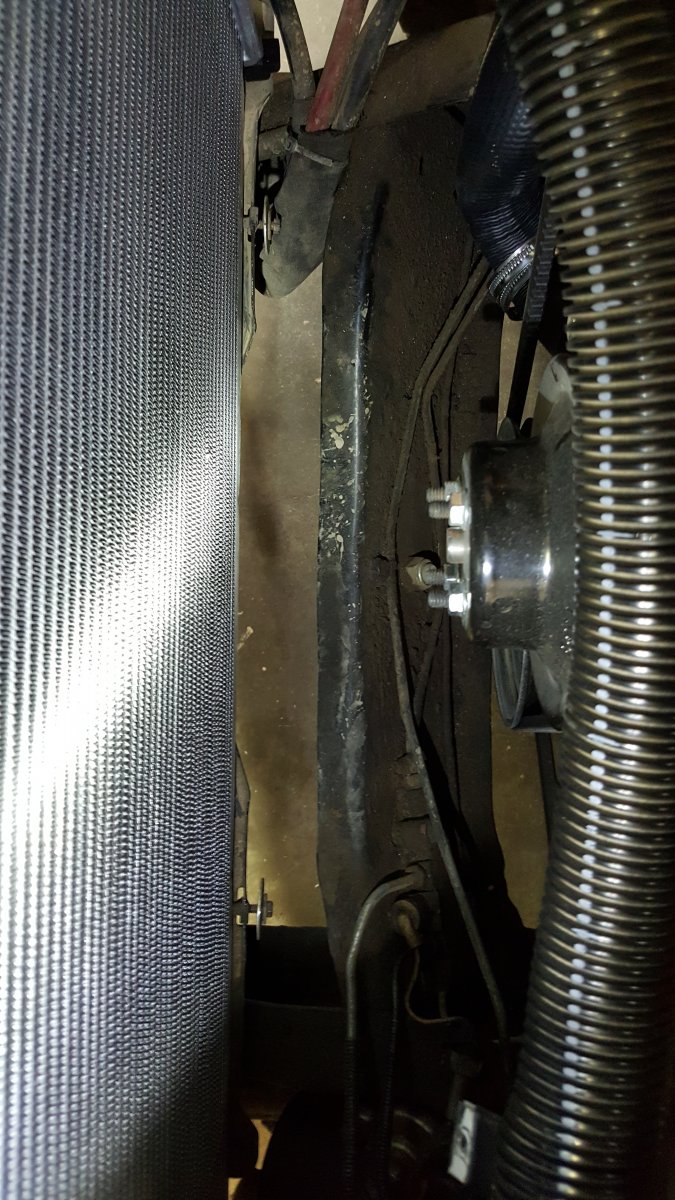

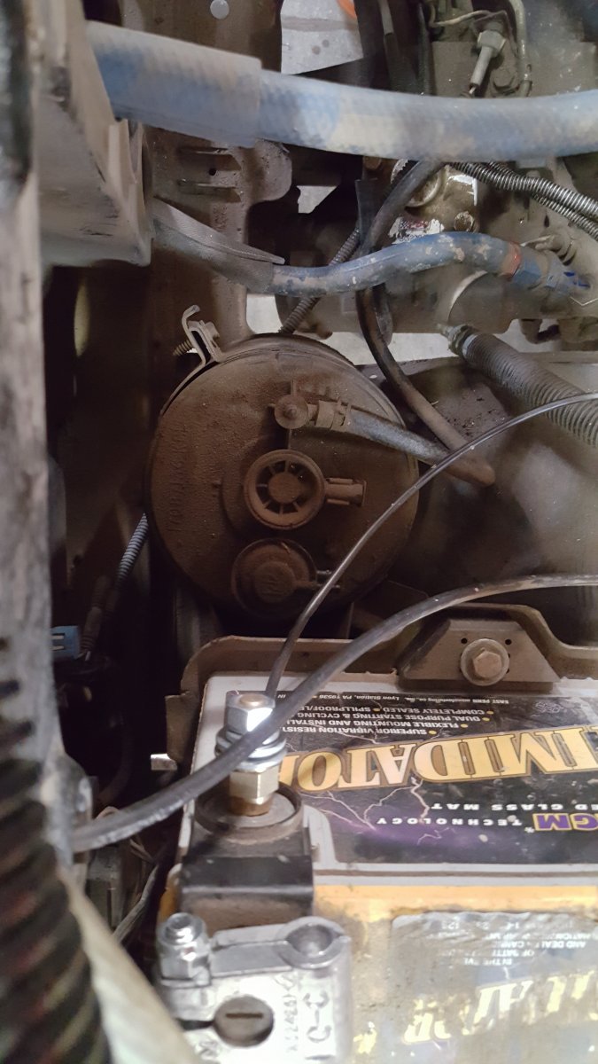

Gets pretty close the driver side battery.
full

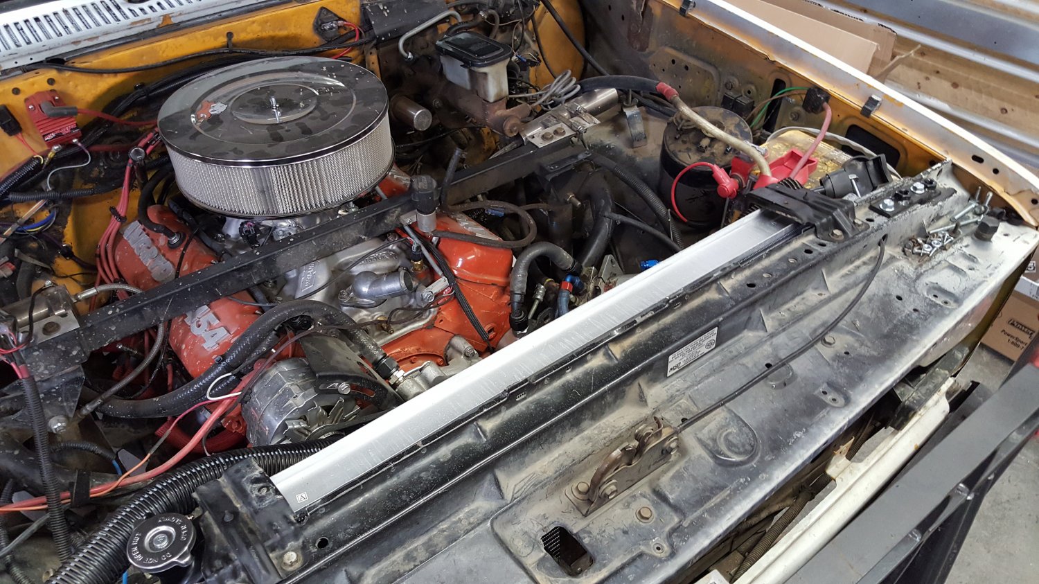

Possible problem is a big gap between the core support and radiator. This could be a place for air to escape without going thru the radiator.
full

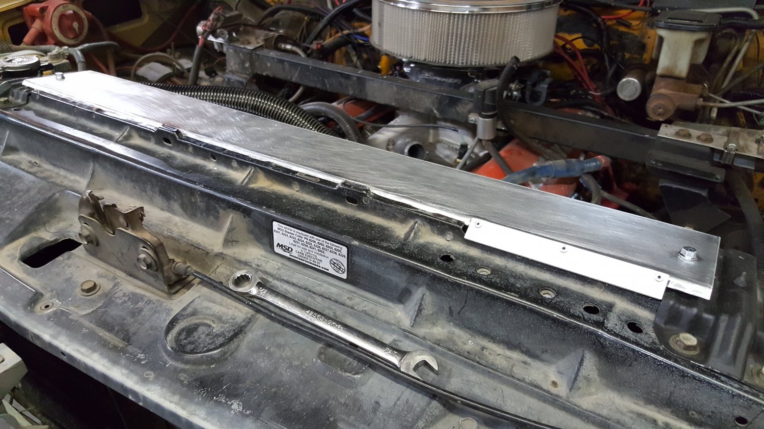

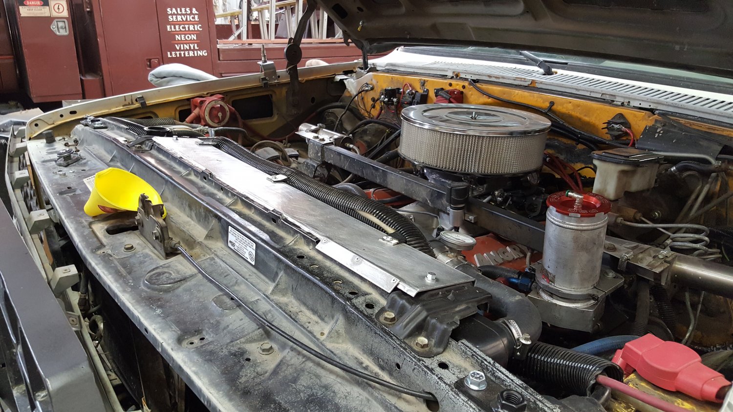

I didn't buy the factory cover when I bought the brackets because it was going to require a big box. So I bent one out of 080 aluminum.
full

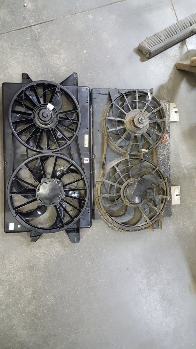

I ultimately decided to stick with the Windstar fans. If you looked way back in the thread you'd see I had butchered the fans to fit the Griffin radiator. I purchased a new set for the 99-03 Windstars; the old set was for a 95-98.
full

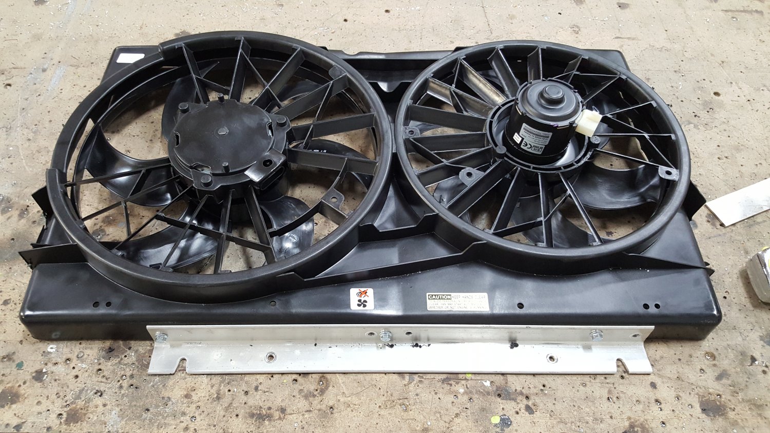

I used the bottom factory fan shroud bolts to hold the bottom of the fans.
full
I bolted a piece of aluminum angle to the bottom of the fans with slots for the bolts picture above.
full

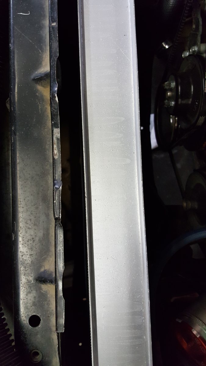

I did have to add a spacer because I didn't want the fans to touch the radiator. You can see the spacer I added, it's the white strip with writing on it.
full
About an 1/8" gap on the top and 1/4" on the bottom.

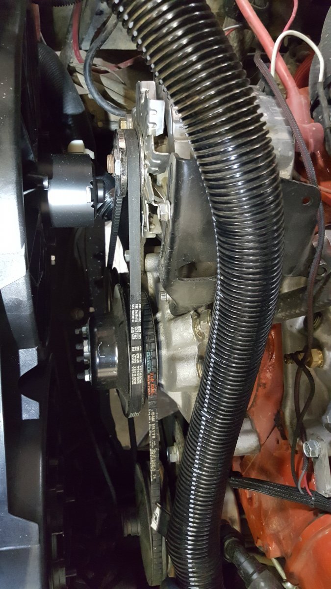

There isn't a ton of room between the motor for the smaller fan and the alternator.
full

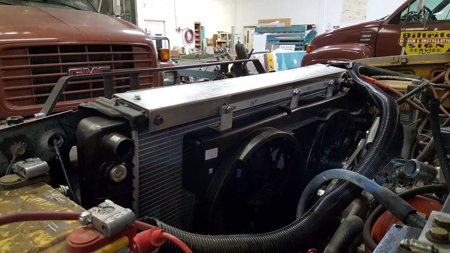

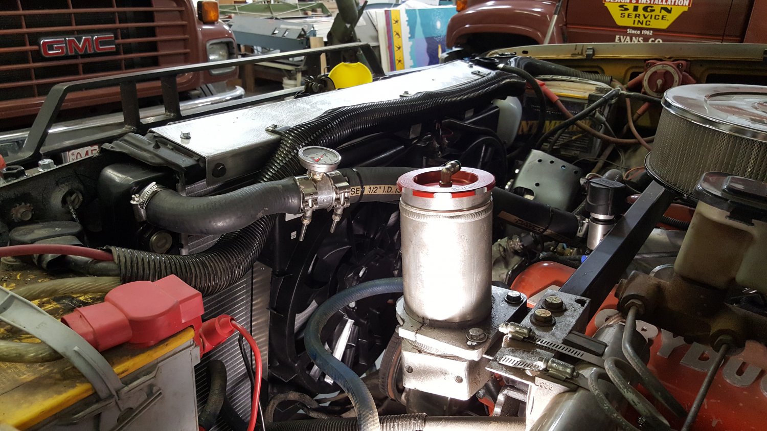

Here's pictures of the finished install.
full
full
full

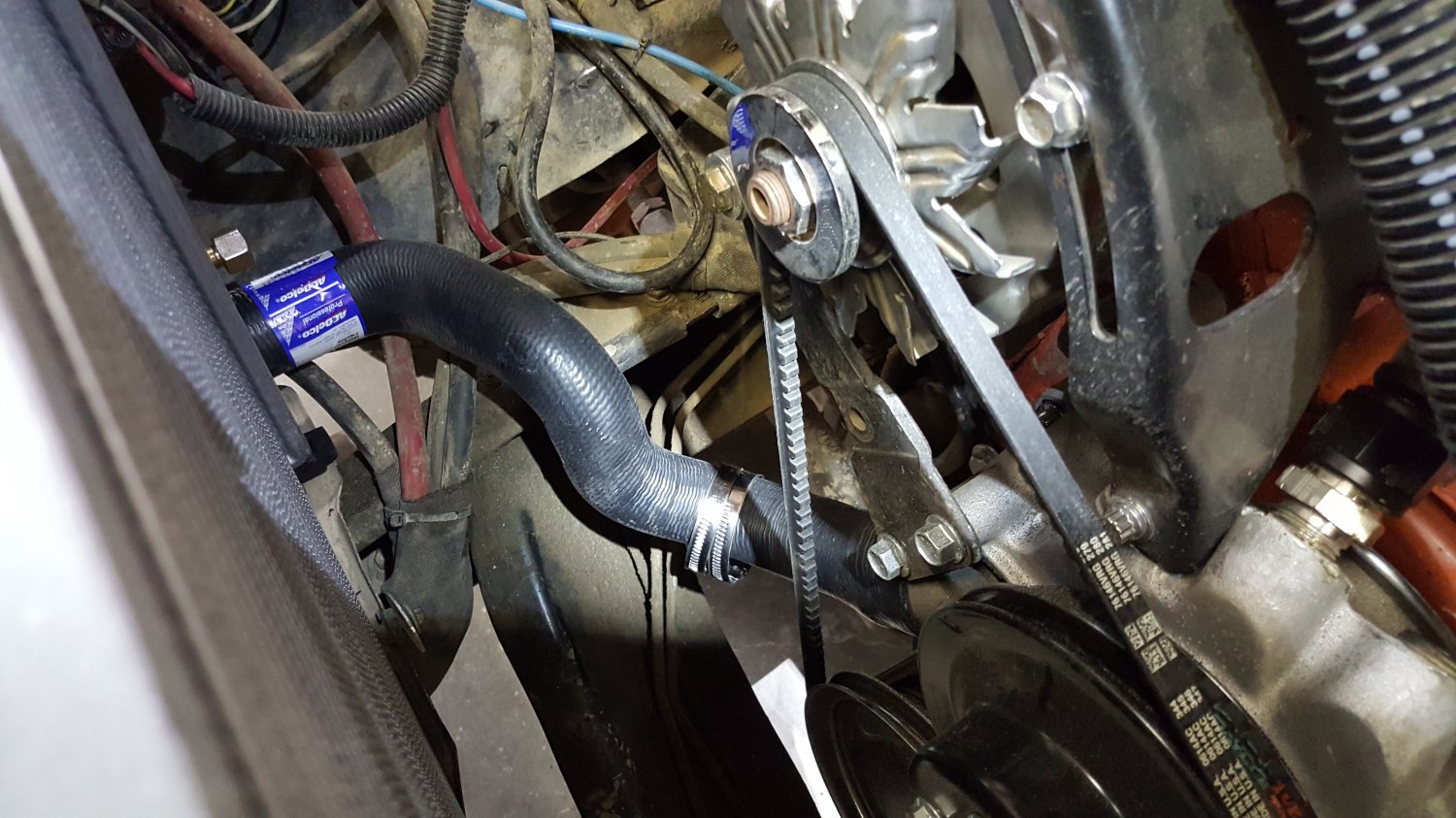

For the top hose I was able to use a piece of the application specific hose and the hose I was using before.

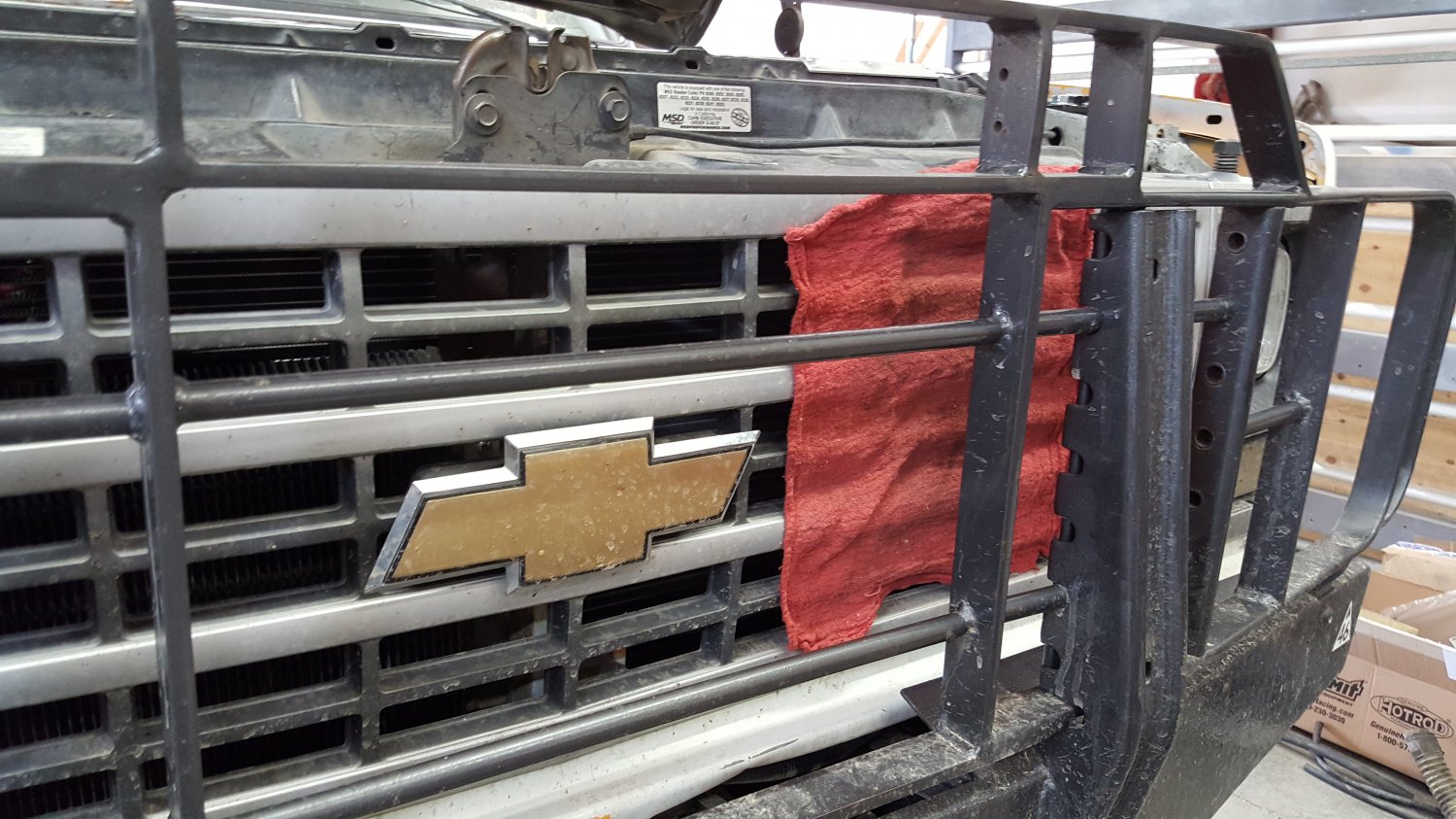

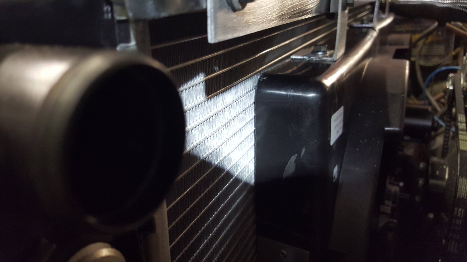

This demonstration of the suction of the largest Windstar fan really impressed me.
full

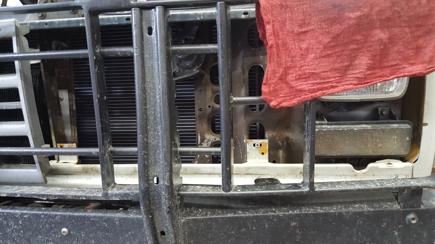

The radiator has to be nearly 6" from the grill. I'm impressed it could pull that far through the radiator and hold the rag on the grill that has pretty large openings.
