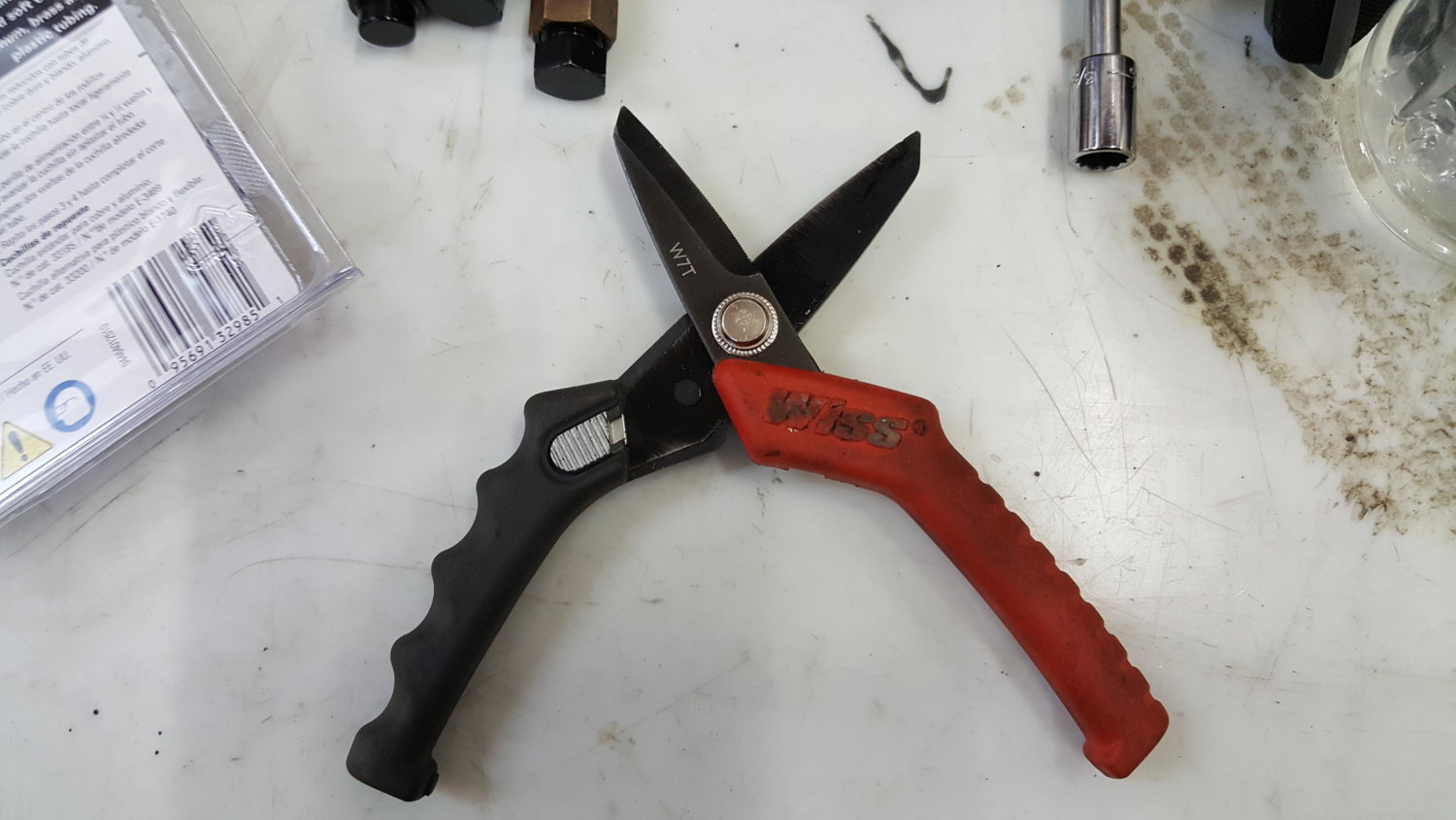

By the way, I bought these to cut carpet last year and they are awesome. I use them a lot to cut lots of things. The limit I've found so far is stainless braided house. They did cut nylon braided.

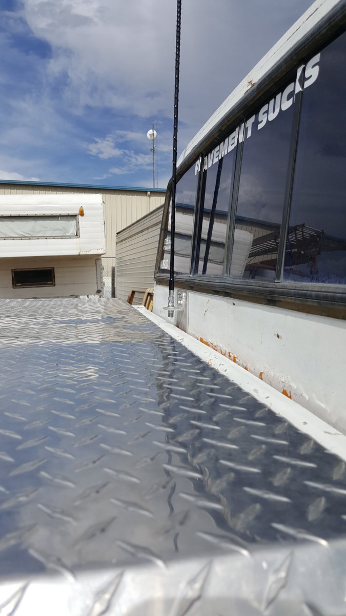

Trying out a new antenna location inspired by @bent72
full
You will note I added a piece of aluminum behind my bracket. This is because the sheet metal there isn't very rigid. Plus I used my favorite rivet nuts and the flange on those raised the bracket away from the flat surface so the load isn't spread out as well. You will also note I cannot get the cable on the standard stud so I'm waiting on Firestik's firering type cable that comes off the base at a 90 to the side.
Guess we'll see how yours works. Mine still catches trees.
Oh it will hit tress for sure. I was thinking I will quickly find out how durable the Firestik is. :wink1: Good thing is it beats against the rubber weatherstrip around the window. I'm trying to get away with a 5' whip because that meets their guideline of blocking no more than 1/3 of the antenna.
The antenna does bend, I was pulling it back pretty far to see how much. That's when I figured out the sheet metal there is flimsy.
I will see how it works Sunday and decide if I may want to try a 4' whip and a spring base.
Could a foldable mount work somehow? Like lay it down for the trails? I imagine it would still work layed over just not as long of range.
I was gonna say they make a pretty stiff spring mount that stays up pretty vertical until it needs to bend. It's not all floppy like a typical spring mount.
They do have a heavy duty spring that is supposed to not move much. Key is to get the heavy duty version. Nice thing is the antenna will smacking the rubber weatherstrip around the rear window.
I thought about the quick disconnect but the trail is when I really need it. I know I would be too lazy to get out and remove it or put it back as needed.
Interesting idea would be something on a hinged plate that was heavy enough to stay upright under normal conditions but would fall over with extreme pressure. Not sure I could come up with something practical tho.
