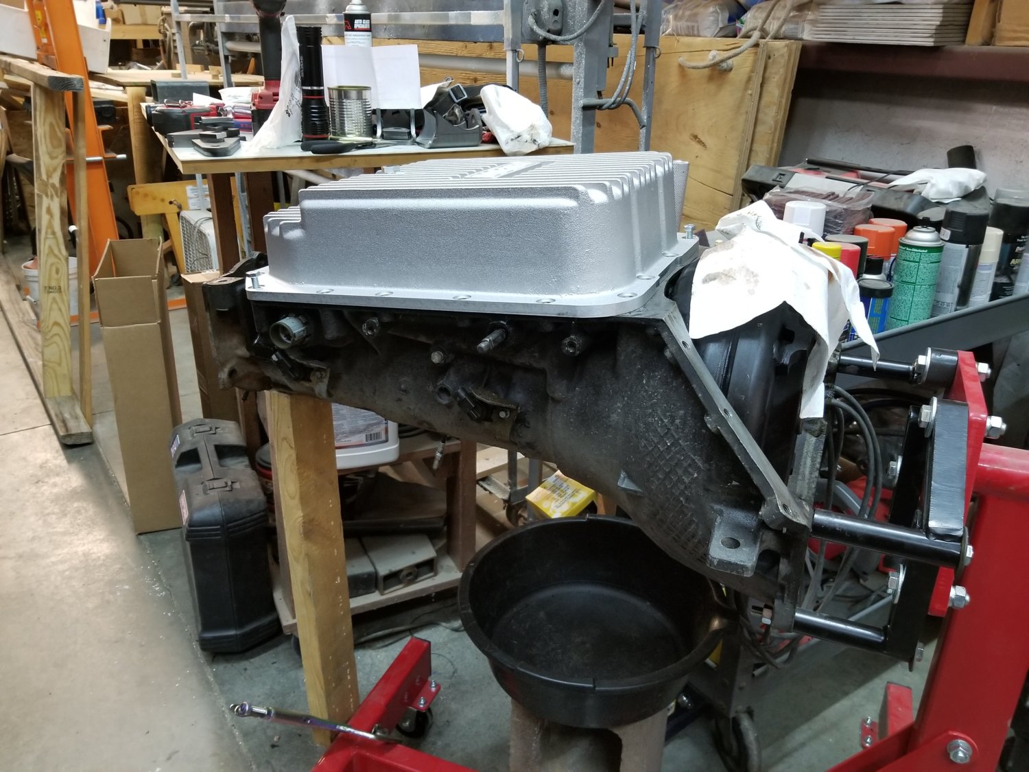

also hang them up and let them bleed out the tail like any dead animal works if you can . I have done this a few times with a engine hoist .
many people make the mistake of using NPT for those cooler fittings causing a cracked case. Imagine that ofukmylife moment.....lol
As I was threading them in thinking "what if they sent me tapered fittings by mistake". Or I ordered the wrong thing. :screwy:

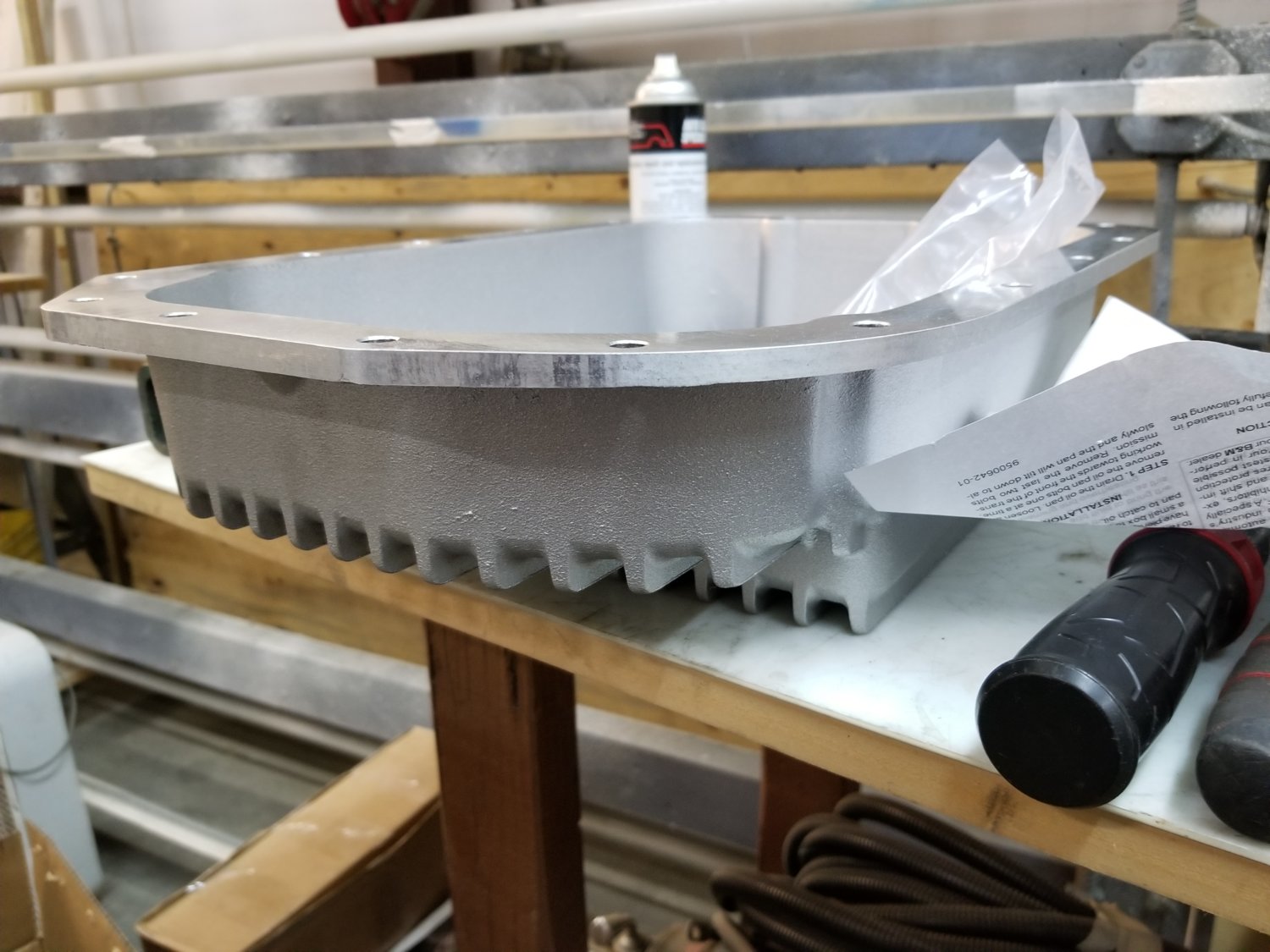

B&M deep pan is freakin huge!

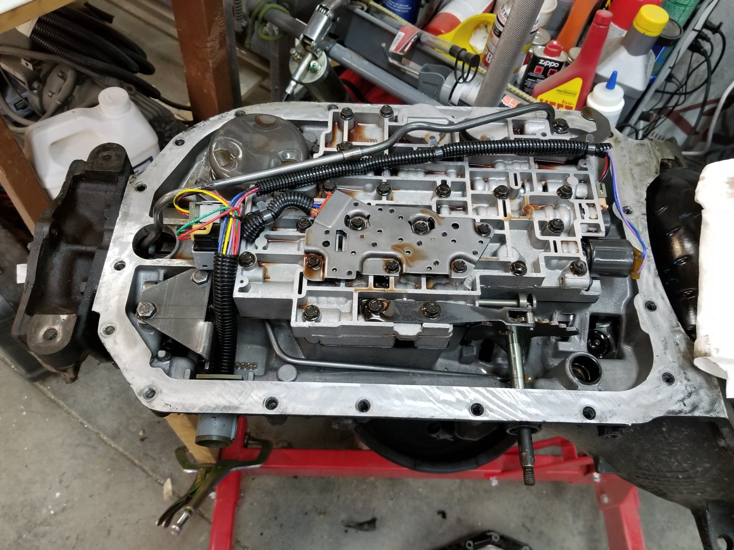

This is the inside of the trans FWIW.

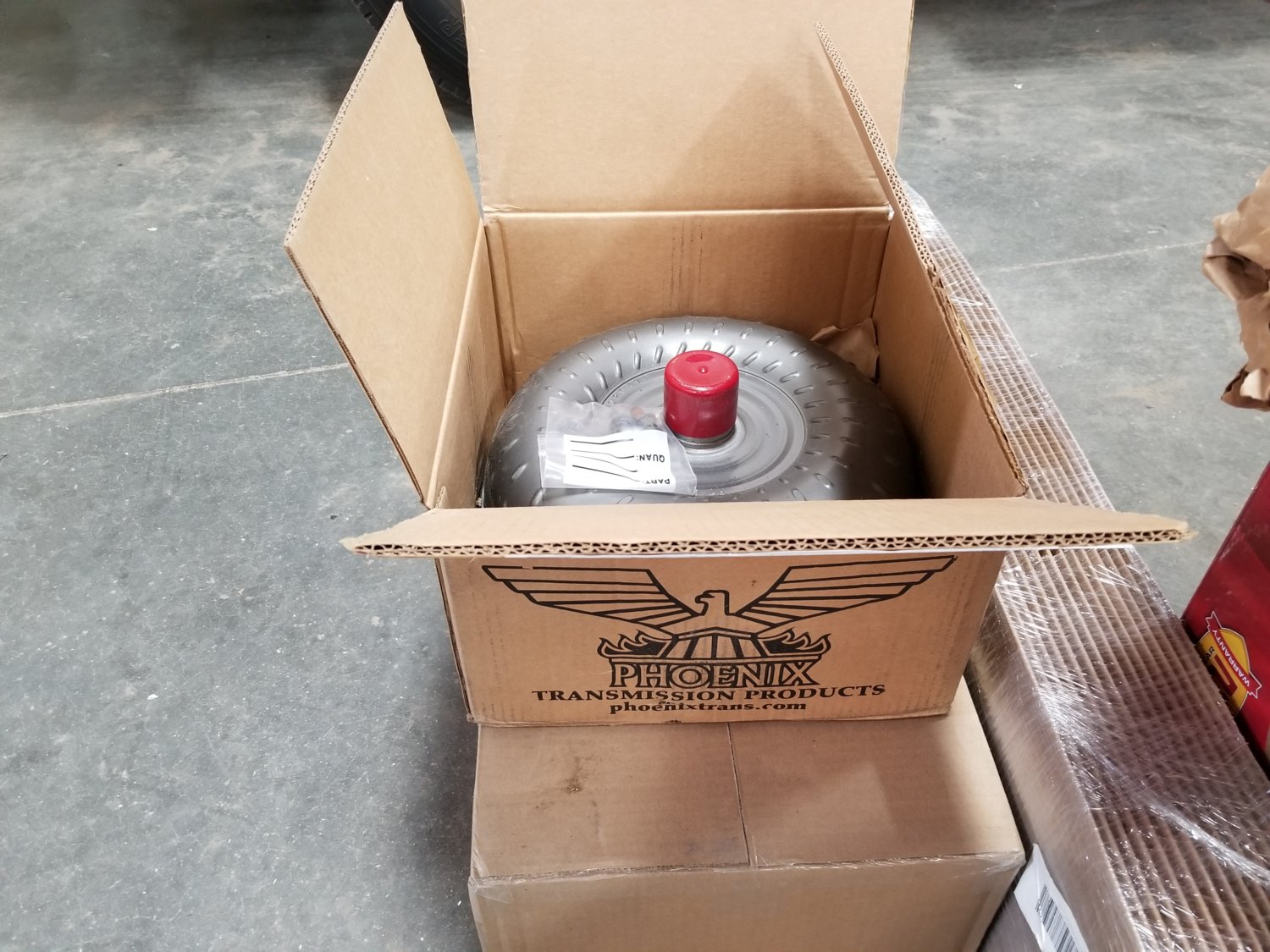

And I received a package from @Greg Ducato today!

I would do a shift kit!!!!!!
I haven't experienced one in an 80, but there is a nice difference in a 4L60E. And I have liked the performance in the 700R4, TH350 and 400....
Others may have more informed opinions, but I feel like a 4L80 in our kind of applications doesn’t need a shift kit. I’ve only installed, programmed, and run one, but it’s a late style stock rebuild and has performed extremely well over the last 15k miles.
If you’re running a standalone controller (TCM2000 or similar) many of the shift timing (load vs speed) and firmness (pressure/gear) parameters can be dialed in from the laptop.
David
Okay that is what I was thinking @AgDieseler and @Smokinthehippies because I will have a stand alone controller. Only thing I thought a kit might do is some sort of flow improvement.
I also have that "if it ain't broke...." mindset that is telling me to leave it alone.
I'd paint the shit out of it with hugger orange paint, throw the cheapest B&M shift kit in it you can find at Auto Zone. Then I'd buy a 30 pack of PBR and do donuts in my grass.
I thought about all of that, but I realized I don't have a yard, so I didn't do it. Haha
I did not put a kit in mine. This is memory from about 5 years ago but I'm running a small (maybe 10%) line pressure increase. Personally I would not want any firmer shifts. In low and low-low the shifting is nice during crawling and if I get on it in low/low-low it is way more than adequate.
