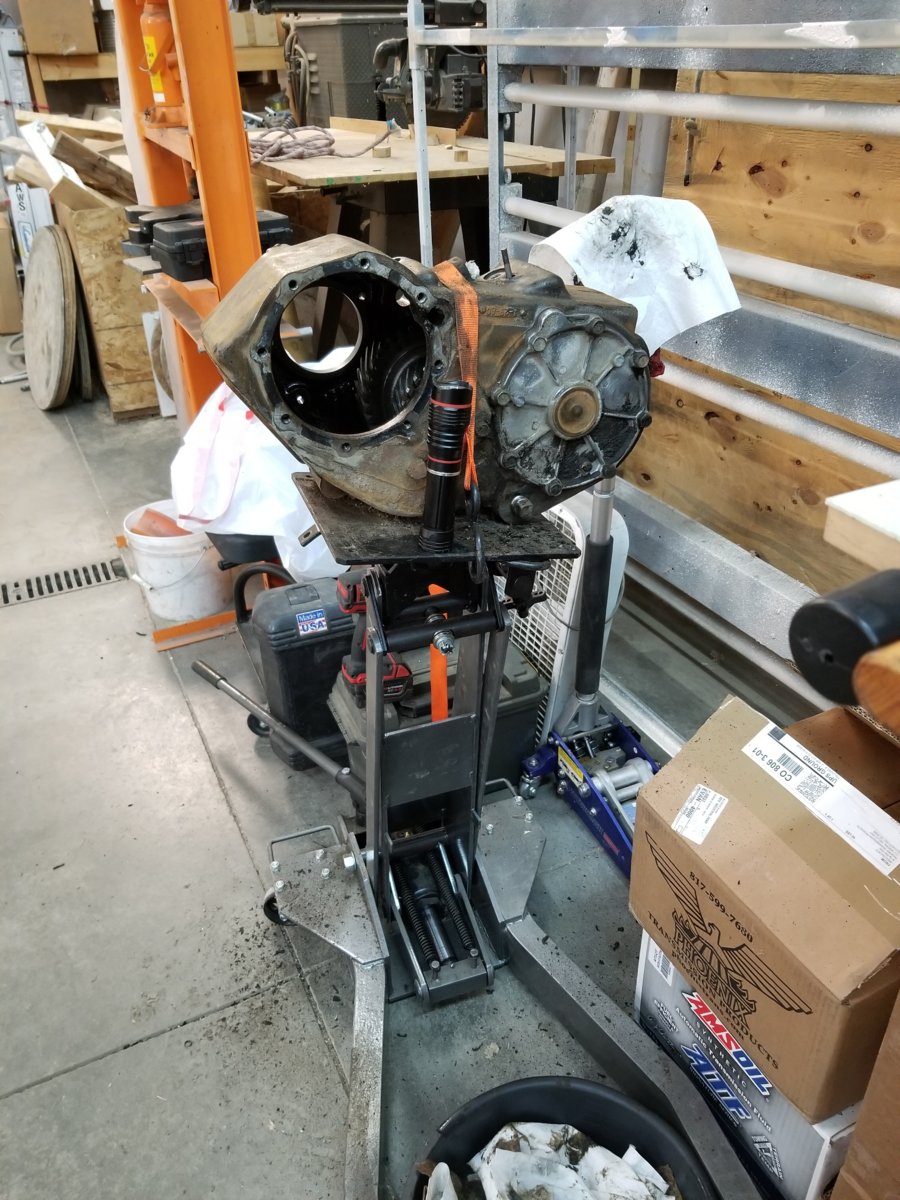

Forgot to post some pictures. Found another use for the trans jack. Makes a good little work bench for the NP205.

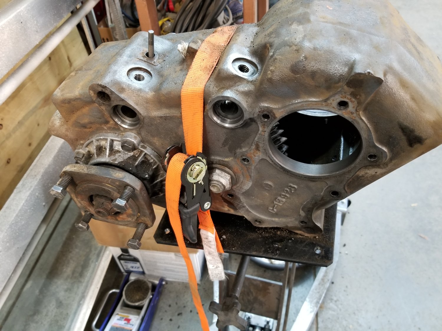

Got the guts pulled for the Magnum input shaft and twin-stick shifter rails.

I also found the tag for the '80 NP205. It was built in early '80. The tcase I'm pulling the fixed yoke from was in a '79 but the tag says it was built in '78. So the 2 aren't as close in age as I thought they might be.

Yes. Got it for my birthday earlier this year. Works great for dropping fuel tanks too.
Kinda surprising when you think about how high it lifts. That's at a comfortable waist high working height. Might be a little low for tall freaks like @skunked I suppose. But that would lift a trans into a pretty tall truck.
It does settle 3 or 4 inches overnight but it didn't go any further over the past 4 day weekend.
I actually went to buy the 800lb model but they were sold out, that one reaches 24" high which is enough for my truck on 40's. The 2000lb model is 32" IIRC.
I’m debating on that one or the heavy duty one for my 2 post lift. The cheesy trans lift I have now for the 2 post is sketchy as hell getting it up any higher than my chest.
Did you bleed the trans lift? My car jacks did that until I bled them.
