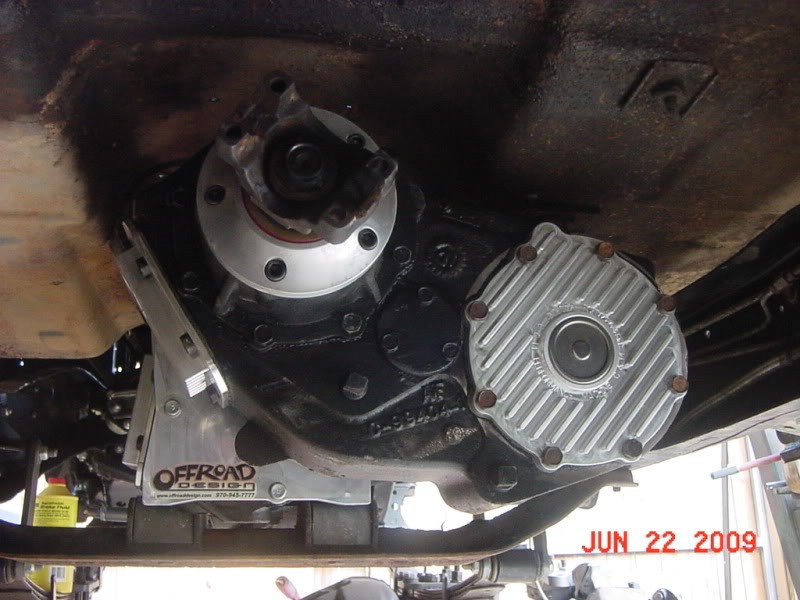

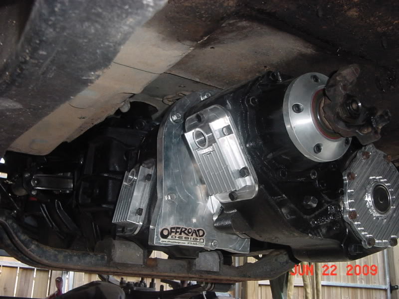

No, mine is a Blazer with a Doubler so no deep frame or good points of reference to compare to your set up. Here are a couple of pics of mine, if nothing else it'll help show the PTO opening / fill plug comparison.
full
full
Honestly, now that I'm looking at my old pics I think I may have filled it through the hole in the PTO cover rather than through the opening in the case (prior to installing the cover).
Oh yeah, now I can see it. Looks totally different in the truck compared to sitting flat on the bench. I can see the PTO cover is much higher than I was thinking.
Your pictures are not helping me resist the temptation to add some aluminum bling to my case. :p
tap the PTO cover for a fill plug or buy one of Kert's
and I don't think you'll need to be clocked all that much with the taller/flatter frame.
