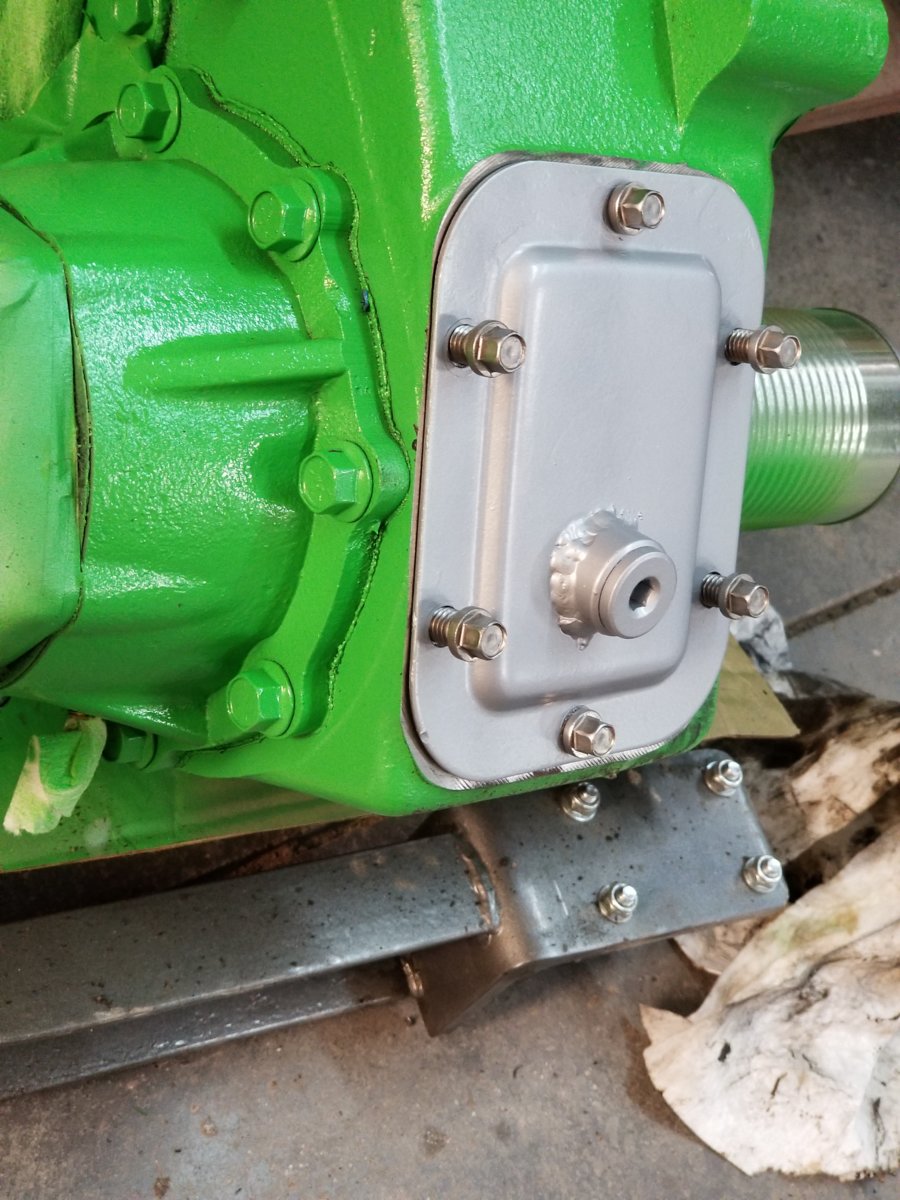

Added fill hole.
full
Used an O2 bung like @Justin V recommended. Got the bung and the plug as a kit from Amazon. Just need to throw an oring under the plug.
Thanks Scott but credit for the BUNG goes somewhere else. I only knew the thread pitch .
I do like the execution though. I've only seen plugs with raised hex heads, not allen keys...
