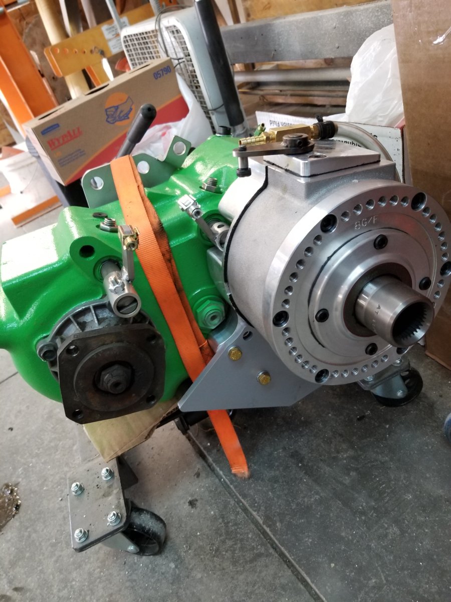

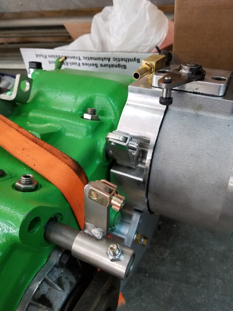

I moved the Magnum shift lever. These images should help clarify and alleviate concerns.
full
full
Yeah, to be honest, I have gone away from the thought that clocking flatter is better. I think it's way easier to keep the t-case in a relatively closer position to stock, and then just build a beefier skid plate to handle bashing. Sure your "ground clearance" is a bit less, but I think its way easier to deal with then the problems that occur with clocking flat (floor clearance, d-shaft angles, fluid levels, etc). I guess that's easy to say when you are running 42"+ tires though :D.
It always amazes me how much less the diff hits rocks with 40's vs 37's.
Also you can see in the photos the Magnum has numerous clocking positions available.

A pic with JB fab's shifter bracket for the Magnum on there too would be beneficial. Cause all I know with my Titan box, is that if the shifter was located at the top of the case like that, it would be a real tight squeeze with it and the floor (On my titan box, my shifter is on the driver side of it...pic below shows it...kinda).
Ah, I totally get it now...very different than my setup. Now that I see how it works...you should be totally fine then. As you can see from my pic below, I have a bracket that bolts to the side of the titan box for the shifter, I was thinking JB Fab's was something similar to that. But I like the way his setup will work for the Magnum (BTW...the pic below was when I was adjusting the detents...so technically it wasn't on a bench, but more like the floor :rotfl:)
