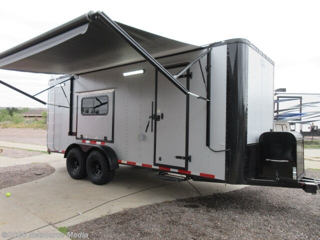

These are cool but not cheap. https://www.coloradotrailersinc.com/trailers-off-road
