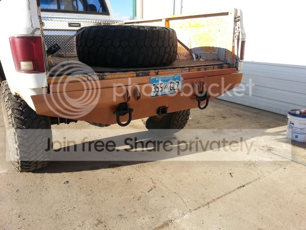

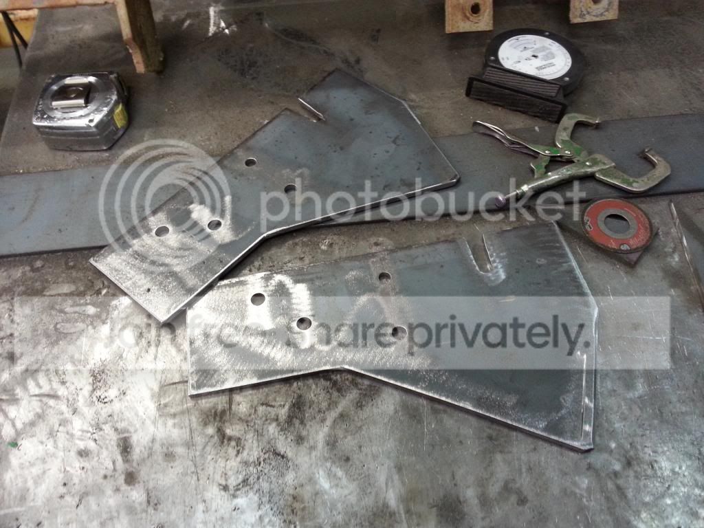

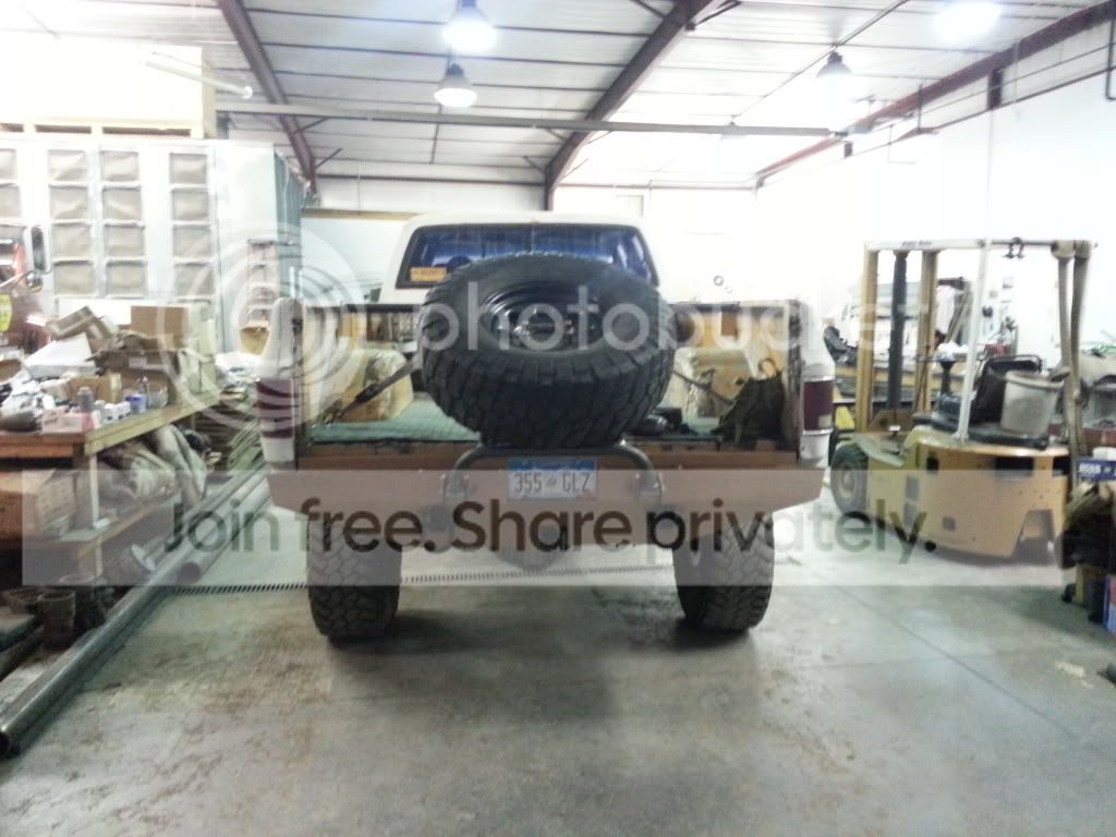

I've been working on a rear bumper. While we were in Moab we got pulled over for not have a license plate light, rear bumper, or mud flaps. Luckily we didn't get a ticket, just a stern warning but I figured it was a good sign to get working on the rear bumper.
I didn't get many pictures. I worked on it during my lunch hour over the past few weeks. I thought it would be easier to use the rear bumper from the K5. It was pretty simple design, so I thought it would make a good starting point.
All of the brackets had to be cut off the K5 bumper along with the welded in receiver tube. I made a couple of brackets to bolt it the crew cab frame along with additional pieces.
The idea behind the bumper was to be tucked in tight. In Moab I never had trouble with the receiver hitting, even with the shackle holder in the receiver. I had modified the receiver hitch that was on the truck when I bought it so that it was higher and further back under the truck. So I knew if I could get the bumper to line up with the receiver, it would be good.
Here's the final result:
I used the brush-on Rustoleum hammered paint. I picked copper because it's not a color I've seen used before. I'm not certain I'm going to stick with it. It looks a little too art deco I think. I also had a little trouble because the paint was 60° to paint and it wasn't much warmer than that in the shop when I painted. There were some runs and places where the paint kinda sloughed down.
From here it just looks like an off color of the red oxide primer. Looks good tho!
Thanks. That's the comment from a few. Kinda rust colored.

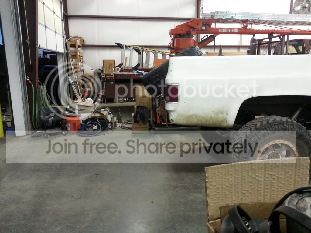

Looks really low? You said the receiver never hit though.
Martin
Yeah. I thought we'd be slamming the receiver the entire weekend in moab, but never did. I was thinking about it a lot while it coming together. Ultimately I decided worst case I would pull it off and cut it down if needed. I also think the lack of a tailgate makes the bumper look big. I kept thinking it was big but it's shorter than the front bumper.
You planning a swing down tire carrier? Just noticed the 4 tabs above the clevises. Maybe built in steps to get up in the back of the truck.
Shhh, no spoilers! :p
I read that last part like you were putting a spoiler on the tabs. :haha:
SRT10 wing weeeeeeeeeee. :haha:
No tailgate?
Have you braced the bedsides? Bedsides will get floppy with enough abuse.
Not yet but I will. One of those lessons I learned from the K5. The bedsides got messed up on that truck even with a tailgate. Made it hard to operate the tailgate and rear window.
I have a lot of plans for the bed of this truck. :D

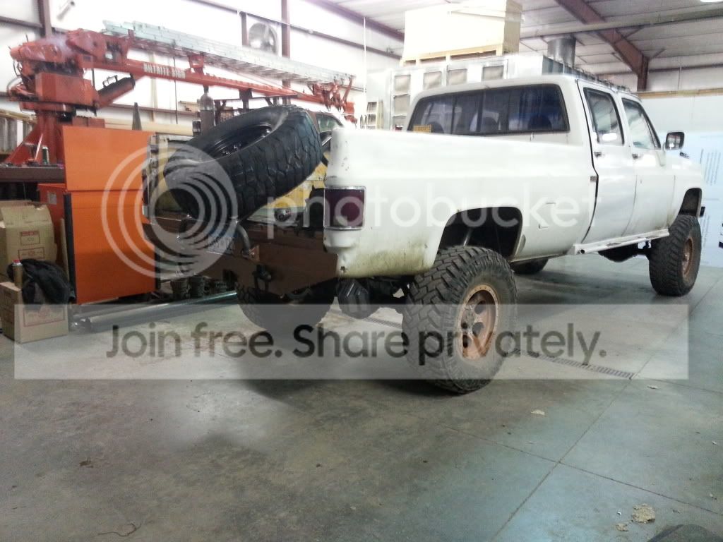

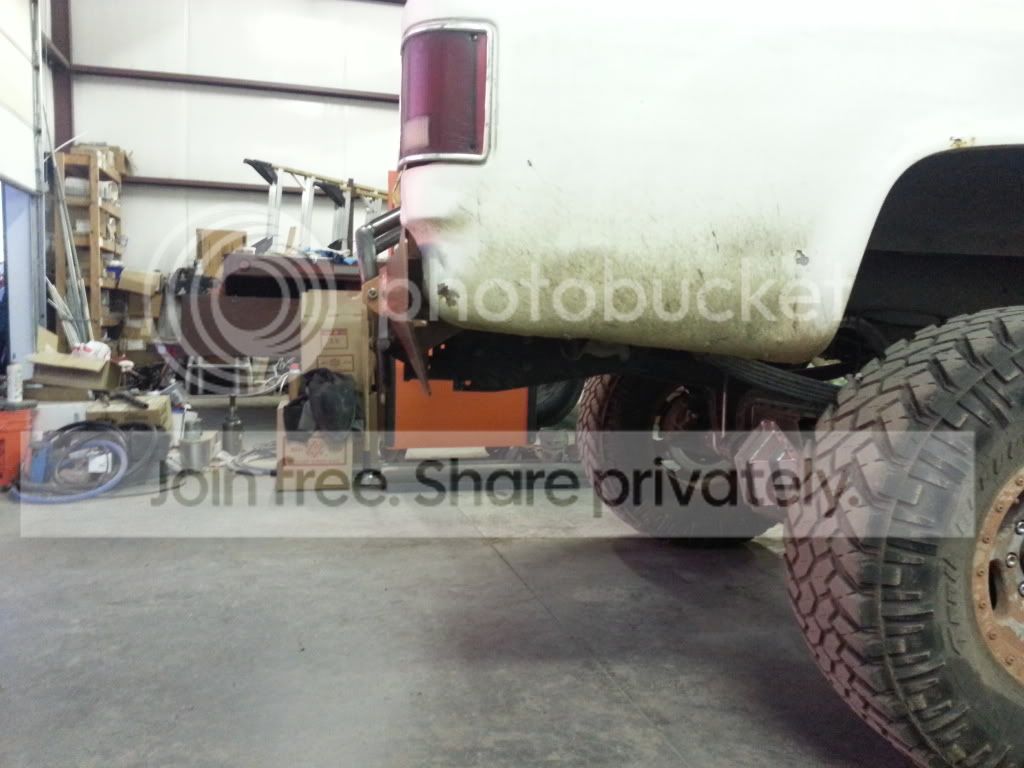

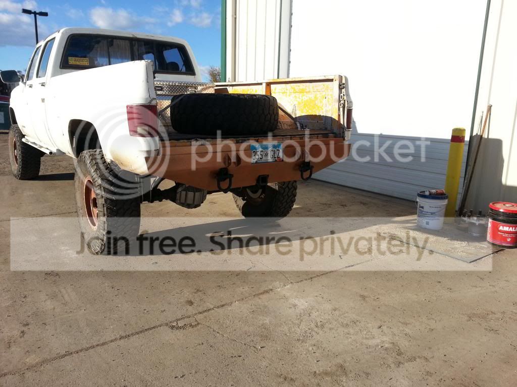

Here's a side shot of the rear bumper that shows the clearance a little better maybe.
Down the road there will be a slider mounted behind the tire that will nest in a little tighter to the bumper.
Got the spare tire carrier mounted on the bumper.
I'm waiting on the latch to arrive before it will be complete.

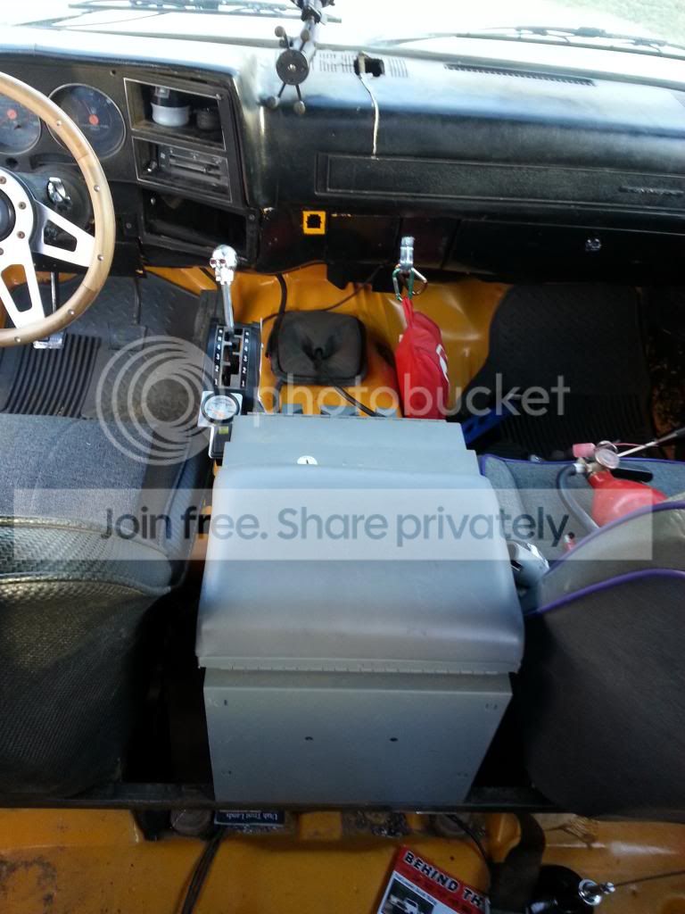

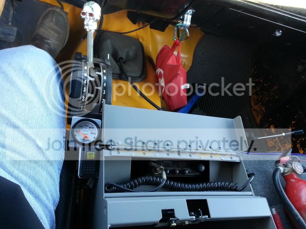

Awhile back Wade (aka ktm...) picked up a Tuffy console for me from a local (to him) craigslist ad. $75, never installed. Sunday I stuck it between the front seats. It's a perfect fit. The console is the 12" wide version.

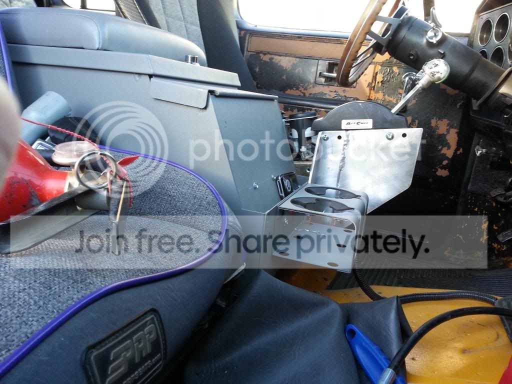

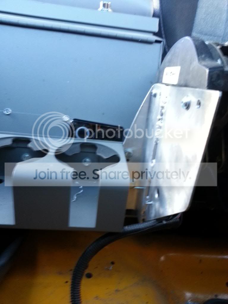

The trick is that I had to do something with my transmission shifter. I decided to mount the shifter to the console. Took my first shot at welding aluminum and made a bracket from a piece of .090 sheet and 2" angle aluminum. It's not pretty but it'll get the job done. Just bolted the bracket to the front of the console next to the cup holders.
Sorry for the blurry pic.

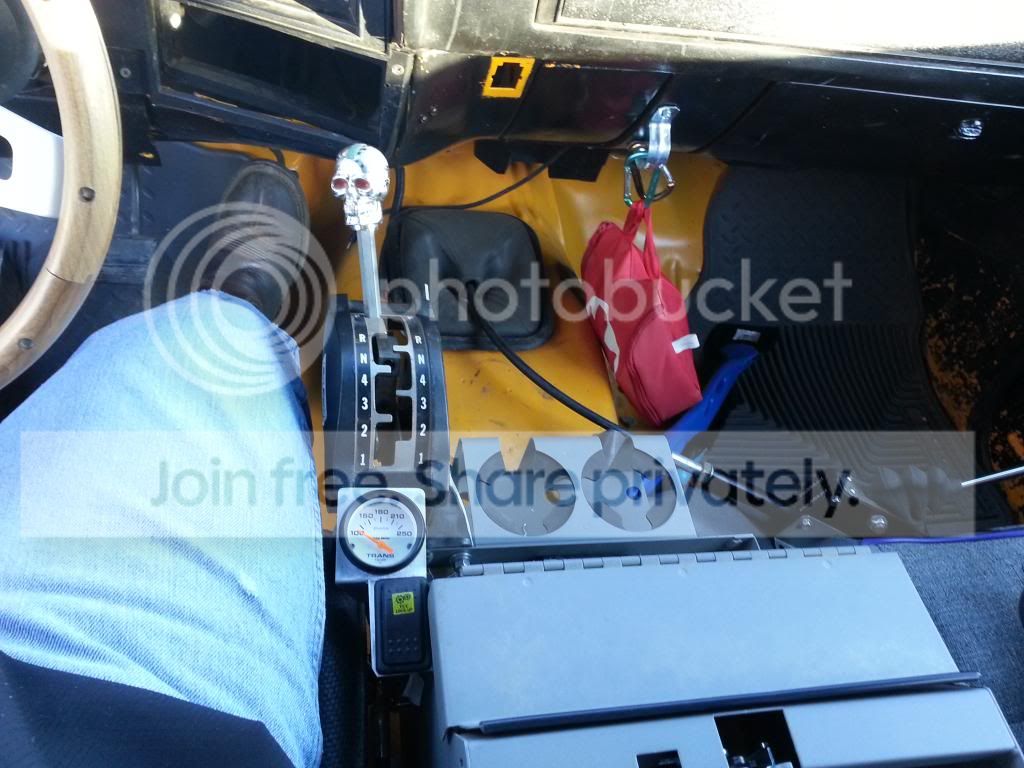

You can see the first 2 holes I drilled, but I decided to drill a set further back which is the perfect spot. The other thing I did that really turned out nice was to angle the shifter up about 10°.

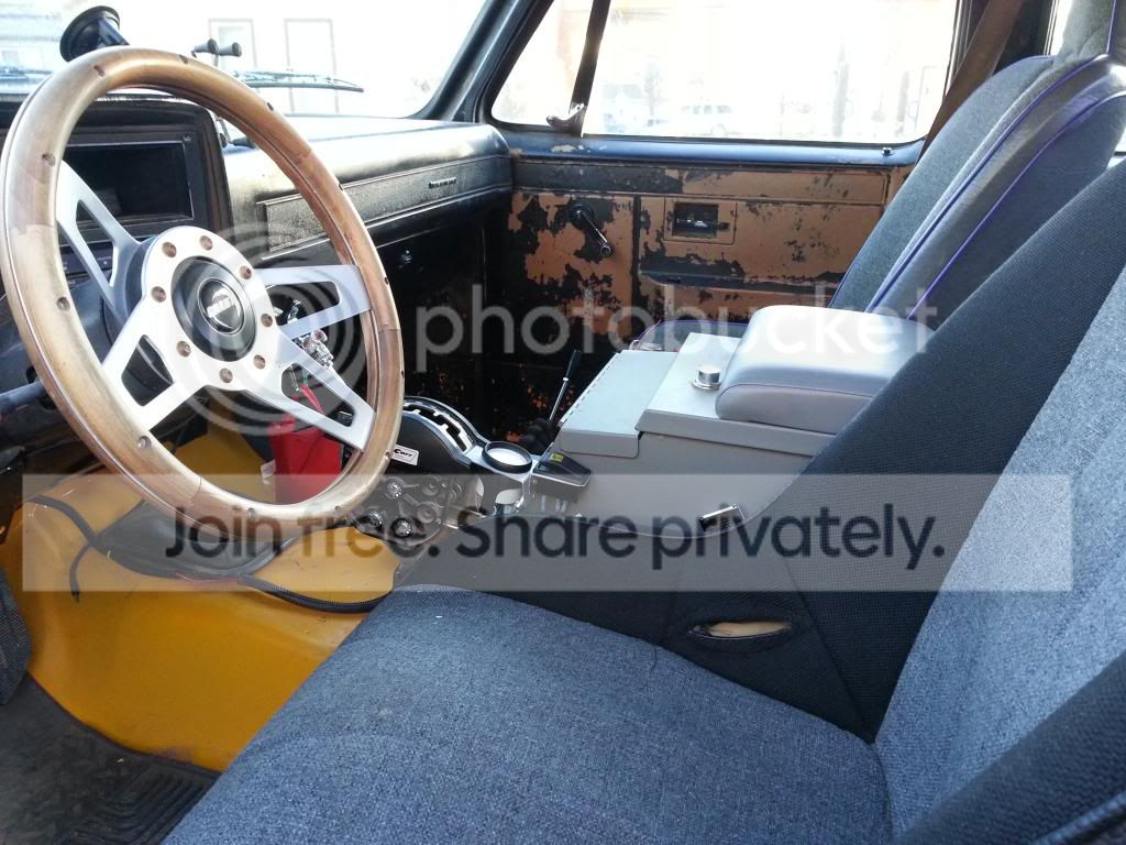

Here are some additional pics of the console setup.
Here's a picture that shows where the shifter sits in relation to me when I'm driving.
You can also see the cup holders sit in a great spot for easy reach.
I mounted the CB in the front portion where they intended a stereo to be located. The CB is a little deeper in than I intended but it'll work. It is shifted to the far side which was intentional. I'm leaving room for the in-cab winch controller.
The only catch is that the little lid/door over the stereo section hits the shifter before it's open all the way.
I don't like the idea of leaving it open when I'm using the CB because it will impede access to the cup holders. I think what I'll do is cut off a little corner of the lid so I can shut it and leave the CB mic outside of it for use.
Now I just have to decide where I'm putting the transfer case shifter. Originally I had thought I could mount it inline behind the trans shifter but I forgot there was a long metal piece running out from the back of it. I have a feeling it's going to end up in about the same place a factory tcase shifter would be.
