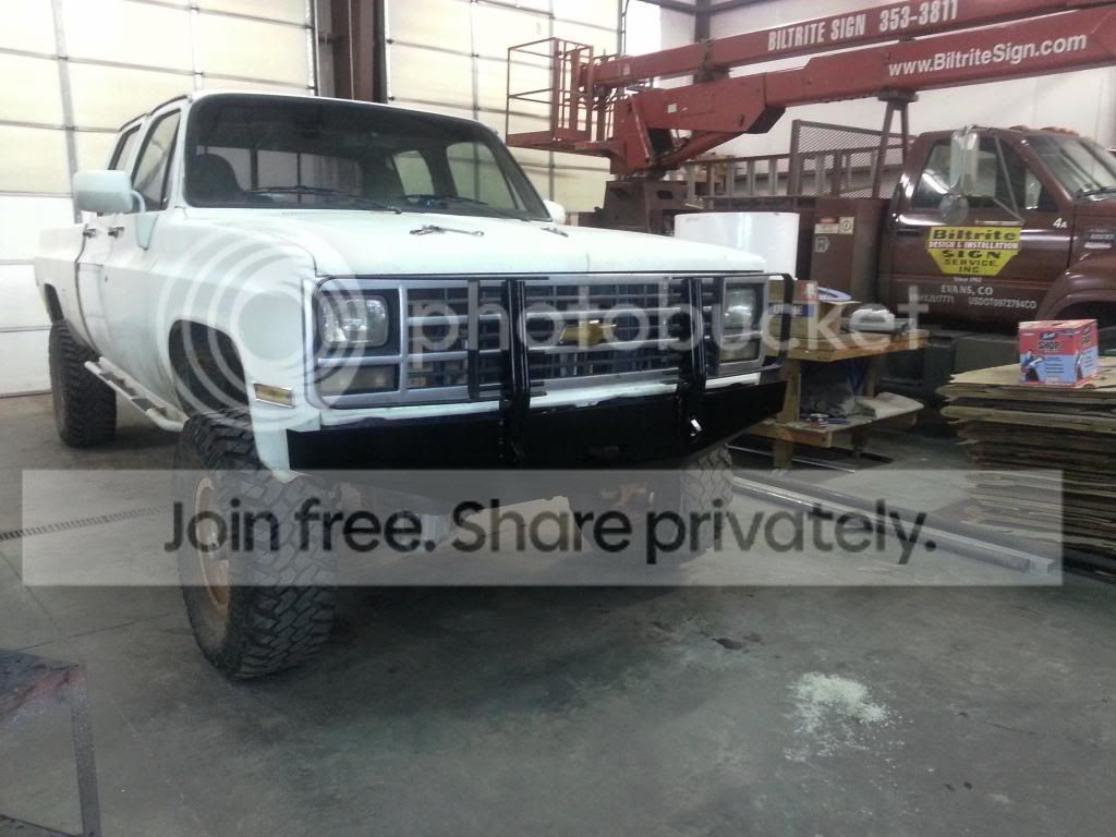

Finally had a weekend back in the shop to work on the truck. I've been wanting to make a grill guard to hopefully keep from busting up the headlight bezels on the trees I'm sure to run into this long old truck.

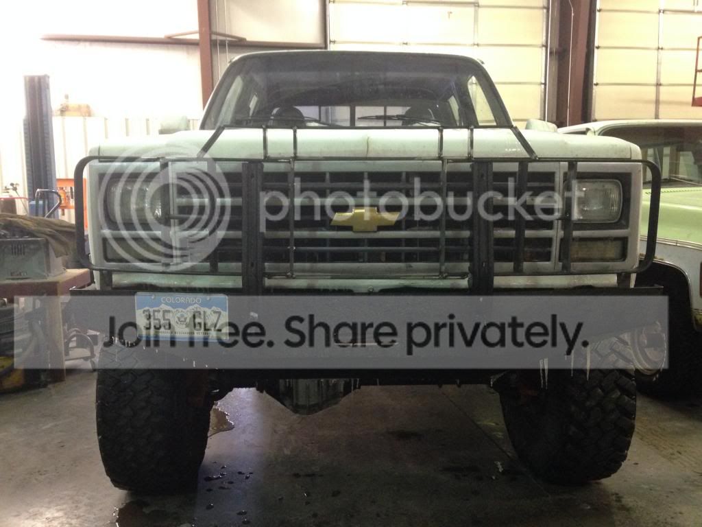

I made one of my routine pick-n-pull scouting runs and I came across a grill guard just like I've been looking for. I uses flat strap around the perimeter. I like the looks of the grill on this truck so I don't want something that will cover up much of it. The guard I found is made by Luverne and it was on a early 90's Chevy. Looked like this one, but it was black:
The perimeter piece is made with 1.5" wide, 3/8" thick flat strap.
The curve of the grill guard is too much for the older front ends. Plus it's not quite wide enough. So I cut the center part out where most of the bend was. I trimmed the uprights and welded them to my bumper. The grill guard bolts to the uprights. That way I can remove it for access to the stuff behind the grill.
You can see in the last picture I did notch and bend the end pieces back to match the angle of the bumper.
Now I'm going to fabricate a new center section with flat strap. I also added brackets from the end pieces down to the bumper. This is where I stopped:
I removed the grill guard and I can finish welding it up off the truck.

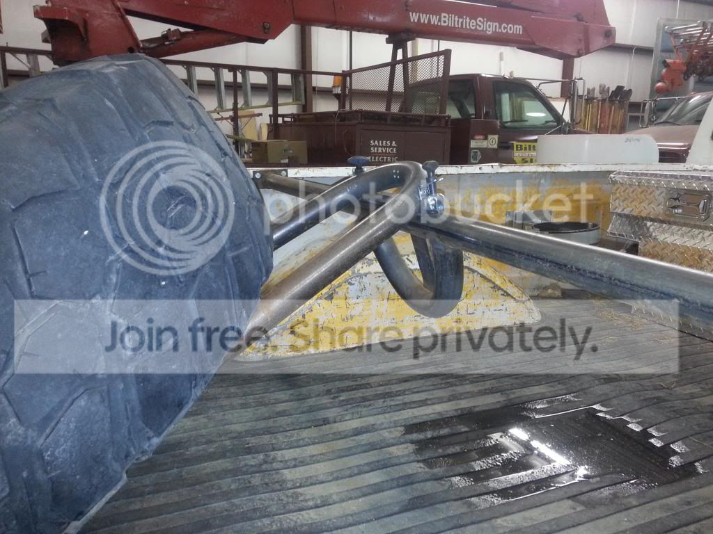

I also added these little rubber hood latches to hold the tire carrier down. I think they'll work okay, but I'm not as thrilled about how they are sticking like bunny ears. I may do something different in the future.

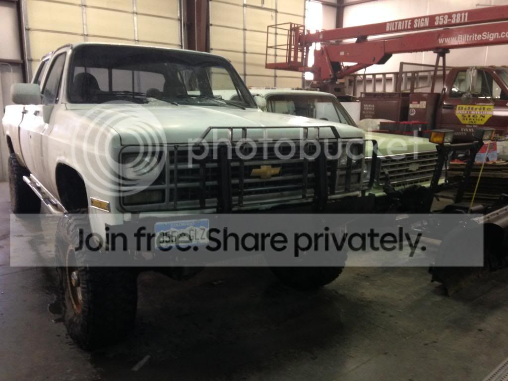

I like the grille guard!

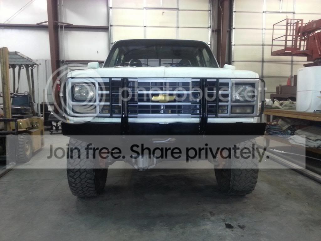

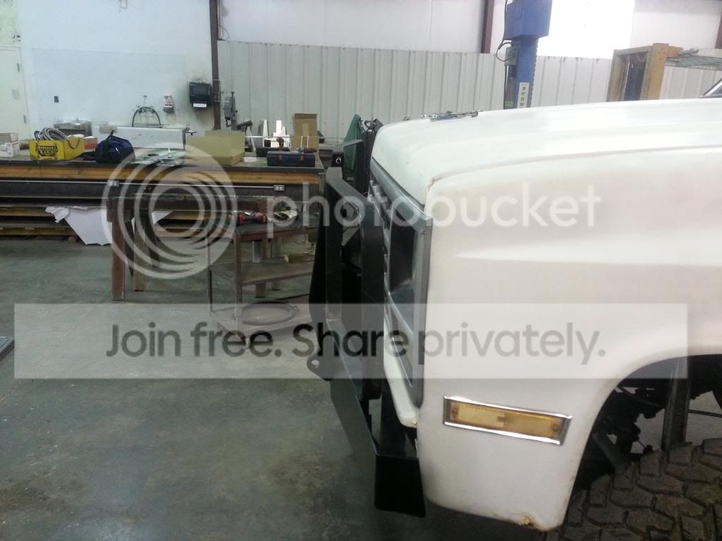

Still finishing up the grill guard but I did test fit it today.

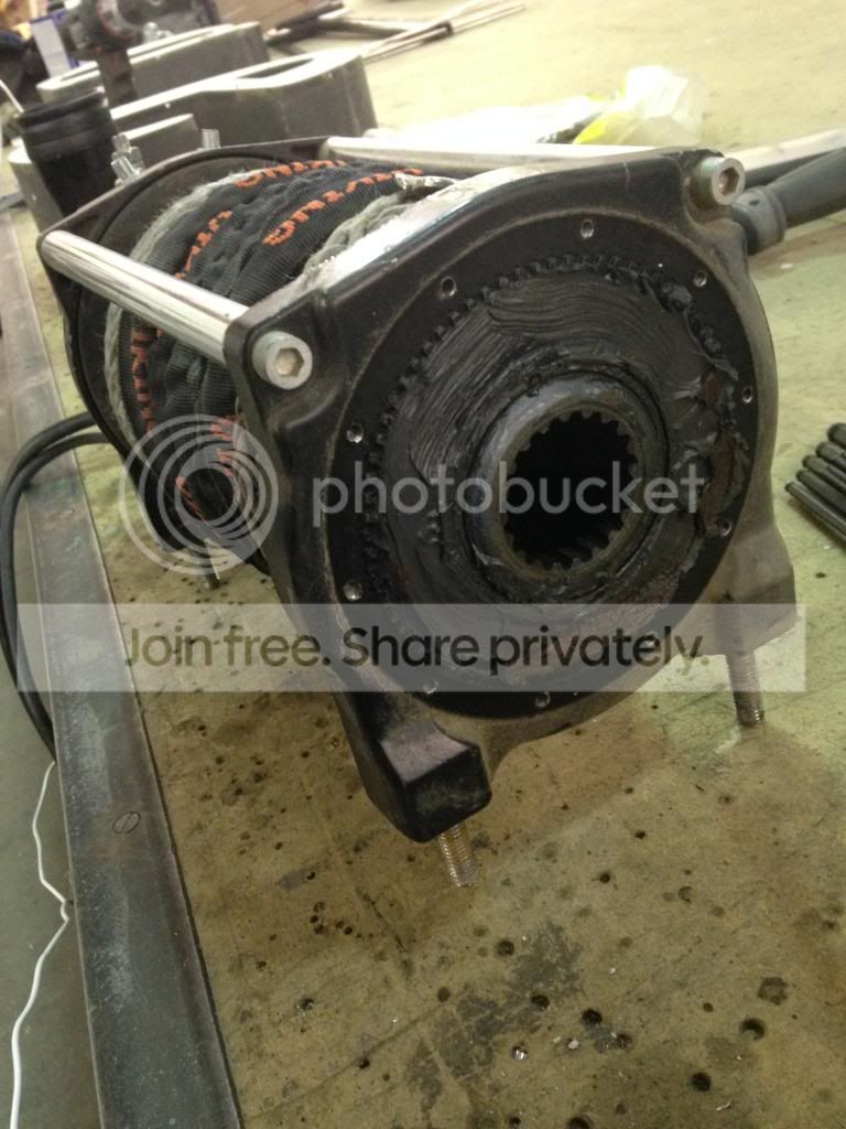

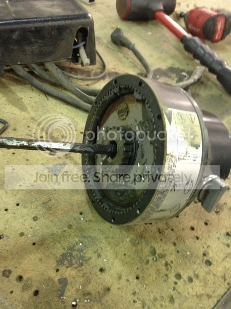

I also bolted in the winch. Because it will be "feet forward" on this bumper, I had to clock the clutch end. It was pretty simple, remove the allen bolts and rotate to the point the bolt holes line up. The trick is also getting the gear teeth to line up. I had to have it just the right spot for the bolt holes and gear teeth.
Here's what the end looks like removed.
You don't need to pull the end all the way off. And be careful not to turn the loose end down because all the planetaries will fall out. I had pulled the gear end housing all the way off and I thought it would be easier to put back on if I set the winch up on the motor end to drop the gear end back on. But when I did that I just dumped all the planetaries out on the bench. :doah:
I forgot to take a picture but the clutch engage lever did not end up straight up on top but it's rotated a little forward.

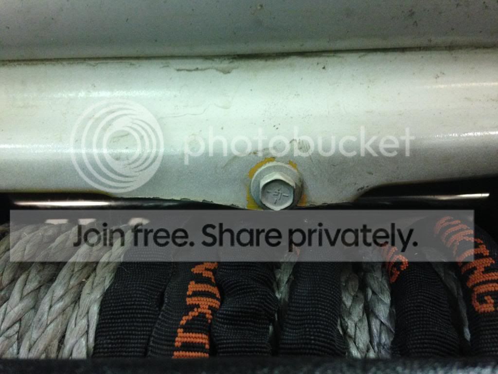

I'll have to be careful when the rope is spooling in because if it gets too bunched up in the middle it will rub the metal piece that runs across the front of the truck under the grill and headlights.
There's only about 1/2" of clearance. You can see in the picture I cut and ground down as much as I could. Also used sandpaper to smooth the edges.

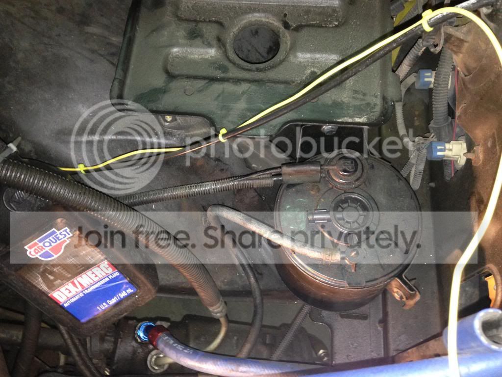

I had to drill 2 holes in the inner fender.
There were small dimples already in the inner fender to mark the locations. Probably so it could be used in a truck that need the second battery tray.
The other trick was to remount the charcoal canister. I drilled 2 holes in the leg of the battery tray and mounted it there.

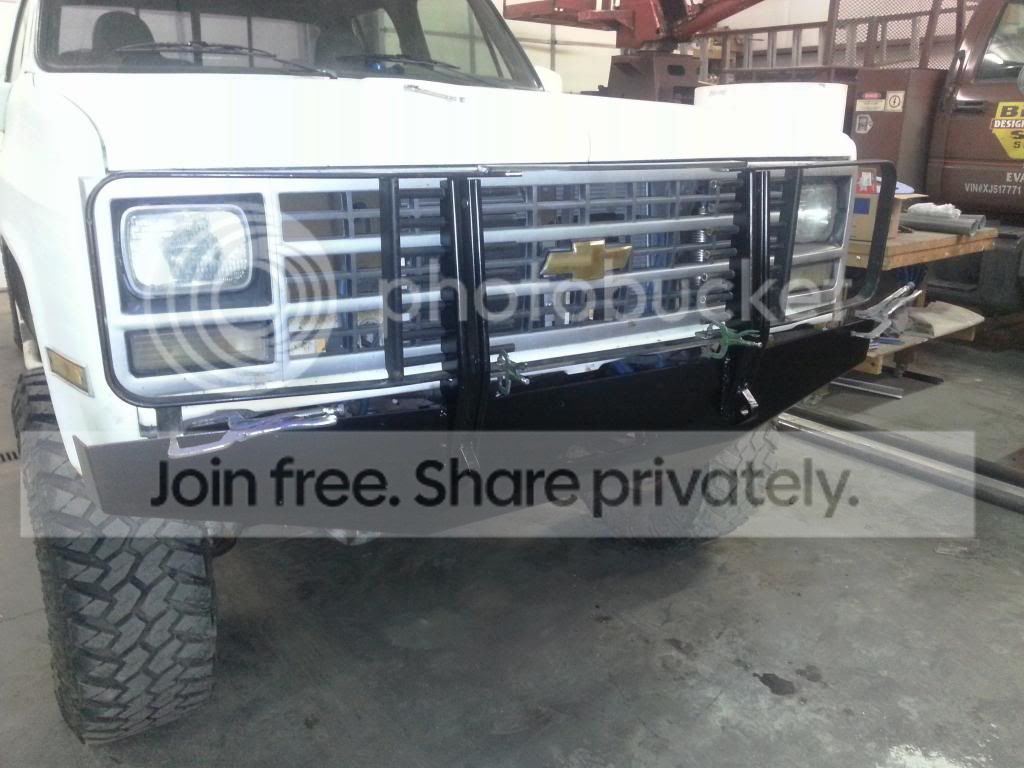

Grill guard is done.
