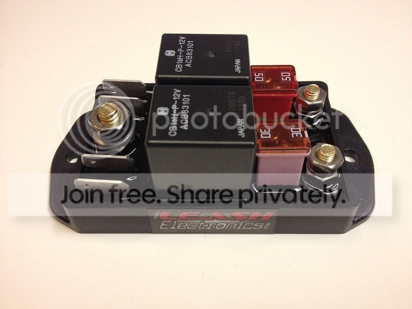

I decided to use a dual 70amp relay board from Leash Electronics.
I had Windstar fans in my K5 and I remember I tried a 30amp breaker for the big fan and it kept tripping so I had to bump up to a 40amp breaker. I figured using 70amp relays would be keep the relays from being overtaxed. The big fan has a 40amp fuse and the small fan has a 30amp fuse.
I have temperature switches to active the fans.
I needed connectors for the relay activation spades. I figured out the bottom 2 slots on my 3-slot 56 series plugs lined up perfectly. I just shaved the third hole off which also gave it good clearance between the plug body and the relay board.

I filled the back of the plugs with silicon to keep moisture out. I used the factory fan plugs and wires and ran a 6ga wire through an 80amp fuse to the feed side from the battery.
