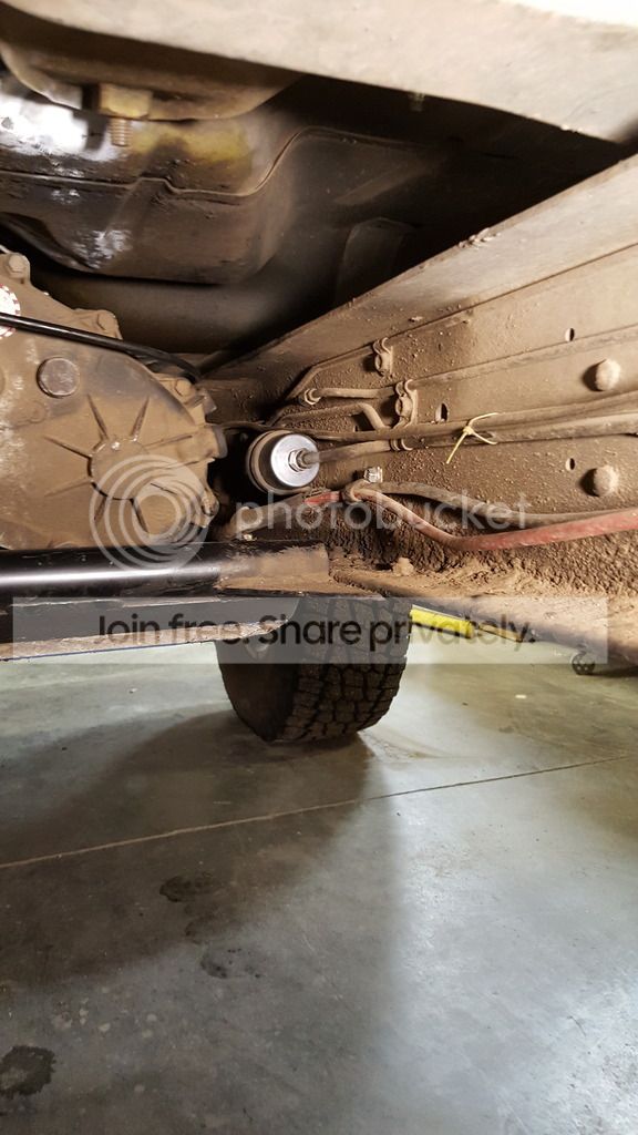

I changed out the fuel filter.
I'm sure in a factory 4wd truck the filter is not located right by the transfer case. Plus having it clocked up doesn't help either. It was a pain to change which is why I'm pretty sure I haven't changed it. I thought at first it had fixed my problem, but it didn't.
However I did notice the driver side fuel pump was making quite a bit of noise when I first stared the truck after the filter change. But then it seemed to quiet down. After the unsuccessful test drive I was looking over things on the motor; potential vacuum leaks, etc. I went to start the truck to look at the injector spray pattern, and the fuel pump was operating loudly again.
I did the test drive on the driver tank - which has the noisy pump - because it is over 1/2 full; the other tank is little under 1/4 full. Now I'm thinking it might be a fuel pump issue. Didn't have time for second test drive so I'll have to test my theory Monday.

So it is the fuel pump in the passenger tank that's bad. I think I had it backwards earlier. Interestingly it's the newest.
Kinda feel like this is pushing me to the K5/Burb tank.
