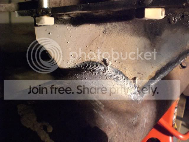

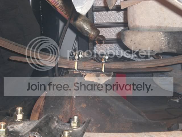

Doubler Had a friend weld a block off plate in , and cut a plate for the doubler. Need to call madrooster , and get a shaft ordered. Other than that I need to cut the center , and drill some holes. Started working on building a bender , almost done with it just need to finish boring some holes.

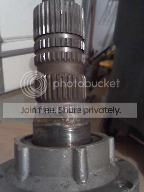

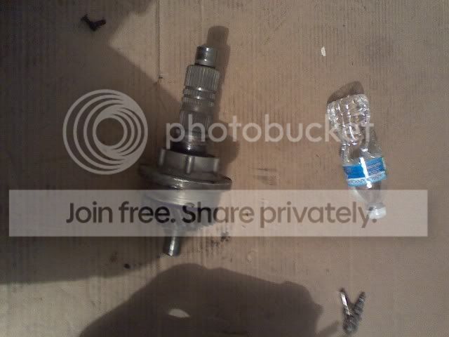

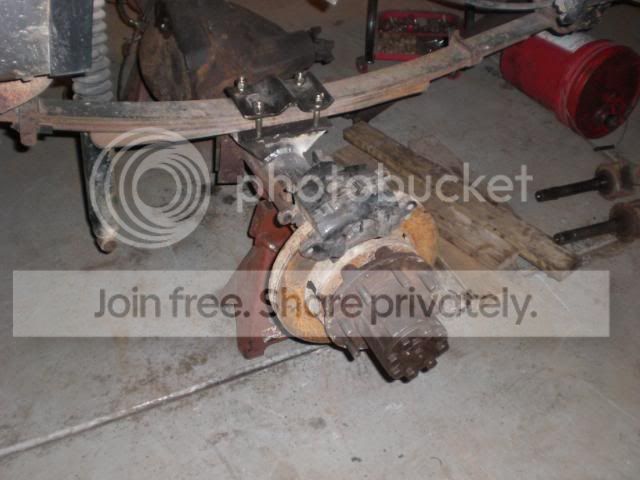

I have my doubler just about done. I keep recieving parts to do stuff , but have been short on time. Here is a few pictures.
Sorry for crappy pics... Cell phone .
Doubler is home made. More pics later.

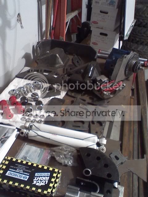

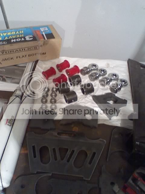

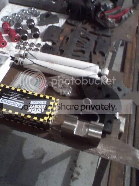

So far the parts list is as follows.
GLO Diff Covers
Sniper Fab rear 4 link kit (Brackets)
Shocks
Air Shocks
High Steer Arms
GLO Clocking Ring
Doubler
Bender Die
Calipers
Brake Pads
Lockright.
Heims
Poly's
Tube Inserts
H1 Beadlock Inserts

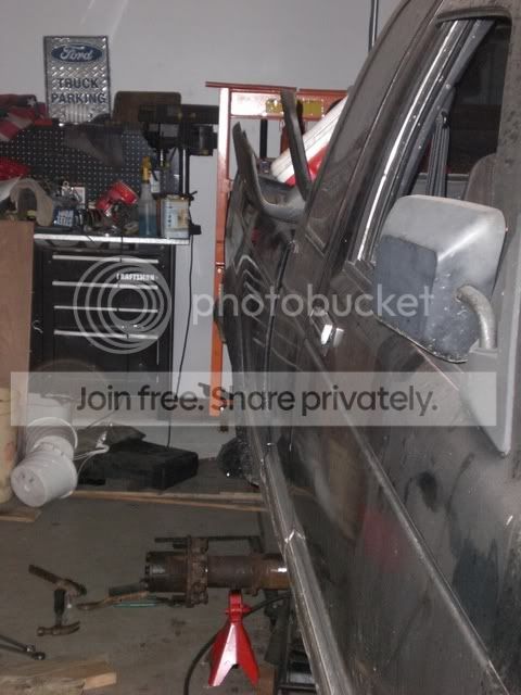

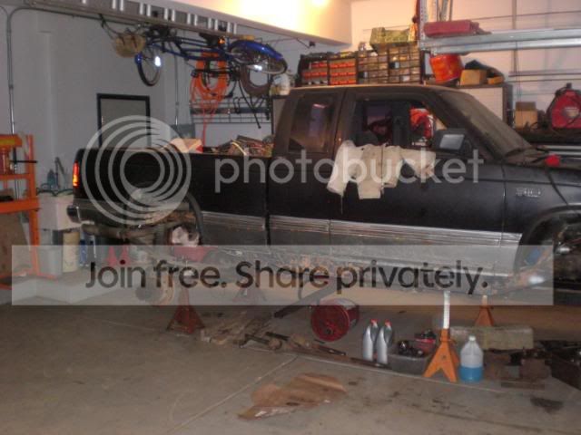

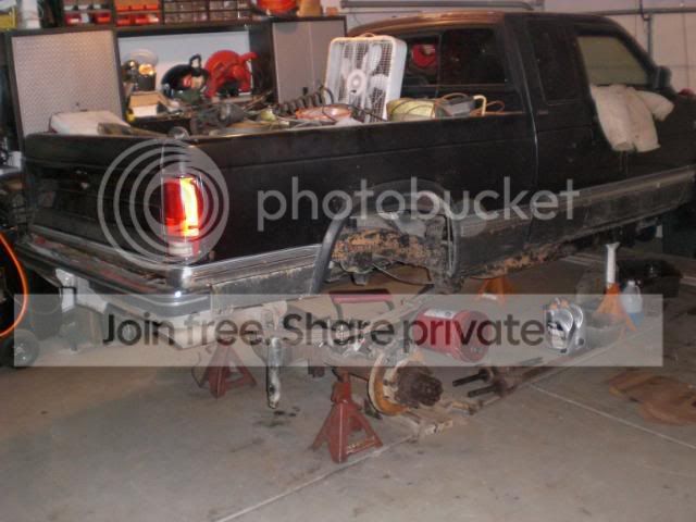

Well been making slow progress , waiting for parts. This weekend the plan is to blaze through the links ,and get the full hydro all done . Then make some Cross members ,and other misc things. Anyways I will update as I progress hope she is sitting on tires tomorrow night. Today we started at 4 made some decent progress but called it a night after the cops showed... Here is pics...
Started out by chopping the front of the frame....
Temp X Member..
Frame Chop time...

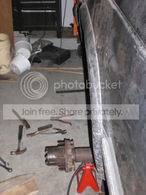

Beginning to Rotating the C's
Started on my c rotating jig..........
Also the Decision was mad to go 3 Link Up front . The packaging with the 4 Link wasn't working to well with the Drive Shaft.

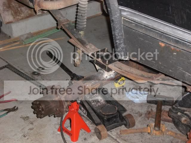

I've got the c's ground so I can see a crack between them and the tube with a few outward schwacks with an 8 lb sledge.
Gonna try to rotate them without heat, with a little hydraulic assistance. Gonna finish dismantling the axle tomorrow and get started on the fixture to hold the axle.

Well finished the stand today, and got the one c rotated about 4 degrees in about 20 minutes. Going to get a new bottle for my butane torch, think a little bit of heat will make it even better. Just gotta get some castors for this thing next week and weld them on.
