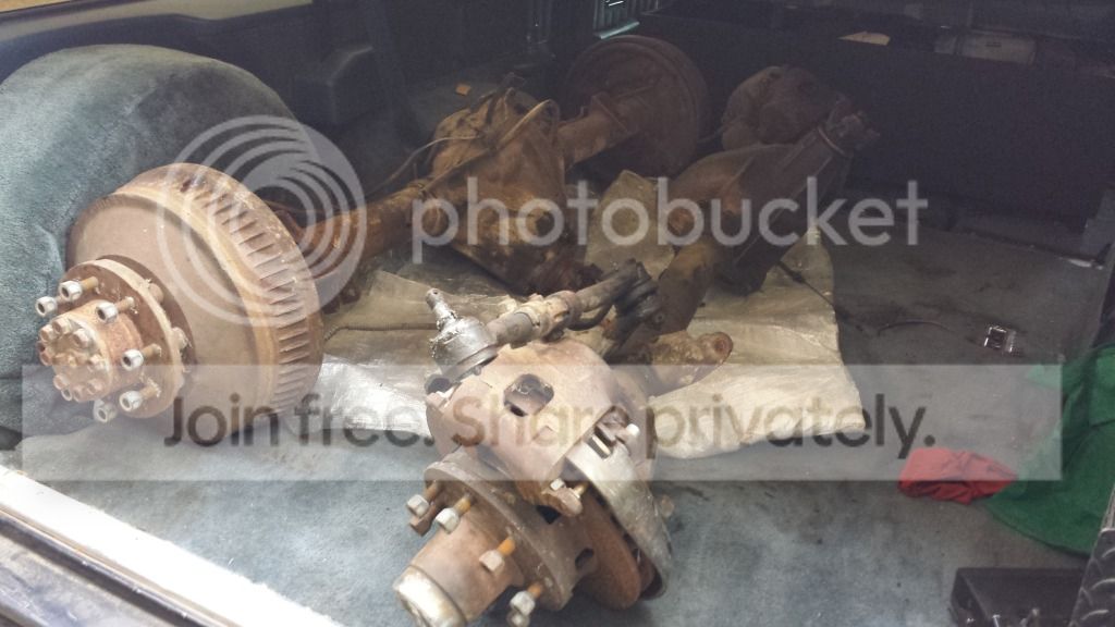

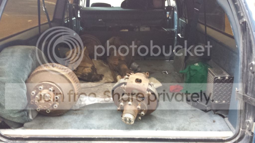

they are a 14bolt and 10bolt from a 79 suburban with 4.10s and posi. I have a 2.5" lift but im thinking about using part of it and making a call to ORD for a 3" shackle flip and some other stuff. im planning on running about 33s. As a family we have gottan the kids into skiing and my plan is to make this ski trip hauler. So I dont want it too tall for practicality.
After owning for 14 years since high school I sold my 85 K10 this week. it was so far from its glory days and with three kids I lost interest in using a 2 door truck with bucket seats. What I got out of selling the truck is going into the burb. Not enough for all I want to do but a good start.
Current plans are to go throw the hubs and brakes on these axles so after they are in the burb I know what im starting with.
install the 2.5 front springs and get a 3" ORD shackle flip, some greasable bolts and bushings. For now ill propbably just use the shocks that came with the used lift but I really want ORDs front shock brackets and some bilstiens.
