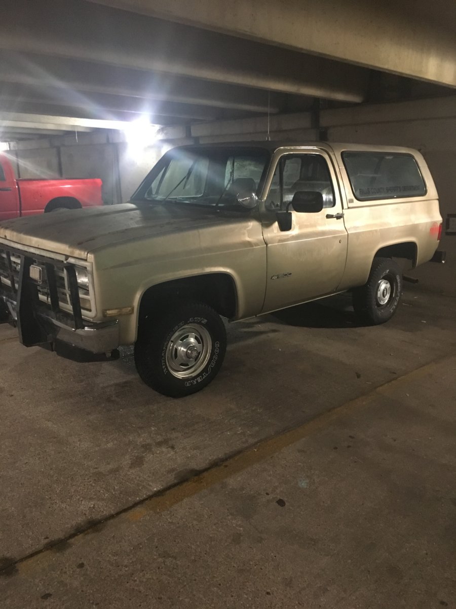

On 08/27/17 I purchased 'Barney' a 1990 Chevrolet Blazer for $3,300 with 145,900 miles on the clock.
I had been watching this truck on Craigslist that was originally listed for $7,000 at a used car lot, over a couple months the price dropped several times and once under $5,000 I started kicking tires. I plan to give you the good, bad and ugly as it comes up.
Barney was originally sold to the Texas Parks and Wildlife department with a build date of 06/90 and then was sold 04/94 to the Falls County Sheriffs Department where they sprayed a terrible Gold paint job over it and slapped some D.A.R.E. stickers in the windows and because of his service to the Sheriff Dept is why my wife and I have dubbed him Barney Fife (hopefully everyone gets the reference).
Apparently Barney was deadlined in 2003, the latest maintenance record I found while cleaning out the truck was from Walmart in 5/03 and the mileage on the ticket was 145,668 for a battery replacement. Either something happened to the odometer or this thing only made it less than 300 miles in just over 14 years! The dealer I bought him from said that he purchased the truck not running and it had obviously been sitting for a long time, he slapped a new fuel tank, pump, distributor cap, wires, plugs and air filter and put him up for sale, dry rotten tires and all! Because of how long Barney has sat I expect issues so the best way to find those I believe will be to drive them out. :woot:

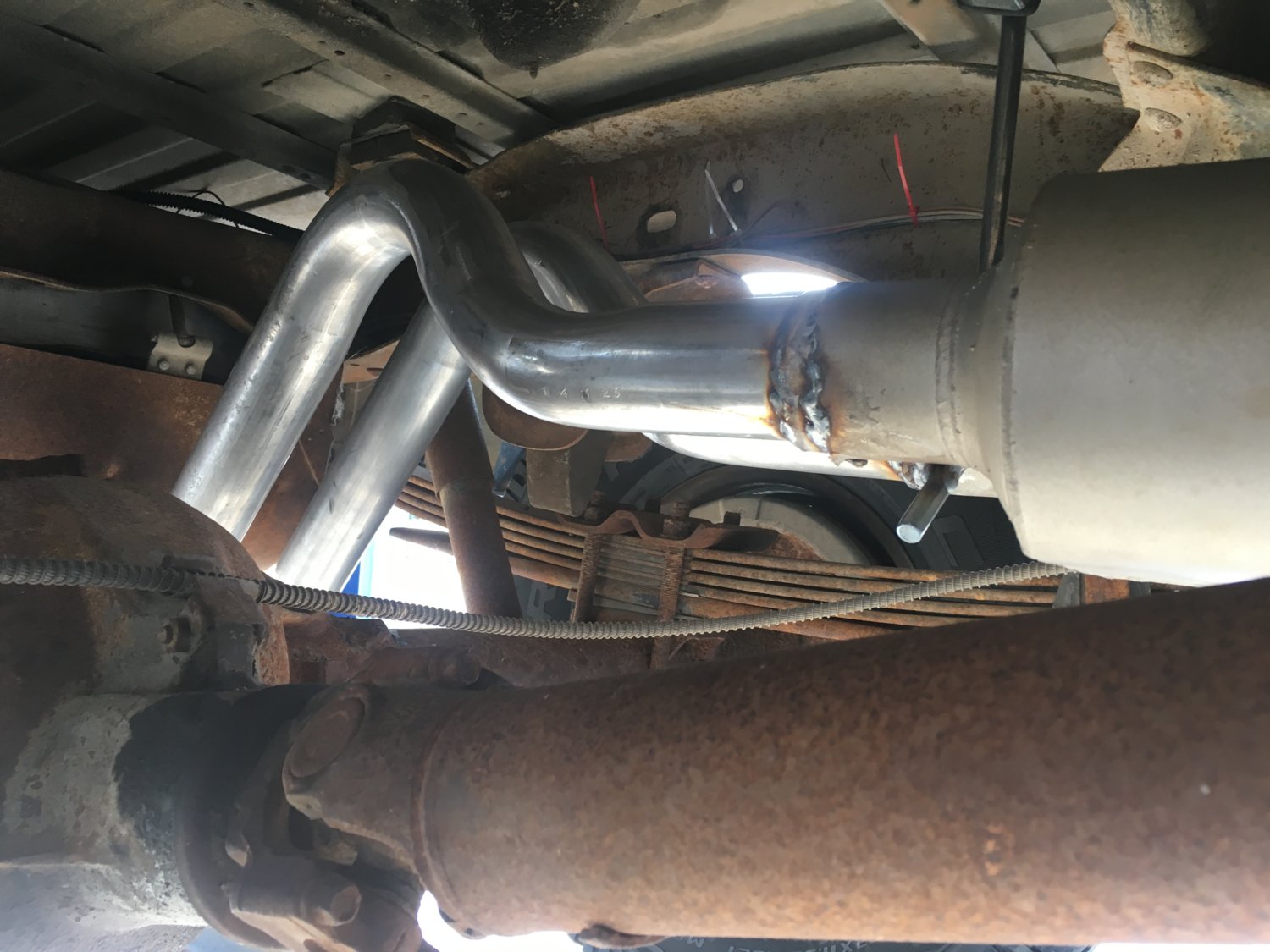

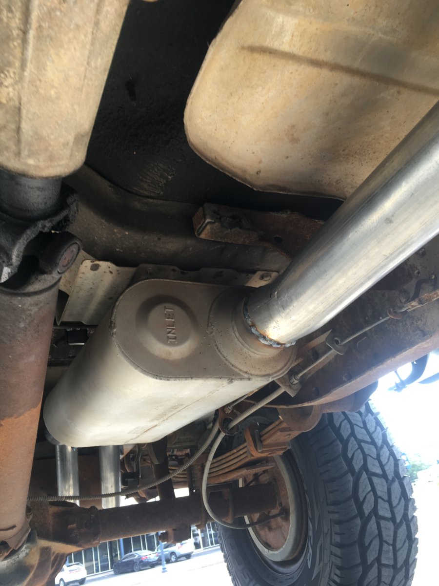

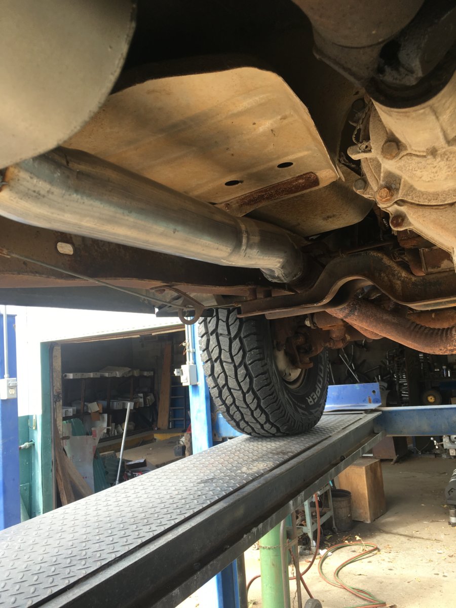

My Dad runs an exhaust shop and had a take off 50 series Flowmaster, the existing muffler on the truck was blown out and rattling like crazy so we lobbed off the muffler and some other weird pancake looking thing :whistle:and dumped it over the axle so I can get some more miles on him and see what else falls off.

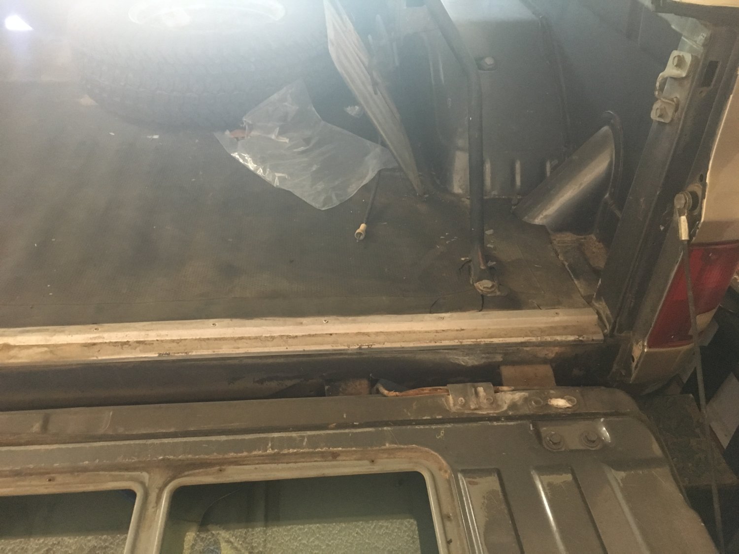

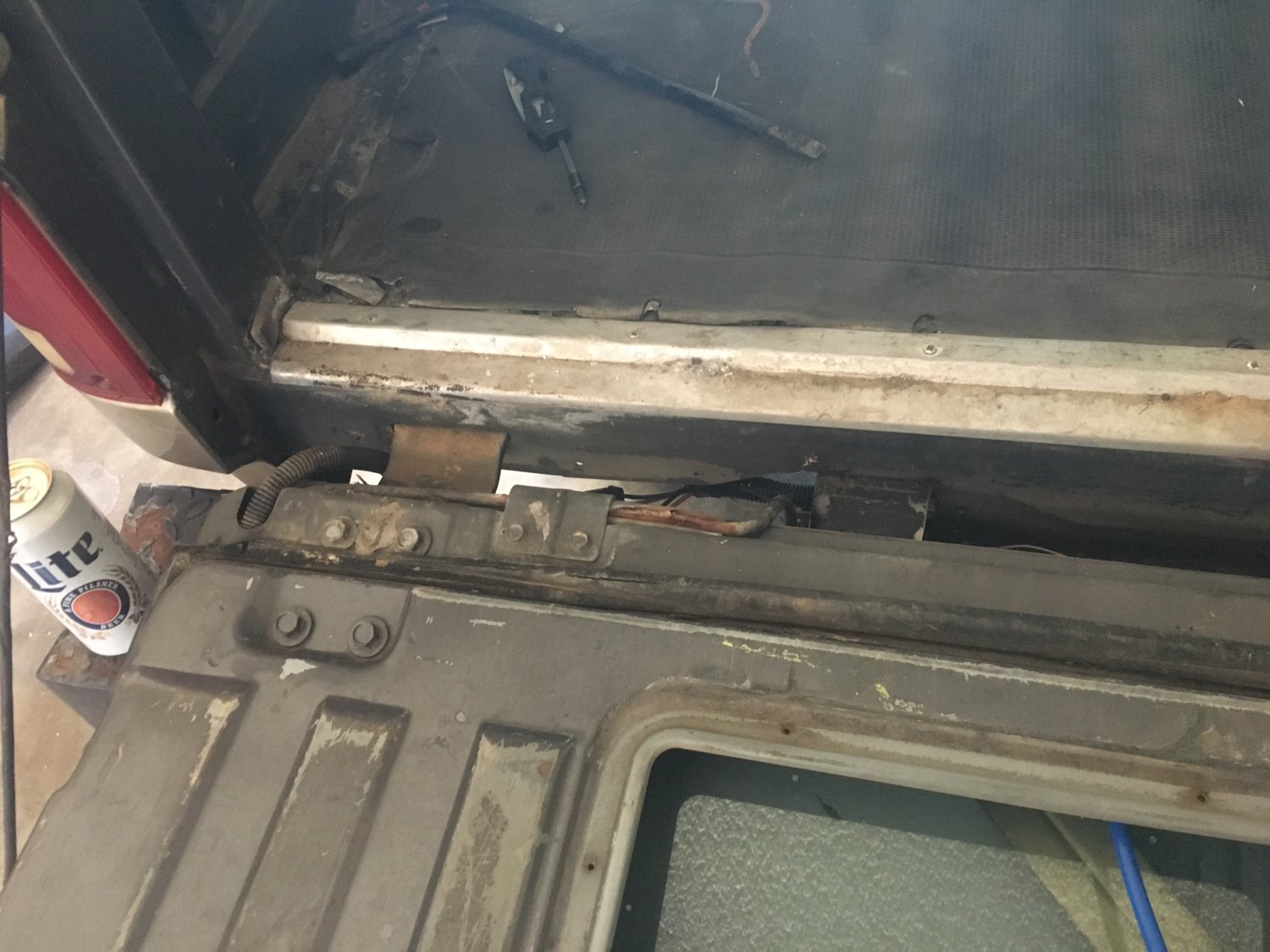

Since I first looked at this thing the tailgate window hasn't worked, the dealer I bought it from told me 'if you hit the window switch enough times it will go down'. It never went down, I did some looking and found the cable was seized up, ordered a new one from LMC and I finally got time to install it yesterday. I've lost a lot of sleep worrying about how much rust might be hiding under there but was pleased to not see any once I got the tailgate down.

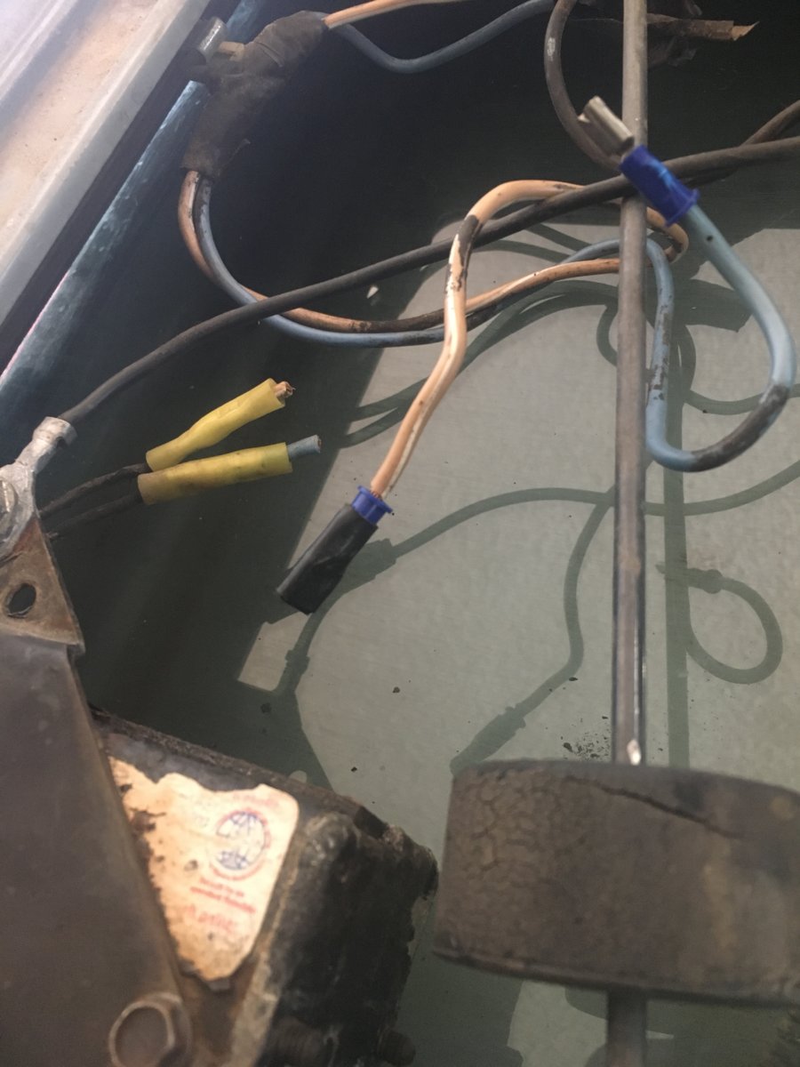

Here is the wiring for the window motor, obviously it wasn't ever going down, I don't for the life of me understand why you would feel the need to be dishonest about it. The old motor worked but it went up very slowly and needed help to roll it up all the way, I bought a new one and now it runs up and down smoothly!
Does anyone have any thoughts on the tailgate? It appears to be the factory color and was repainted at the same time as the rest of the truck but the emblems say GMC. Do you think they really just got lucky enough to find a GMC gate the same factory color?

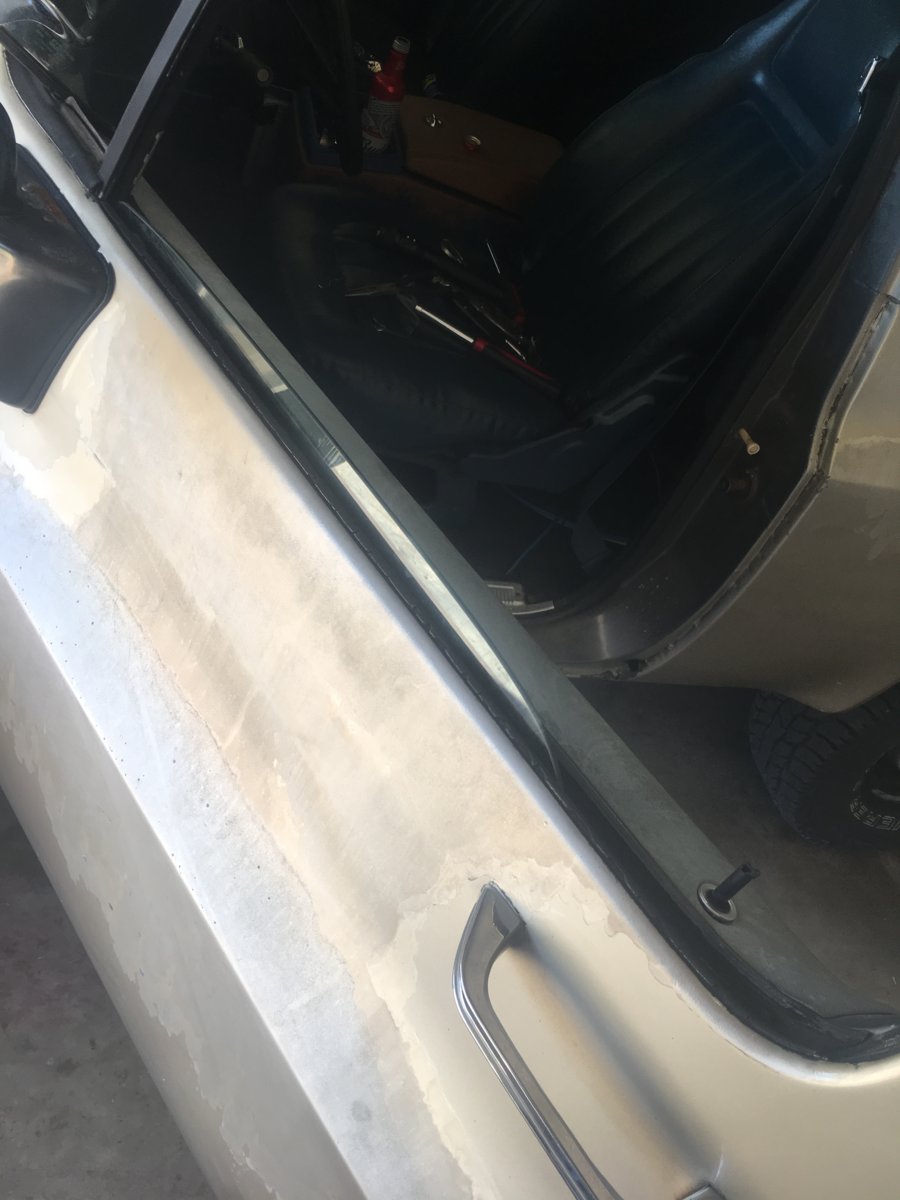

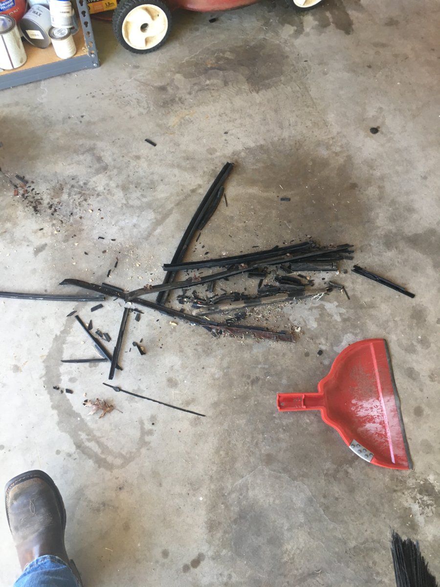

I finally stripped my old seals out of my doors and installed LMC window seal kit #38-5651, after I purchased them I stumbled across a couple people on this forum that didn't speak highly of them but I didn't have any issues and am happy. My old seals were so worn and rotten you had to guide the window up by hand, our Texas sun is no joke!
I haven't had a day off since the 9th and won't have a day off until 11/3 so doing anything has been a slow process but all this overtime should cover some parts money! Barney has been my DD this whole month without a hiccup so I'm happy! :woot:
