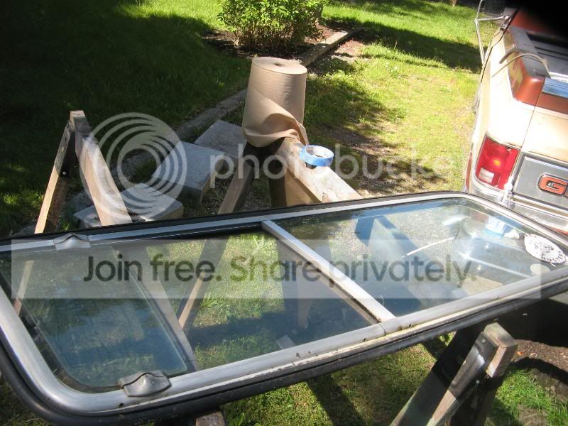

Also in the parts truck pile I picked up were a set of sliding topper windows. My AC may work, I haven't tried it. Even if it does it'd be nice to get the extra air for the rear passengers with the slider windows.
As I got them...dirty, crappy tint peeling off, stickers. Bleh...but after a bit of elbow grease they cleaned up.

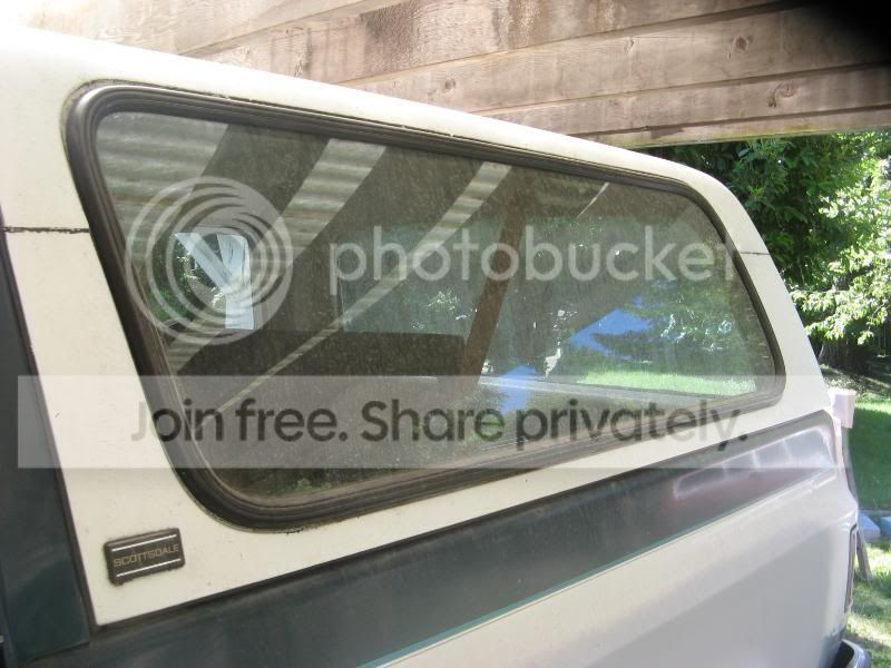

the old plain glass.
And the almost installed slider. I sanded down the exterior aluminum and blasted the frames satin black. I kinda like it!
For those that haven't re and re'd side glass in a topper it's dead easy. In the pic you can see the ropy lookin black thing. It gets pushed into the slot in the rubber frame all the way around the plain glass, or aluminum frame if you have sliders. Some liquid hand soap in the slot makes it go pretty easy.
I used a pair of flat screwdrivers to remove the old glass and install the slider assembly.
