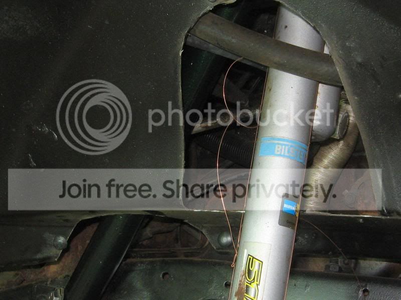

I would also like to run a bar from the A pillar downtube to the front of the frame and use a tie in across the shock mounts and the radiator support....still dreaming at this point but I really like your setup. How much did you have to cut the fenderwells if any?
This is what I cut from my inners. I do plan on some sort of rubber boot around the shock body to keep mud and debris out though. We'll see how that works out.

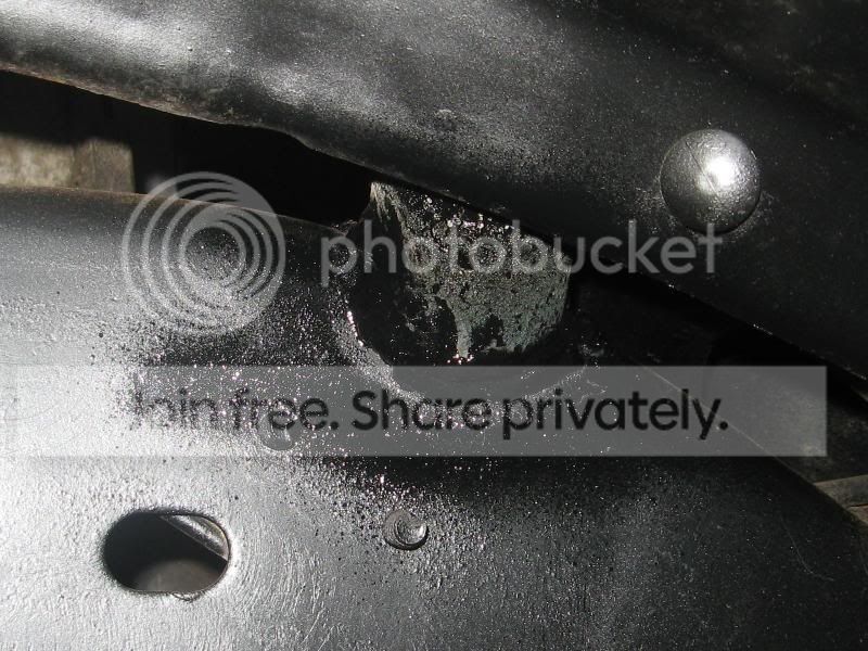

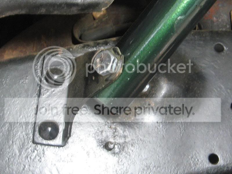

Lower mount, tube is capped with 1/4" stock and bolted through the existing upper shock mount bracket and holes.
Other end is welded to the frame. I guess I'm rolling the dice on this end...
I spritzed it with some rattle can black for now. In hindsight I should have masked the end of the tube off before painting. At least it's not in a very visible area.

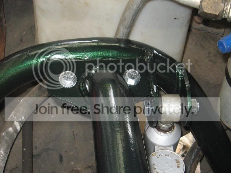

A shot from the top to show the upper mount better. The other pic's don't really show it as it's hidden behind the X-tube mount.
I like that I can somewhat easily incorporate this into a front cage down the road a ways, or just leave it as is if that's what i choose later. I have options.
