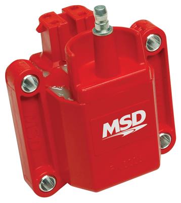

good find and good luck not workin out any bigger mods than nessessary.should be fun if you can stop yourself from overthinkin the build.it does sound like the coil is bad.when it goes bad,it will heat up to the point where it seperates when overheated and stops workin.should be able to check across the contacts on the coil.check my next post i put the actual readings from the book.
I have another coil sitting in front of me. Which contacts do you mean exactly?

first check primary resistance by checking between the positive batt terminals and tach on the cap with it unplugged and removed from the dizzy.should show o to 1 ohms.if it is above one ohm replace the coil.to check secondary windings hook up 1 lead to center of cap and one to tach lead on cap.should show above 6000 but below 30000 ohms.anything more or less than that replace the coil.test 3 if those two were good would be to hook 1 lead to neg wire and to the center of cap.sould show infinite resistance.if less than infinite it is grounded out internally and then replace the coil.those are the 3 tests and ranges to look for.if any of those checks dont look right then replace the coil.

Well i went out there this morning and brought a coil, a TPS sensor, and a coolant temp sensor with me.
I started right in and replaced the coil and the TPS, then diconnected the battery (to clear the codes) While I was waiting for a little bit I used my cordless drill to raise the rear glass. Glass goes up...always a good sign.
I re-connected the battery, crossed my fingers and tried to start it. It started right away, no pumping of the gas. I did get a Check engine light immediately though, and I had to keep my foot on the throttle a little bit as it warmed up. After a minute or so it settled into a nice smooth normal idle. I was already pretty tickled, so i let it warm up more as I got all my crap together for the drive home. Just as I was about to pull out it was like someone flipped a switch and it went super rich, flooded out and died. :doah:
That was what it was doing before. At this point I'm having misgivings about driving it home. I did still have the coolant temp sensor I could swap though...so with nothing to lose I swapped in the sensor i had with me and tried it once again. It fired right up, took 10 seconds to clear out the excess fuel and sat there running smoothly again! 30 seconds later the Check Engine light went out and never came back on. :bow: :bow:

Rene, pull the distributor from your spare engine, ignition modules like to give up the ghost when they get too warm/hot as well as a coil failure. Coil failures are pretty rare so i would suspect the igntion module long before a coil. You can easily replace just the ignition module without having to pull the dizzy but sometimes the pick-up coil goes bad as well and that is located deep within the distributor and the distributor has to come out and all the way apart to change it (easier at that point to just swap a complete distributor).
There is a complete spare TBI distributor that i found in the truck, plus of course the distributor from the Crew Cab motor. However, the K5 runs like a champ. Start and runs exactly as it should now. Turn key, no gas, and it fires up very quickly. Idle slightly high initially but settling to normal within 5 or 6 seconds. No miss or hesitation now, no CEL.
