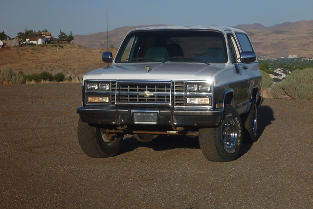

I just moved into Reno a couple weeks ago from So. Oregon. Loving it here. I bought this Blazer out in Fallon, about an hour east of here, on Monday night:
It's a pretty great truck. It's got the typical early 90s Chevy paint problems and a couple dings. The only real issue that needs immediate attention is that the previous owner had true dual exhaust with an H-pipe installed sans catalytic converters. So, I need to have that taken care of to get it registered.
First modifications will be to remove the goofy steps under the door, which you can't see in that pic, and perhaps also the push bar thing on the front. The only real reason I'm considering keeping the push bar for the time being is that it's got some almost decent tow hooks bolted to it.
