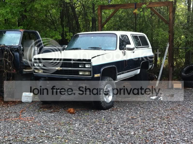

My 91 has the same thing going on with it, and it also had duct tape on it. And the reason the picture is orangish is because of the cover on my phone.
Its also a younger twin to yours, just waiting on a deal on 38's
