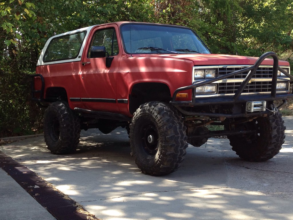

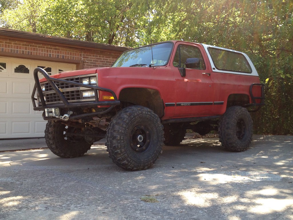

Here's what it looks like now:
It's hard to tell, but it's fairly rough from being wheeled hard then parked. It use to stay parked an hour away, out in elements, uncovered, only getting driven once every other month or so.

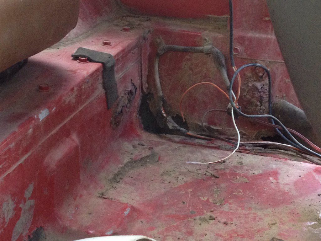

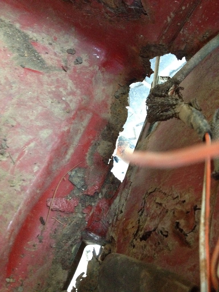

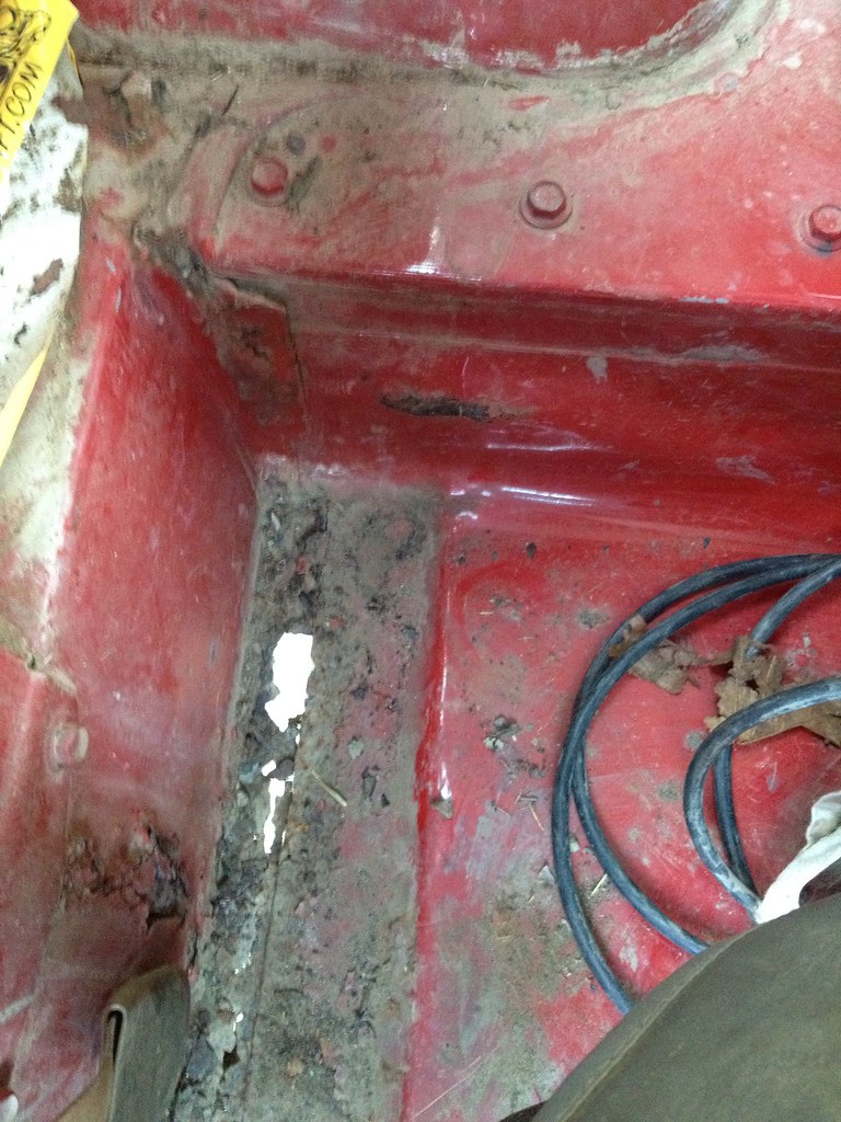

The floor is rusting out pretty bad in a few spots behind the front seats. I think I'm going to budget in some replacement floor panels.
The Blazer got a taste of daily driving today. Consensus: death wobble sucks...
I noticed the other day I noticed the passenger u-bolts and studs were a little loose, so I tightened them up. Turns out that the death wobble is worse after I tightened of the bolts. I guess that's more incentive to get the hydro assist and panhard bar on.
I took some pics of the floor.
Anyone have any experience replacing/fixing rust here??? Feel free to chime in.

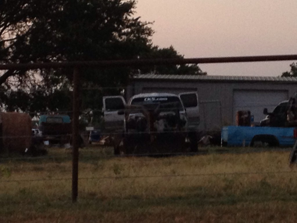

While I was out on a test drive I saw this:
Yes, that's a CK5.com sticker on that suburban. It looked pretty rough; no drivetrain or front clip, dented up pretty bad. Anyone sell one recently? I've lived in this area for over 2 years now and haven't seen this before. Kinda crazy.

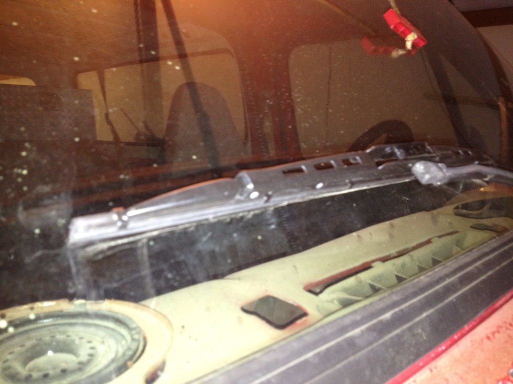

Oh yea... New wipers! :D

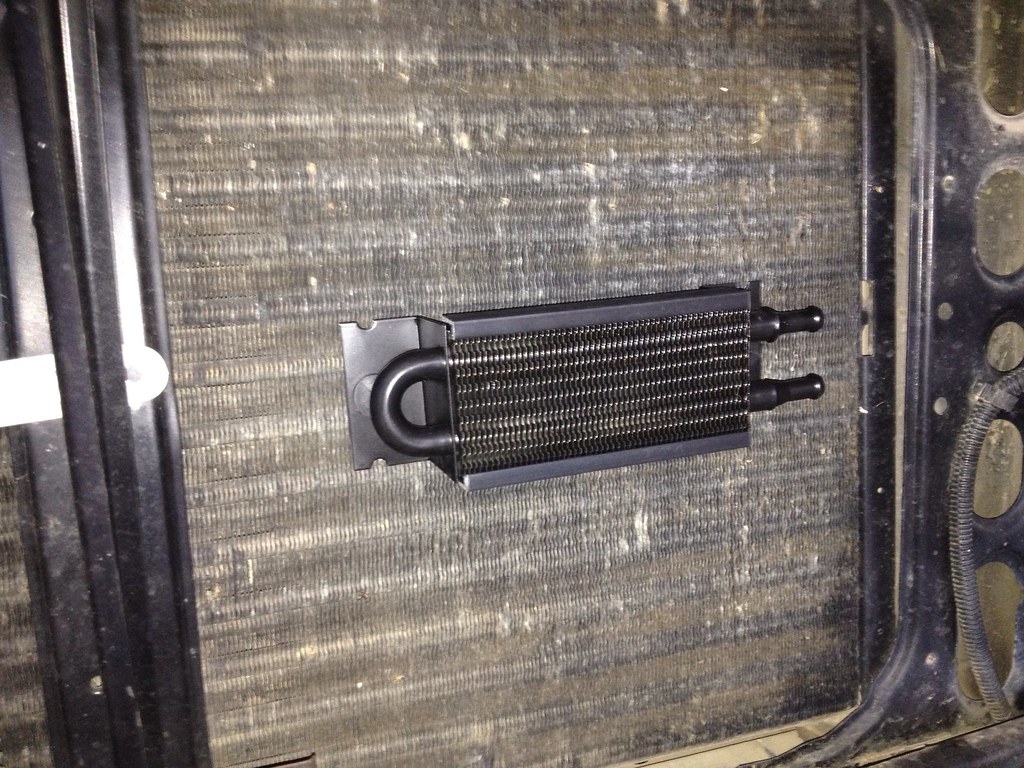

Started by adding the power steering fluid cooler:

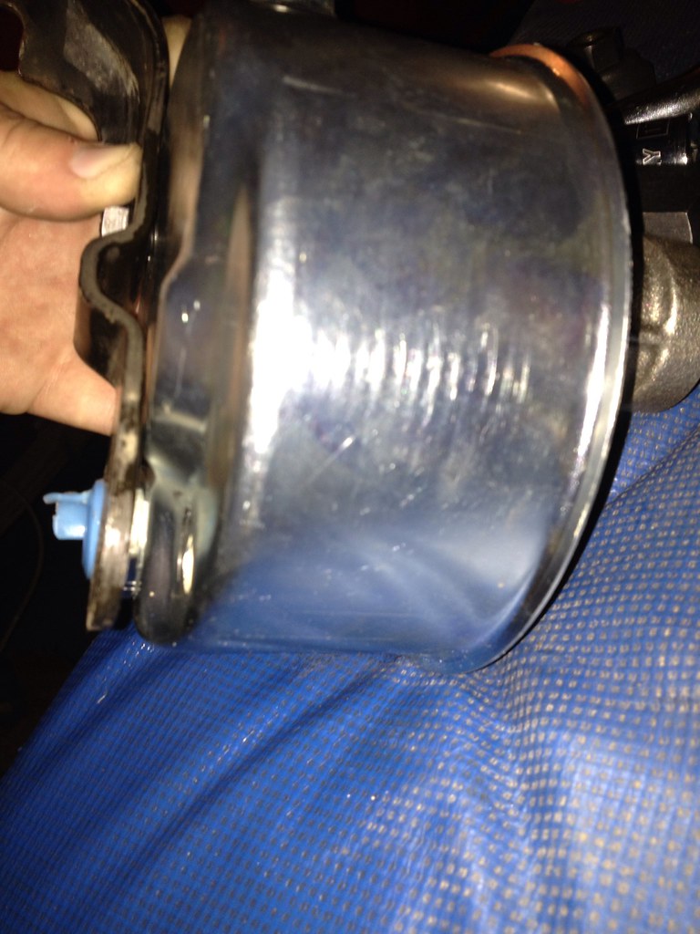

As I mentioned, I left the garage Tuesday night with the stock power steering pump pretty much off.

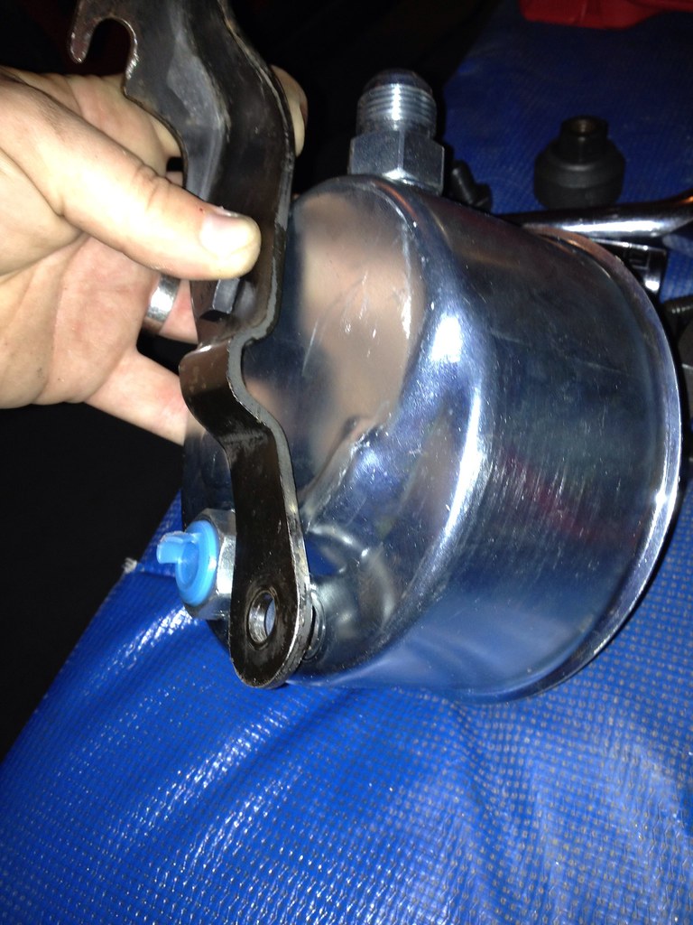

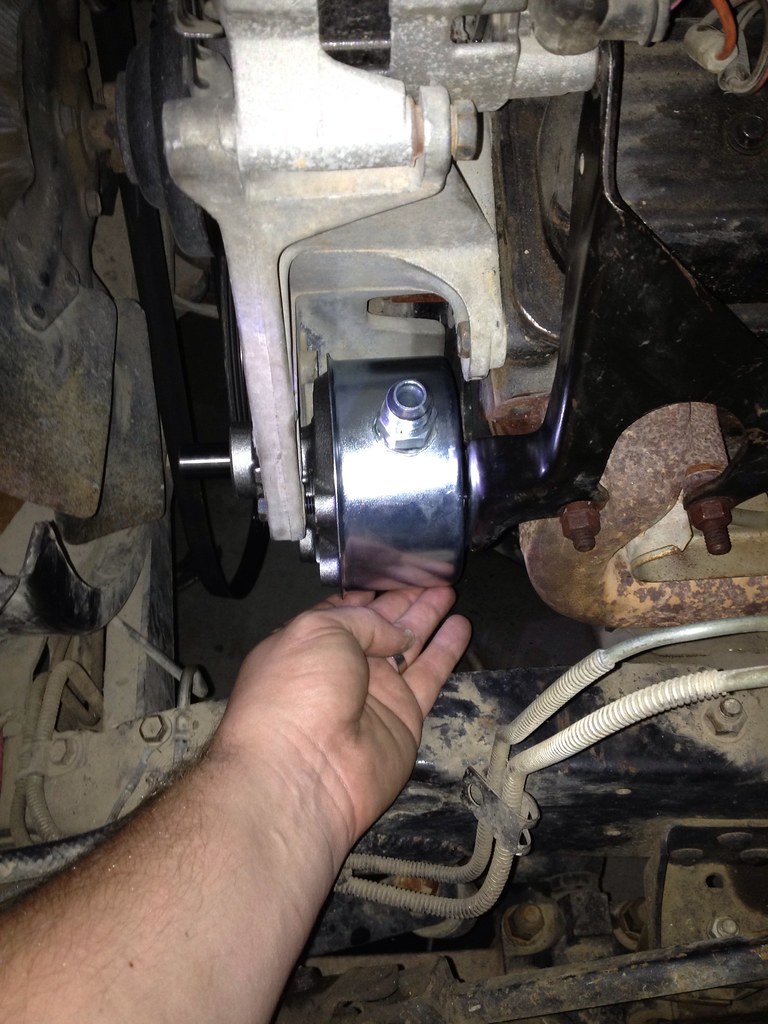

Wednesday night I didn't have a lot of time so I just mocked up the black bracket on the PSC pump. My kit didn't come with any instruction so I was just guessing at what to do.
The holes on the black bracket lines up, but the bolts weren't going to work:
I dropped it in the mounting location to see if it shed any more light on the situation... It didn't, made me even more confused since there's a gap in the front of the pump. :dunno:
I pulled the pump and bracket back out and went in for the night.

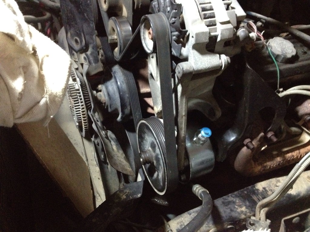

Thursday, I called PSC about the issue. To make a long story short, you have to swap over the studs that are on the factory pump over to the PSC pump.
So Friday night, I did just that:
The fit perfect and made the bracket fit perfect. After the fact, the solution seemed so easy. I guess I was over complicating things.
Go the pump and bracket down where it was supposed to be and tried putting in the front mounting bolts. They didn't want to line up; I could only get two of the three in no matter what I tried.
I ended up drilling out the holes to have some wiggle-room. They still didn't want to line up, so I just started cinching down the two I had. Turns out that doing that lined up the third bolt hole, allowing the bolt to fit.
Praise God I finally got that done. I hope I don't have to mess with that again for a loooooong time.

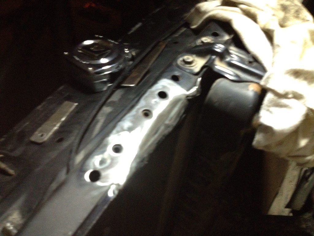

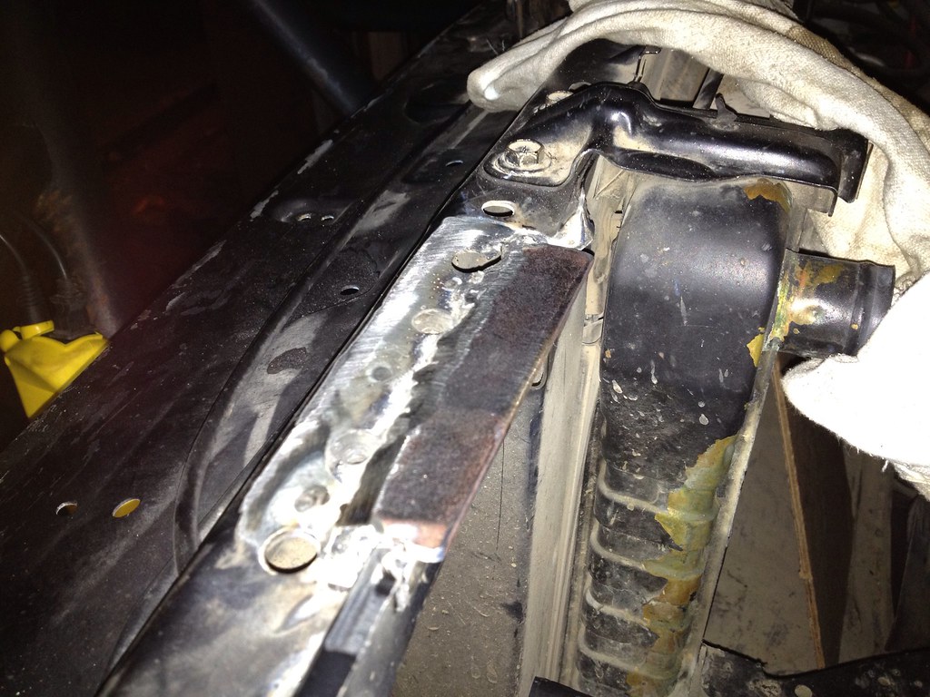

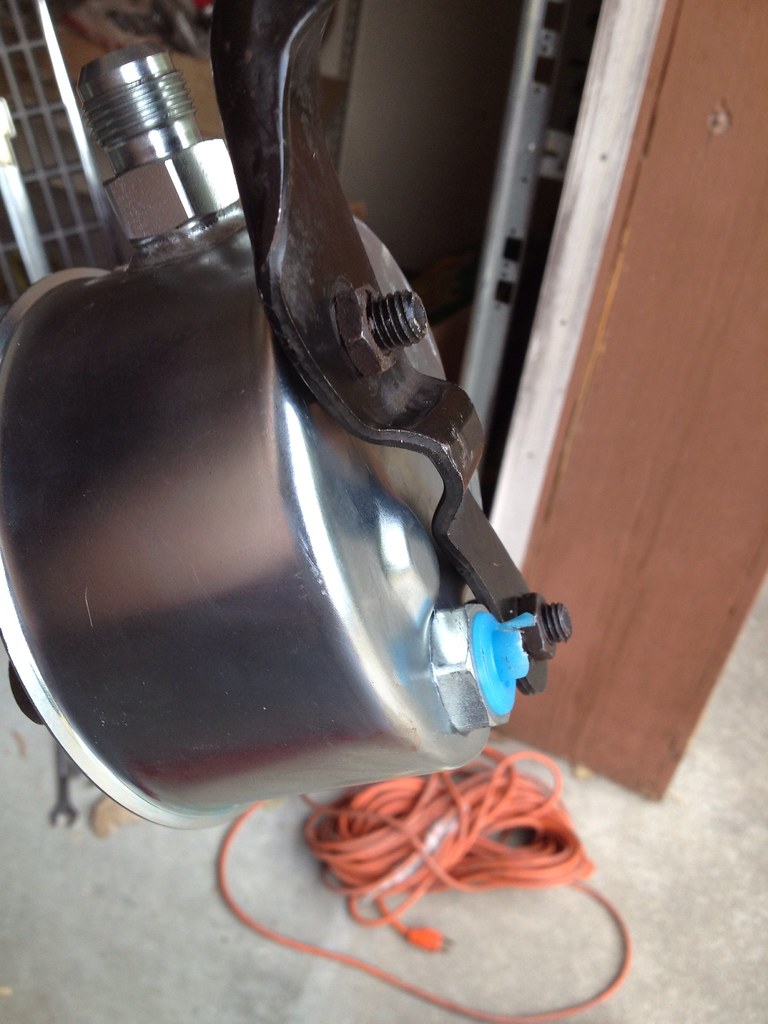

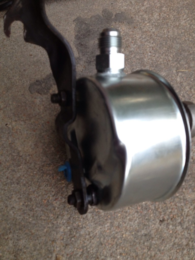

Next, I moved on to figuring out where to mount the resi. Decided on the core-support. Gave decent access to the pump and the cooler. I trimmed down the lip pointing up and hammered it down. It didn't provide much of a mounting surface so I decided to add a some strap to give a flat mounting surface.
Here's the spot prepped for welding:
And welded in:
Took the flap-disc to it to smooth it out a bit and show some paint on it.

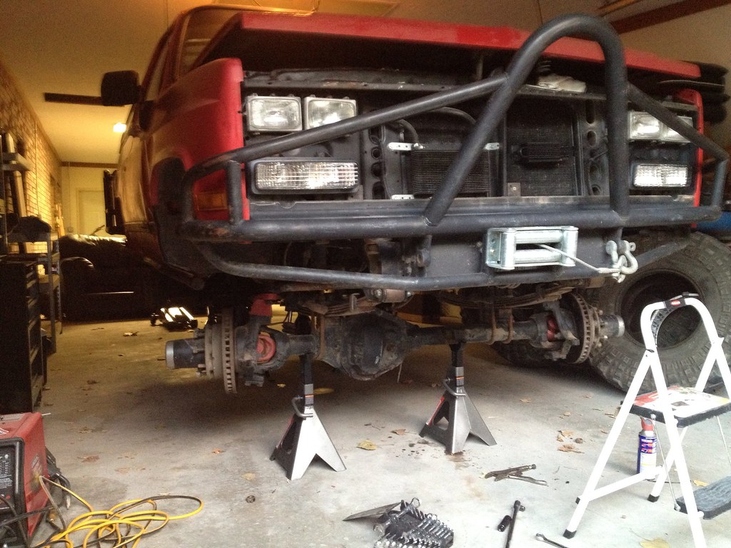

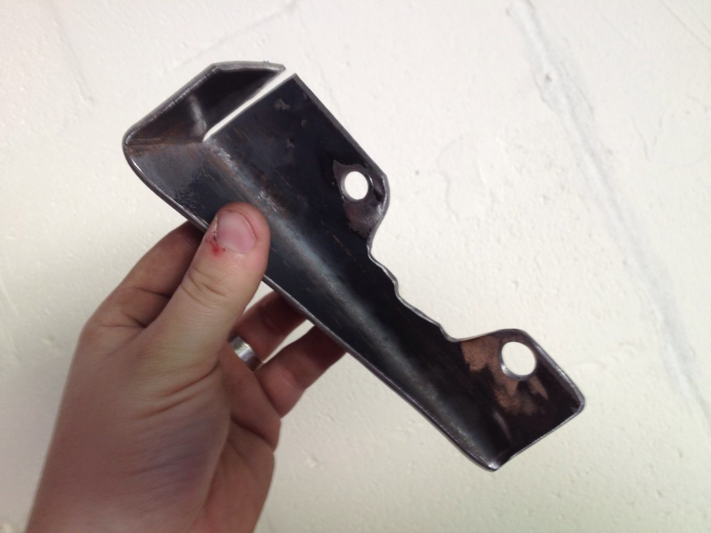

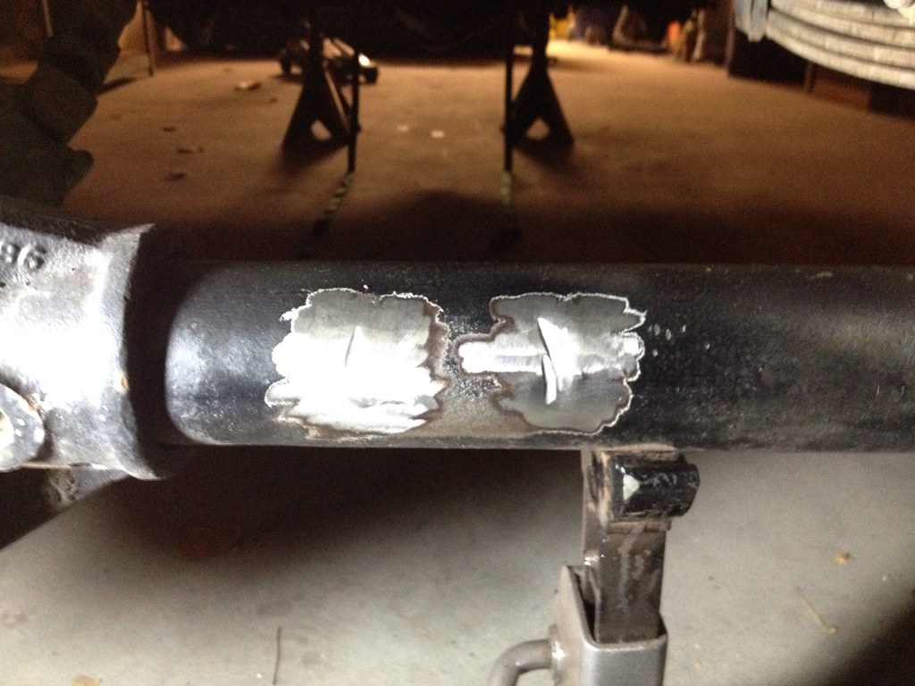

I then decided to remove the stock steering stabilizer tab from the 60:
As you can see, it left some gouges.
Didn't get the chance to spend any garage time yesterday, so that brings us to today.
Started by welding up the gouges on the axle and smoothing them out (didn't get any pics).

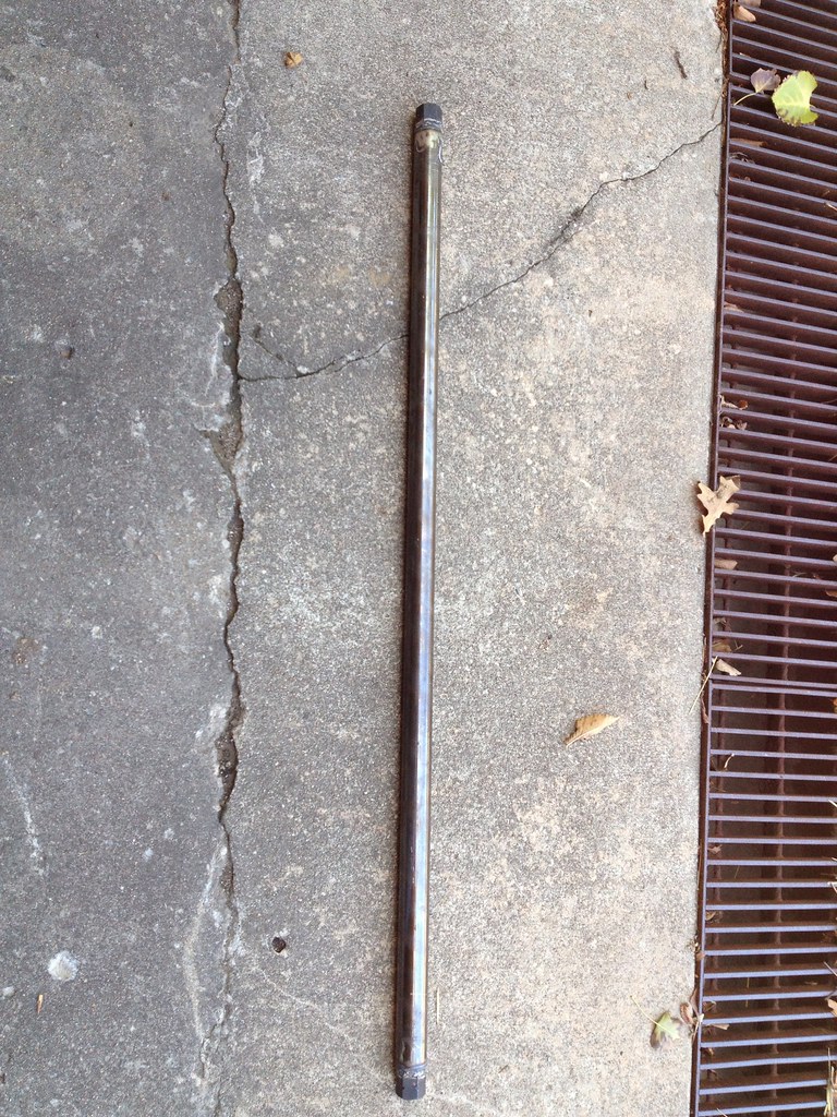

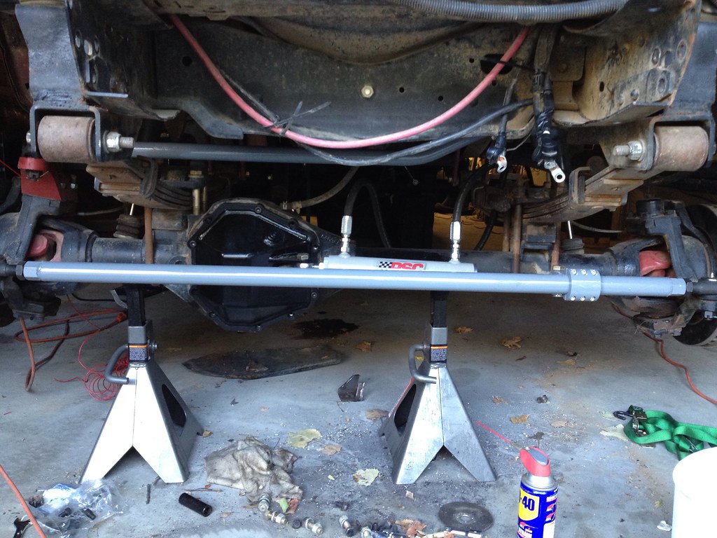

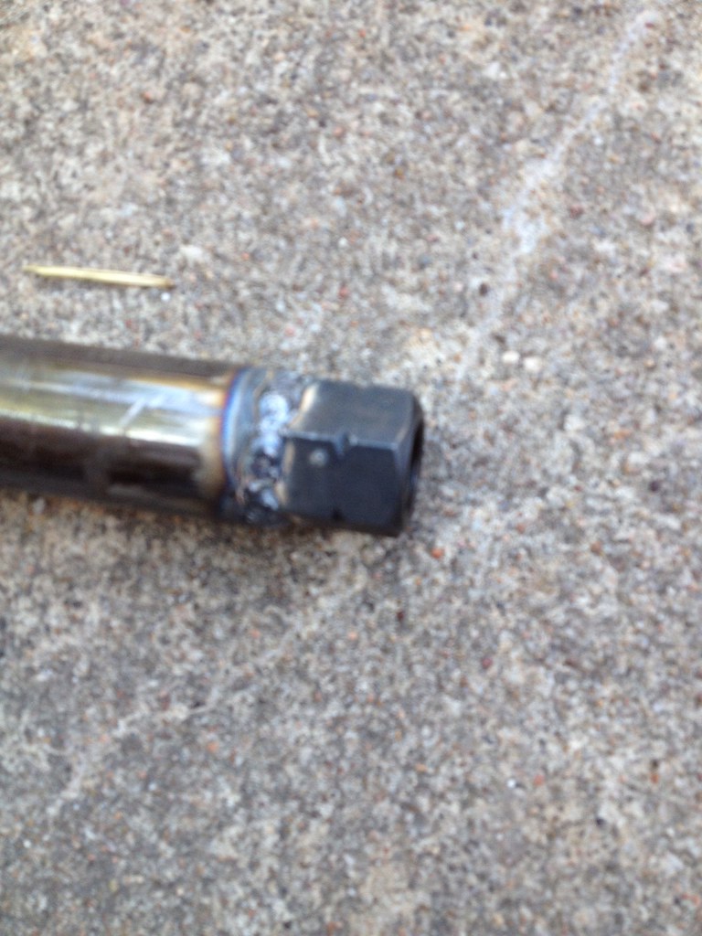

Then I measured for the new HD tie-rod and cut down the tubing and welded on the threaded ends:
Shot it with some paint shortly after.

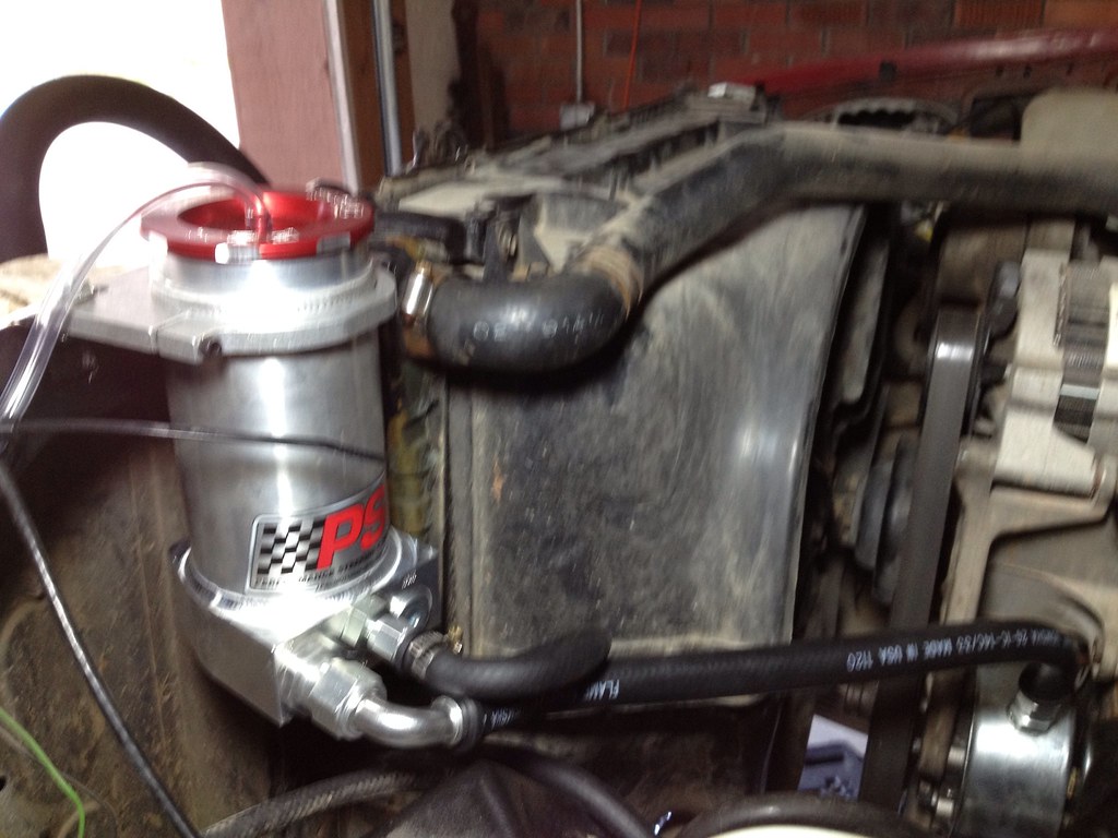

Next I mounted up the resi, and ran all the lines. I decided to go ahead and hook up the ram while I was at it.
Here's the resi mounted:
I'm not terribly happy with it, but I plan to move it once I get the engine cage built.
That pretty much get's us up to speed with where I stopped this afternoon. I started the bleeding process, but need more fluid.
This week I hope to get the tie-rod mounted up, the HD diff cover mounted and the ram mounted. Also, either during the week or next weekend, I will probably go pick up my tires and rims. I'm pretty pumped.

Got the new tie rod on. Started to mock up the assist ram but haven't gotten it finished.

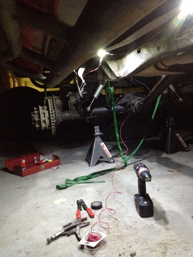

I've slow been working on installing my rock lights (very crucial to daily driving). I have one side almost done with one side. I've been testing them as I go...
Except for the small light coming through the windows in the background, all the light is from the rock lights.

Got the hydro assist finished up and mounted:
Still need to secure the hoses going to the ram.

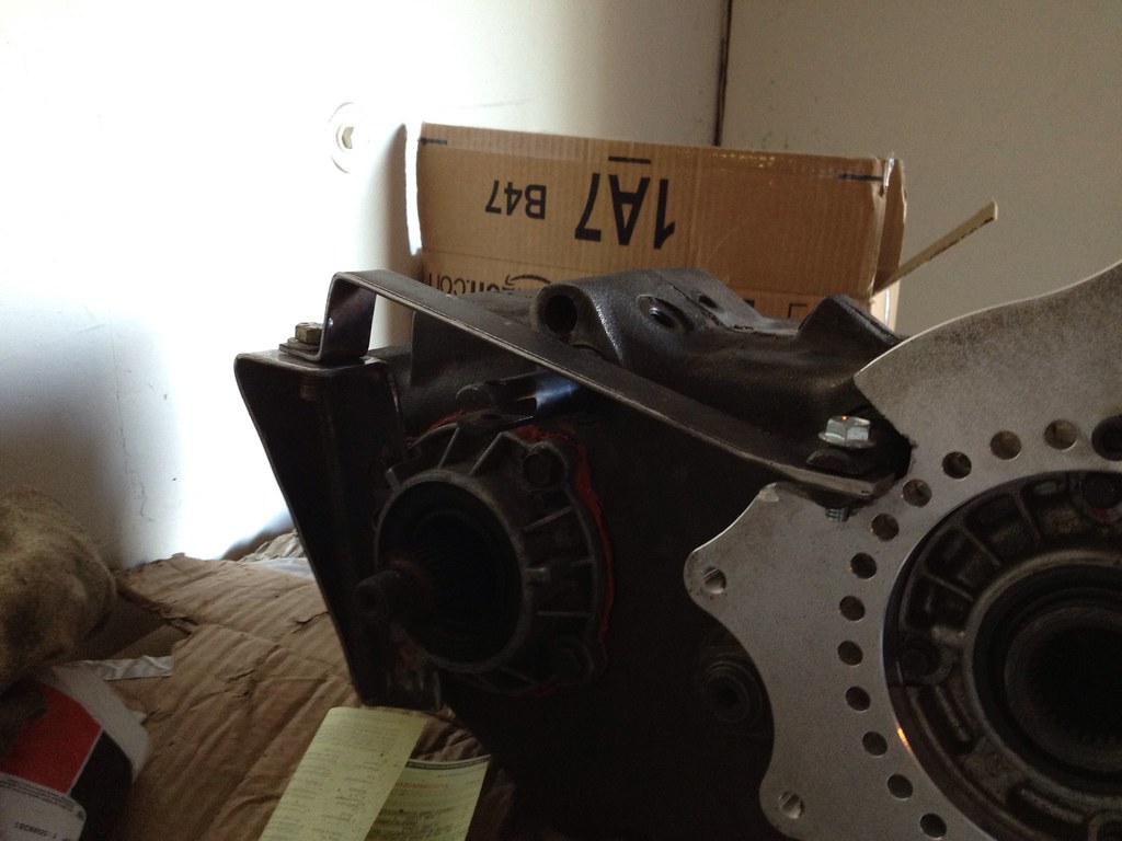

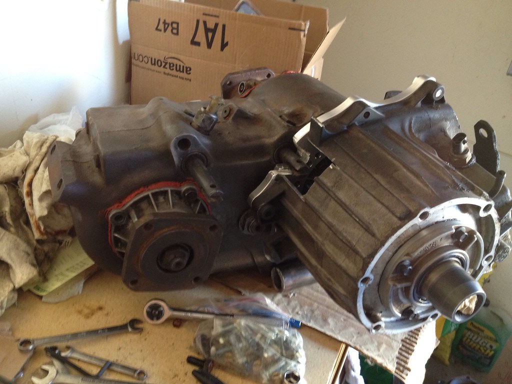

Made a little progress with the doubler. Notched the adapter plate and the 241. Then I test fit it all.
I took a bit too much out of the 241, but it should be fixable when the notch is welded up.

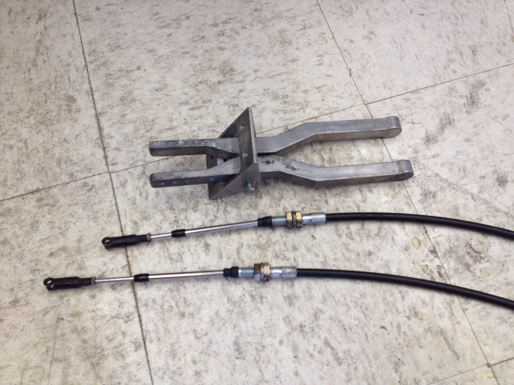

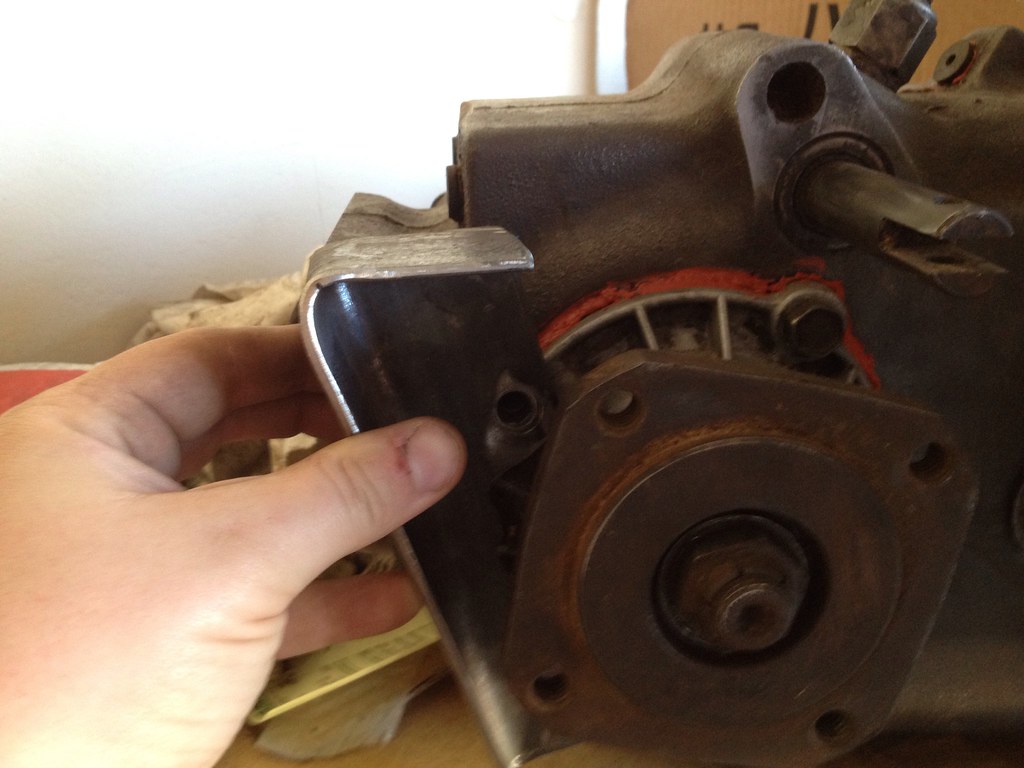

I started working on the shift linkage. I fabbed this bracket for shifter arms to pivot from (I guess that's how to describe it).
I then fabbed up this bracket:
I'm pretty please with how it's coming along.

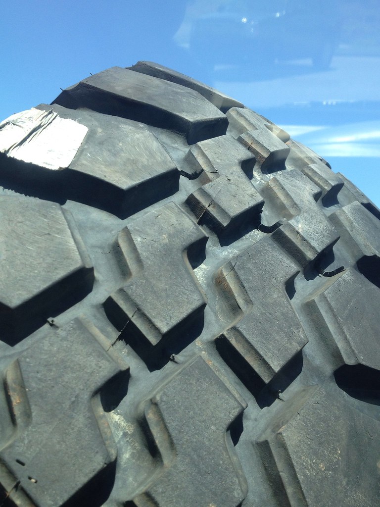

Over Labor Day I went and picked up some new 12 bolt H1s and some 37" BFG Bajas from Kyle (swirvin21 on pirate). Order up some new centers and rock rings for them from GLO. Still waiting on those.
Here's the tread on the tires:
