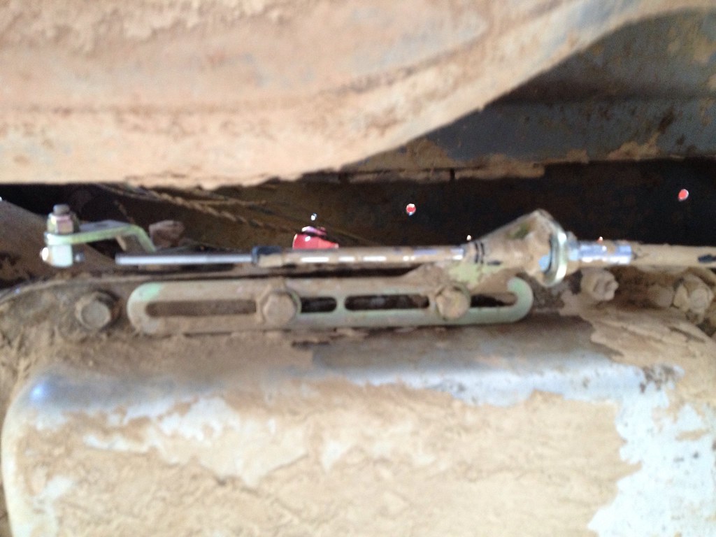

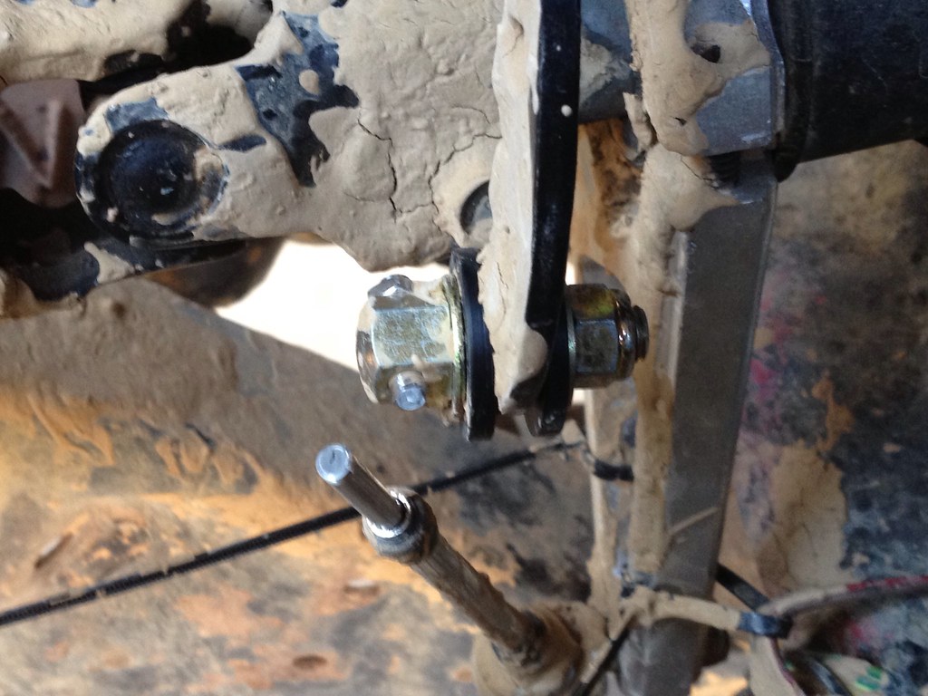

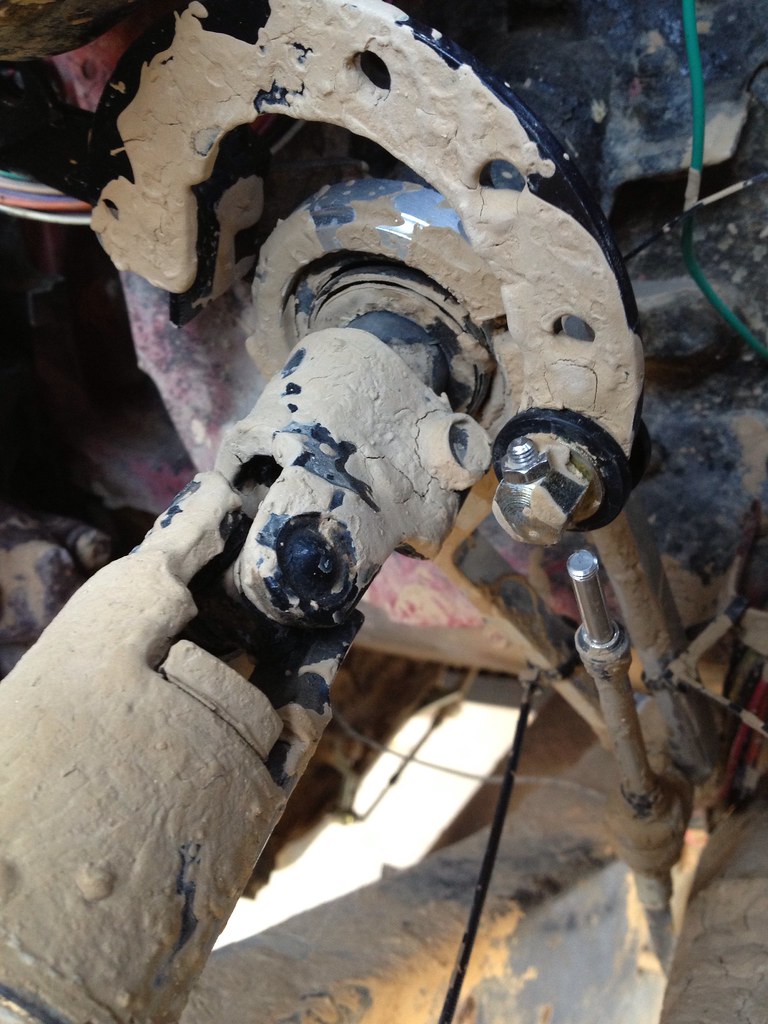

Went wheeling last weekend.

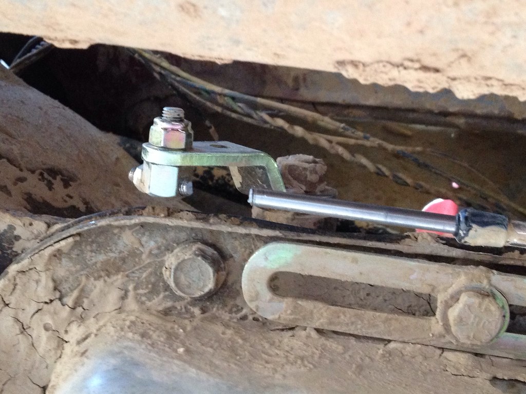

Fought the shift linkage the whole time.
I drove it Monday and went to back into my parking spot and the shift linkage let go.
Yes, both ends are broken...
I called Lokar about it since it had only been hooked up for a week or two. Turns out part of it was my fault, as I had the pivot point tightened too much.
Since both ends are broken, Lokar is replacing it on warranty. I have my B&M Mega shifter back in to keep it moble.
I'll upload my pics for last weekend one of these days...

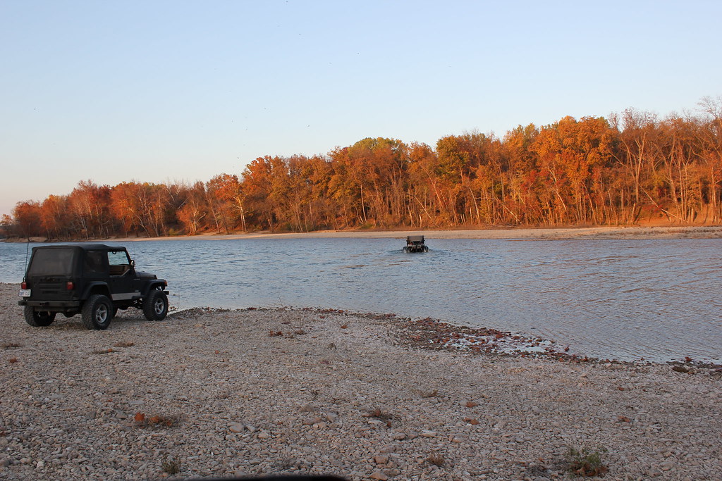

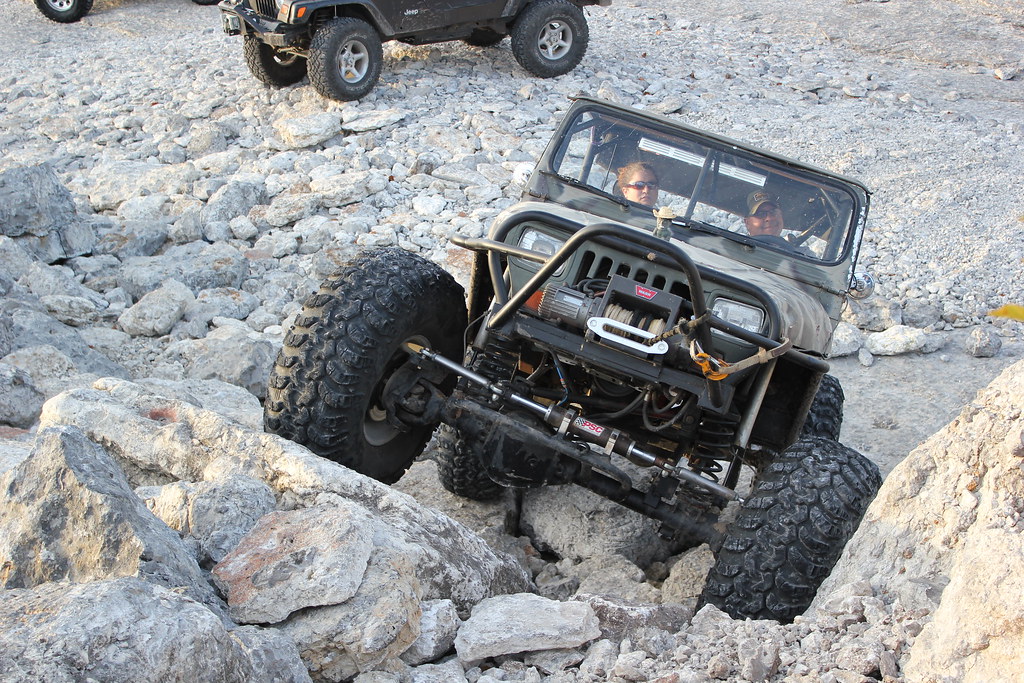

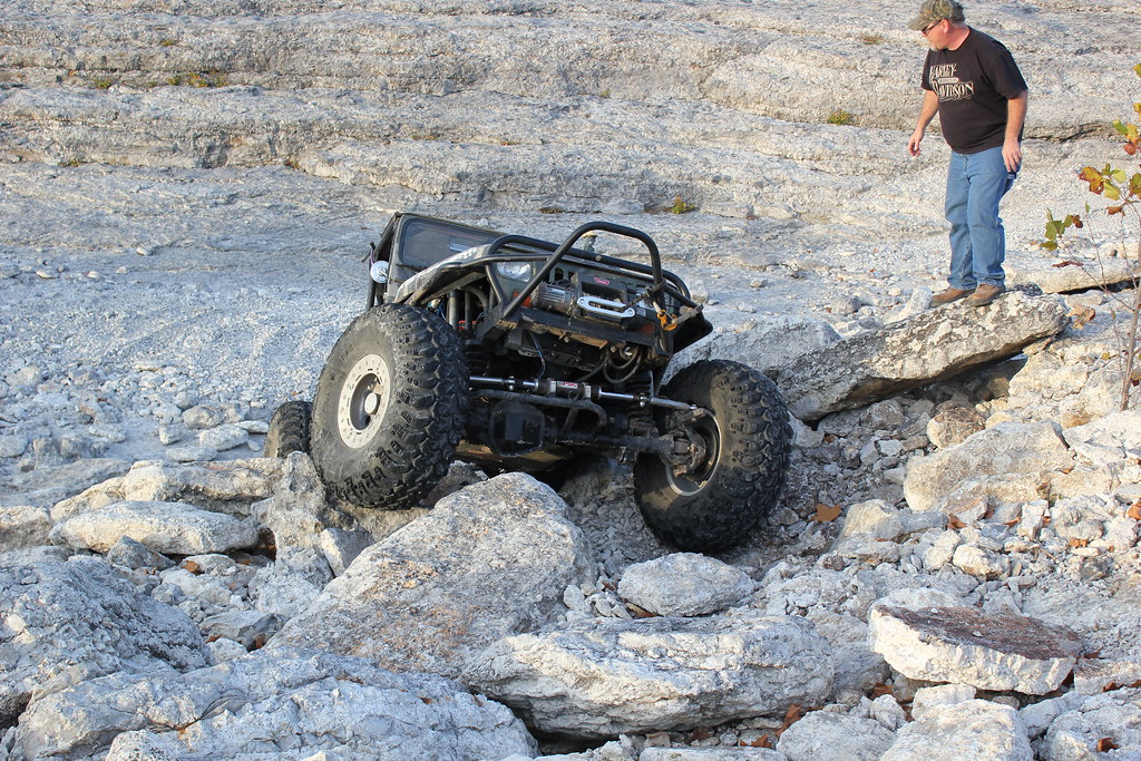

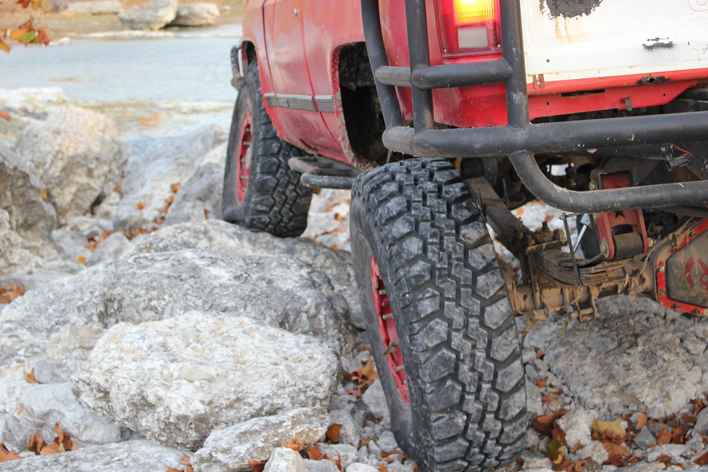

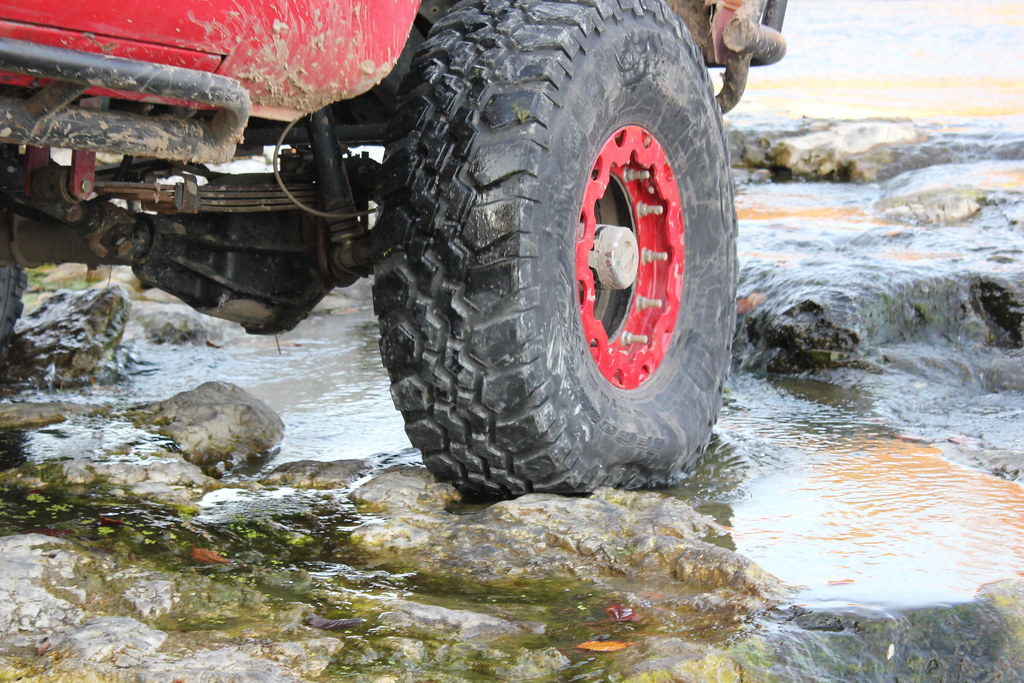

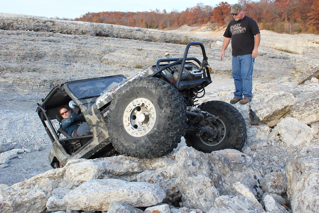

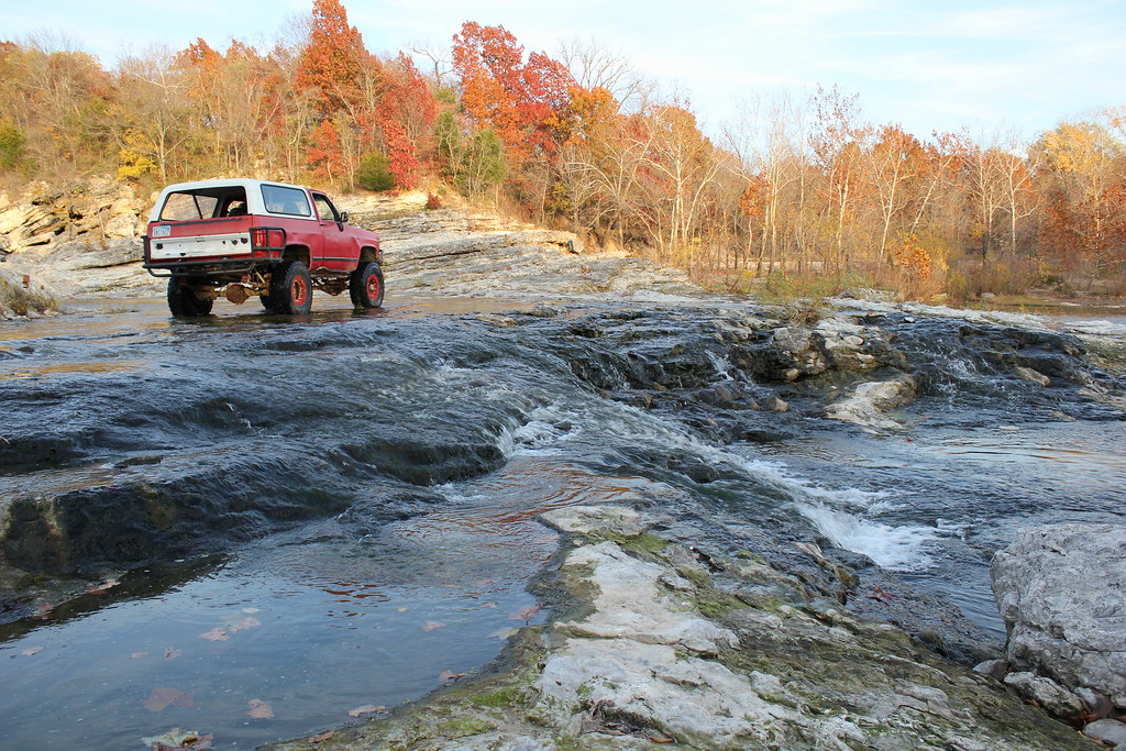

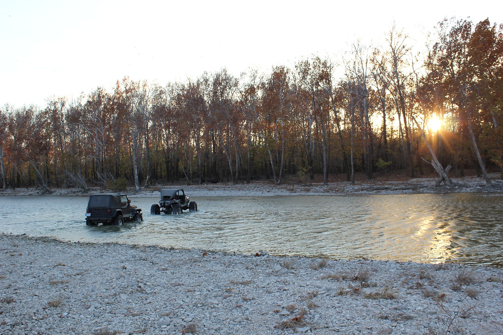

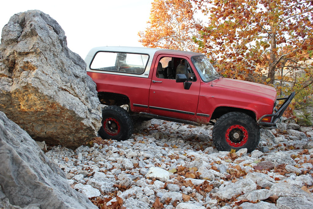

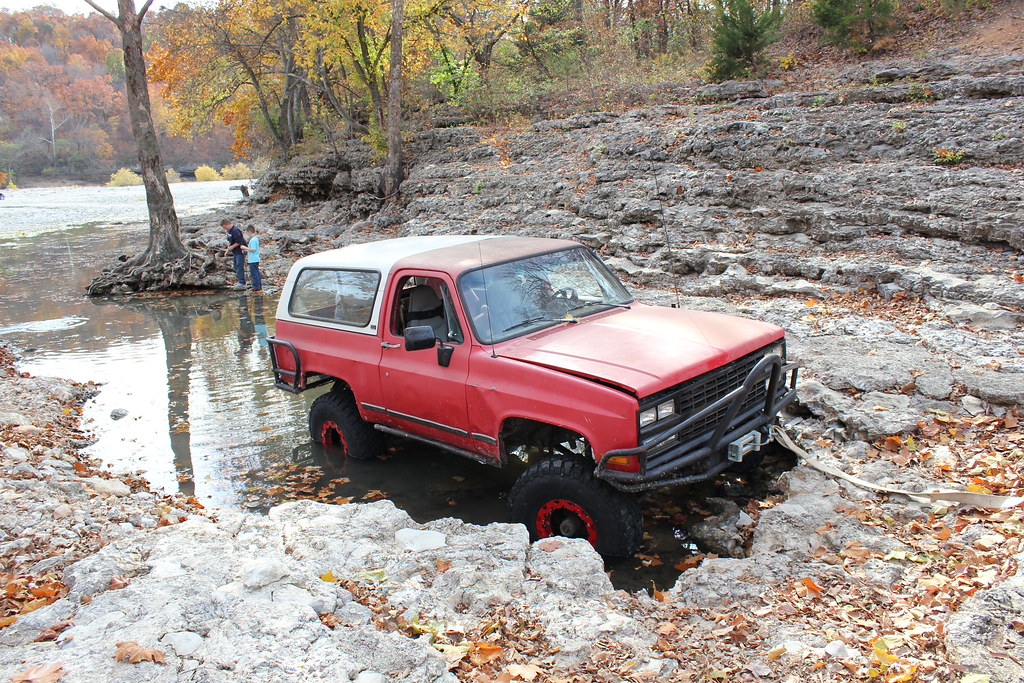

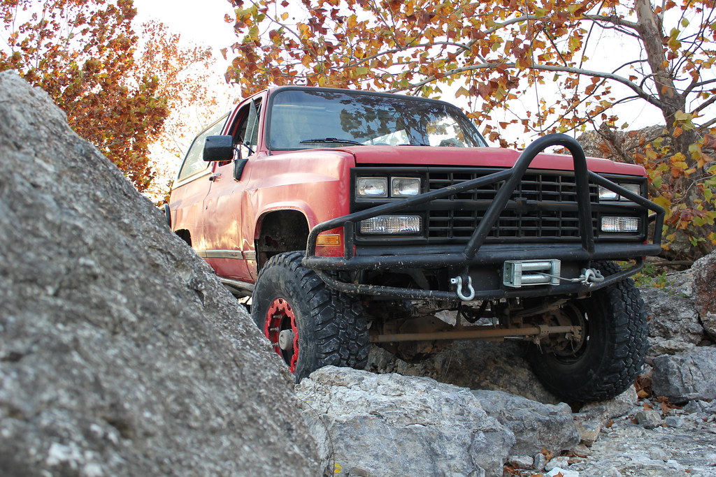

Finally got pictures uploaded from my last wheeling trip. Nothing terribly exciting but I thought I'd share.
Some others:

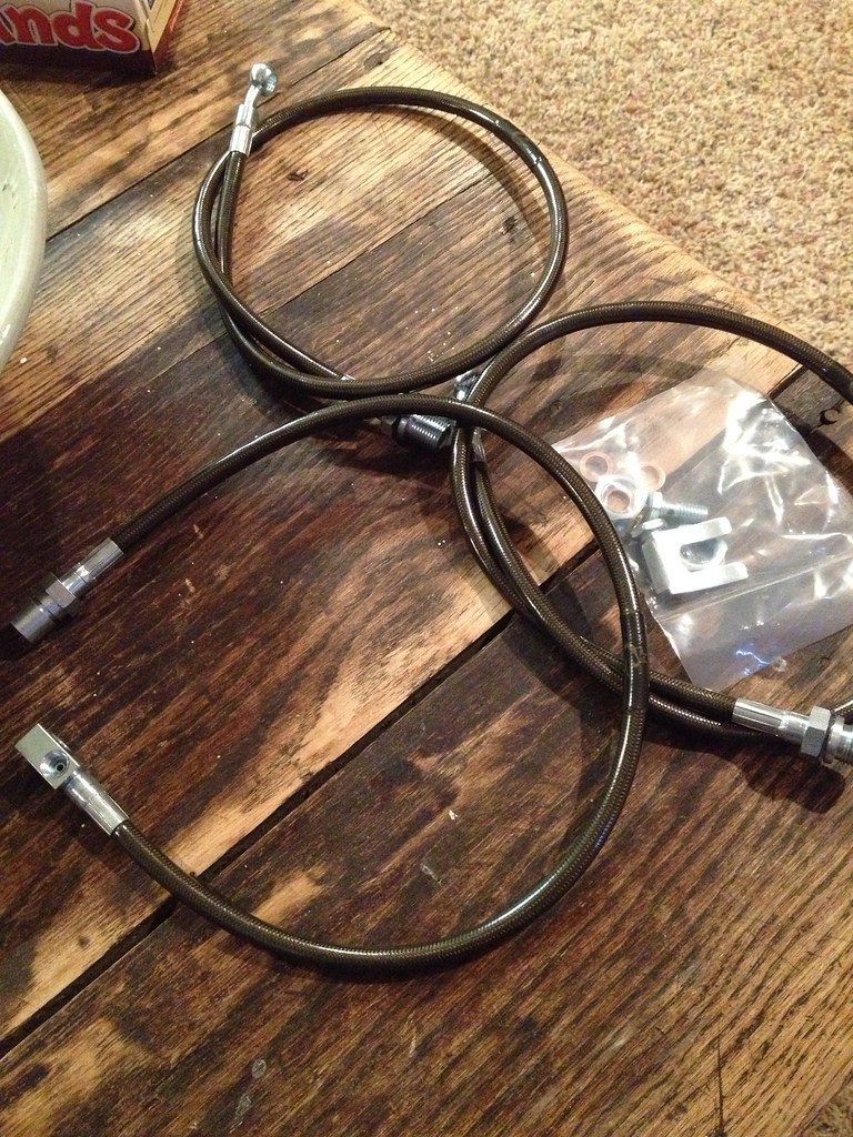

The rear brake line has been giving me fits for a while (probably from being pulled tight over and over) so I decided to upgrade:
Got them bled today. Going to drive it this week to get ready for another wheeling trip next Saturday.

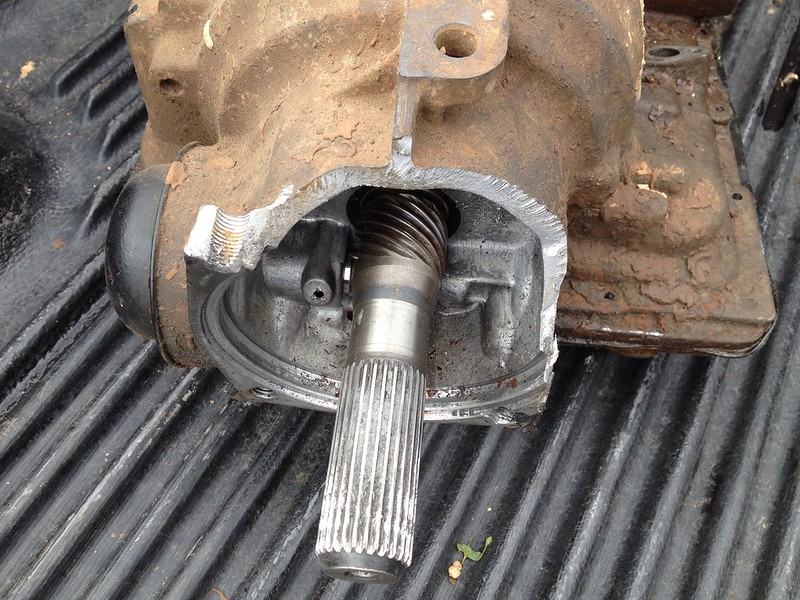

I parked it to register and wait on Mike (oakknight) to get there. After about 45 minutes or so, we headed out to the trails. I noticed on the way that the transmission didn't really want to shift out of first. When it finally did, it was a hard shift. I didn't really think anything of it and went on.

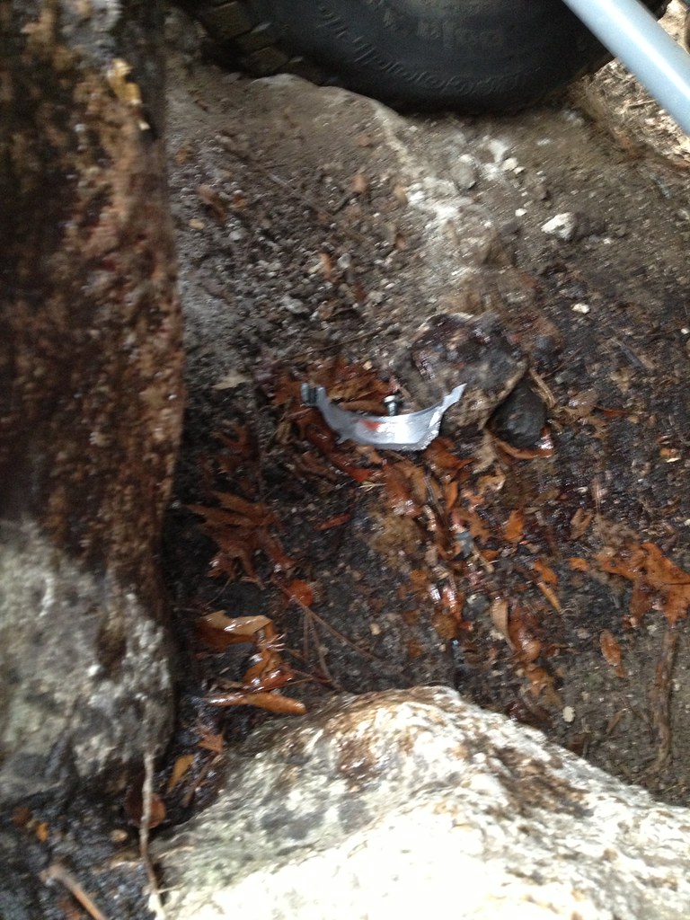

I came up to the first obstacle and was trying it. Mike was spotting me. As I backed up to get a bump on the ledge, Mike noticed a LOT of tranny fluid on the ground. At the same time, I head some very strange noises coming from under the rig.
I got out to look and found this:
That's a piece of my transmission housing that broke off...
We winched it out and pulled it into the parking lot. I didn't look that close at the damage out of frustration, but the transfer case was just hanging there, being held up the by the drive shafts. After further inspection of the piece that was on the ground, it looks like it's been cracked for a bit and finally just gave. Since the bolt was still in the piece, that means the adapter broke, too.
I'm guessing the biggest culprit is the bent frame. The front, drivers side is bent up, which would put stress on the whole drivetrain.

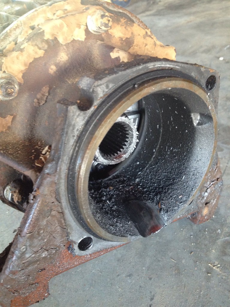

No real update. I finally uploaded a pic I took a while back of the trans/tcase adapter. You can see where the trans output shaft rubbed on the adapter while we limped it off the trail. You can also see where one of the bolt hole broke.
