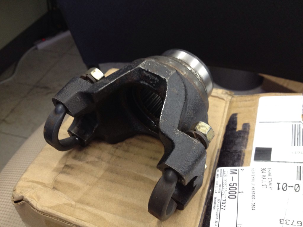

I received this earlier this week. 1410 ujoint 14 bolt yoke:

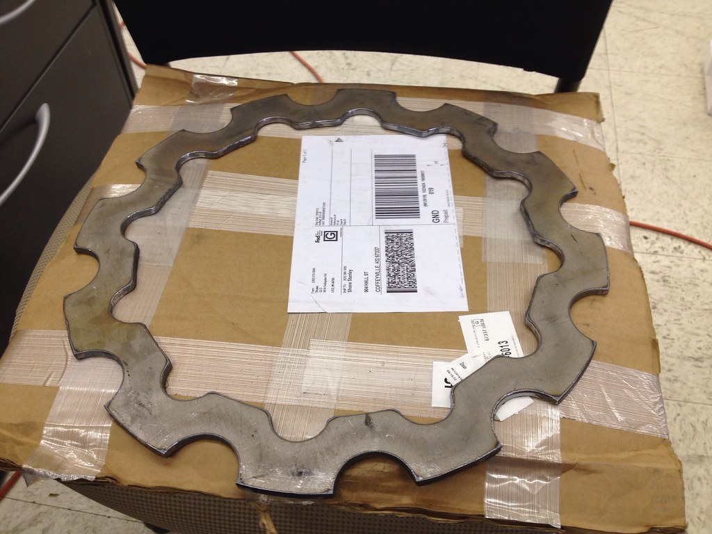

And these today. Wheel centers and rock rings from GLO:
I hope to get started on the wheels this weekend.

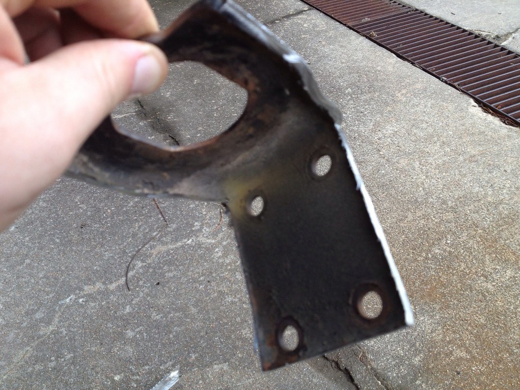

Got the body mount/spring hangers removed.

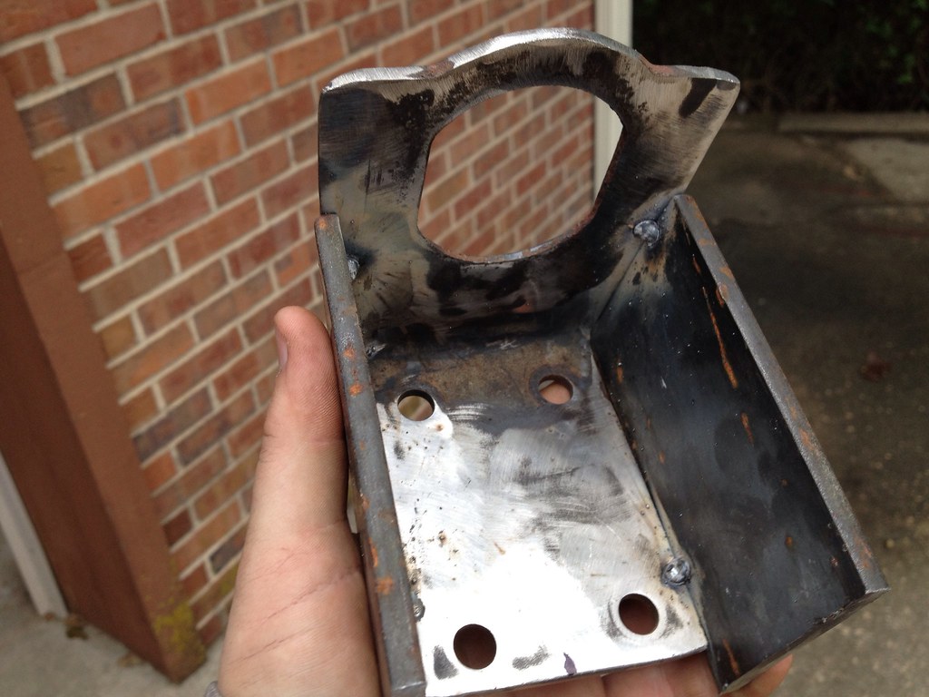

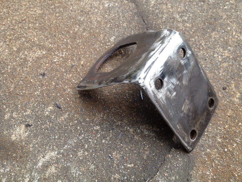

I originally welded on some of Kert's hangers after I removed the stock hangers when I went to 52s. I also used zero-rates to push the axle another 1.5" forward. I"m wanting to lower it some, so I'm going to rework the hangers to keep the axle in the same location without the use of zero-rates.

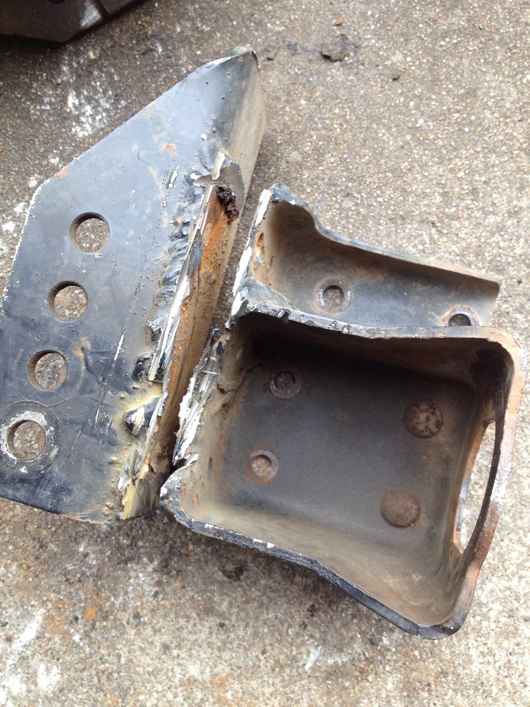

The hangers:

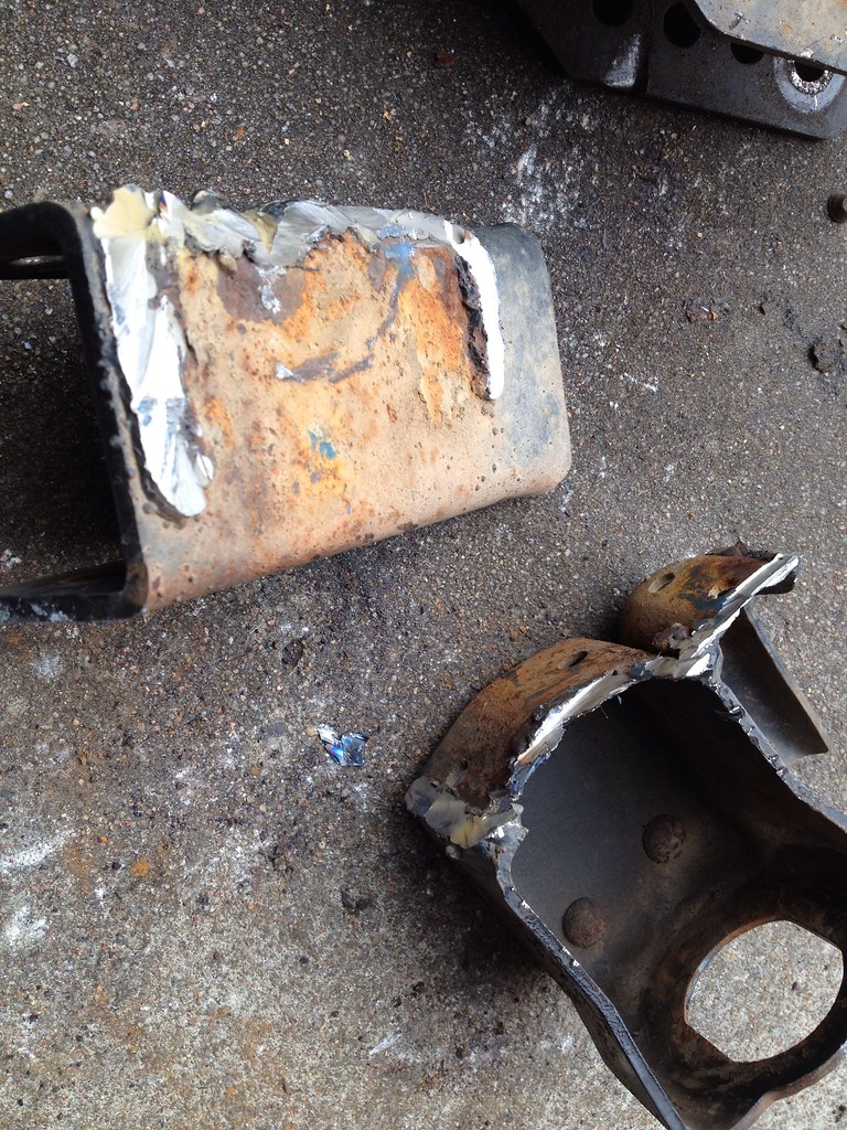

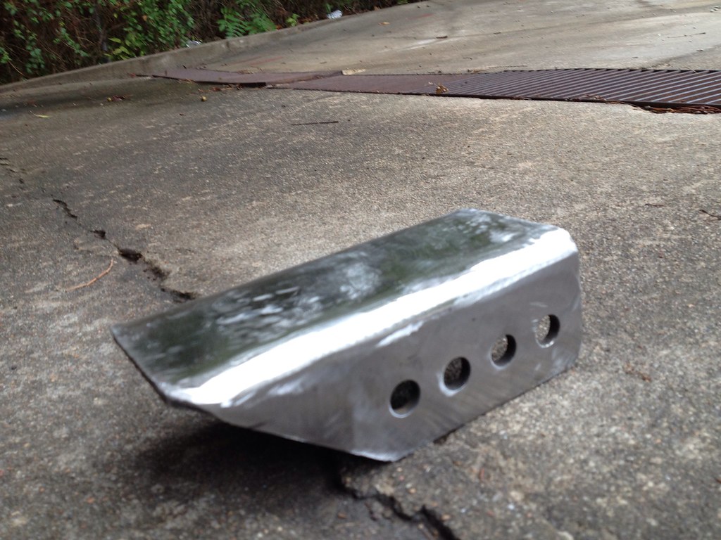

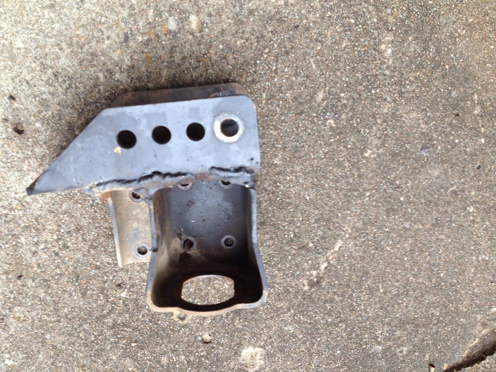

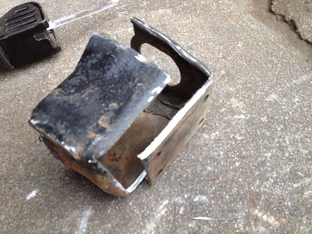

And cut apart to reuse the hangers:

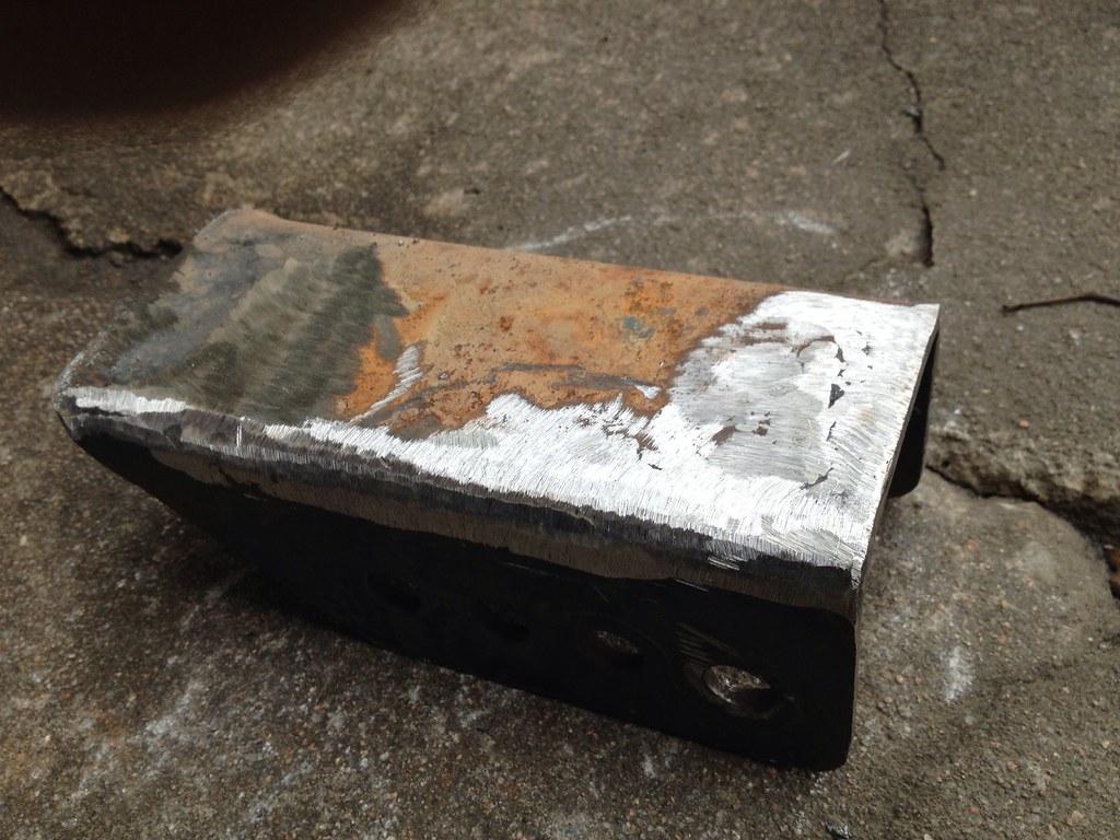

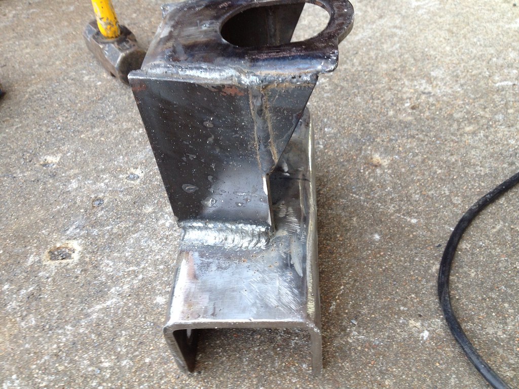

Welds ground:
And flap disk'd:

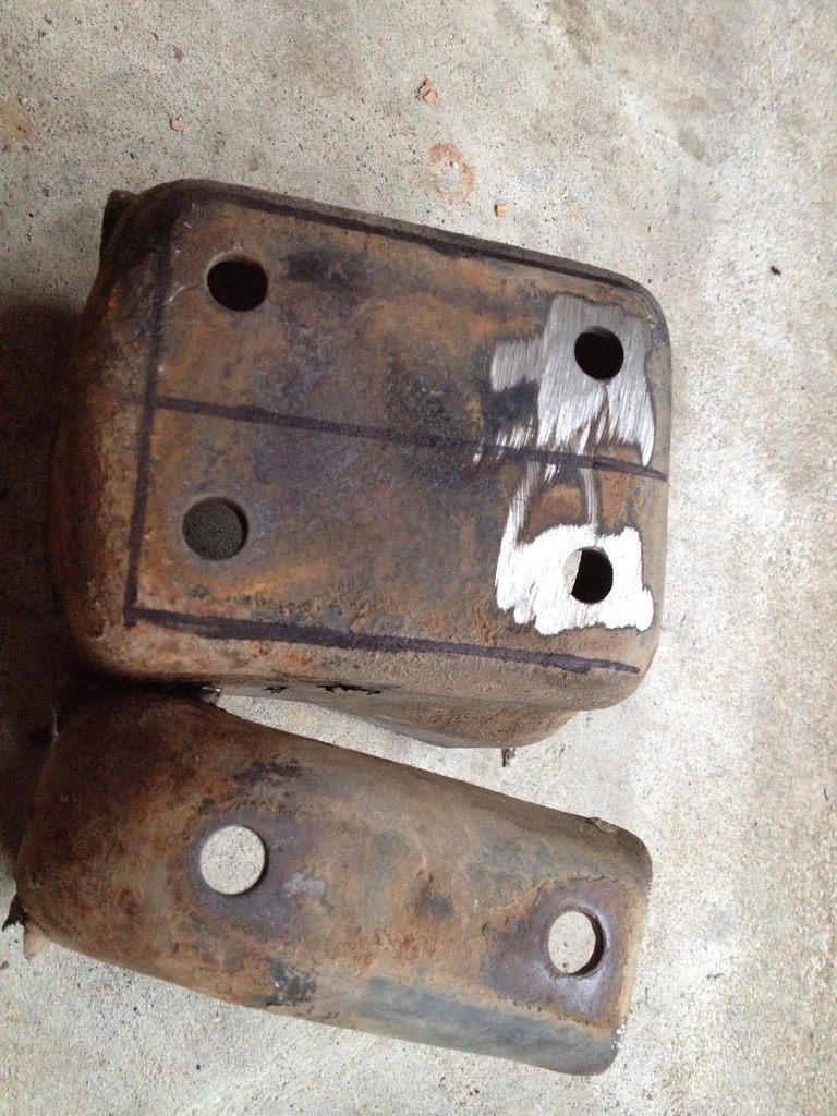

Started planning out how I'm going to cut the body mount:

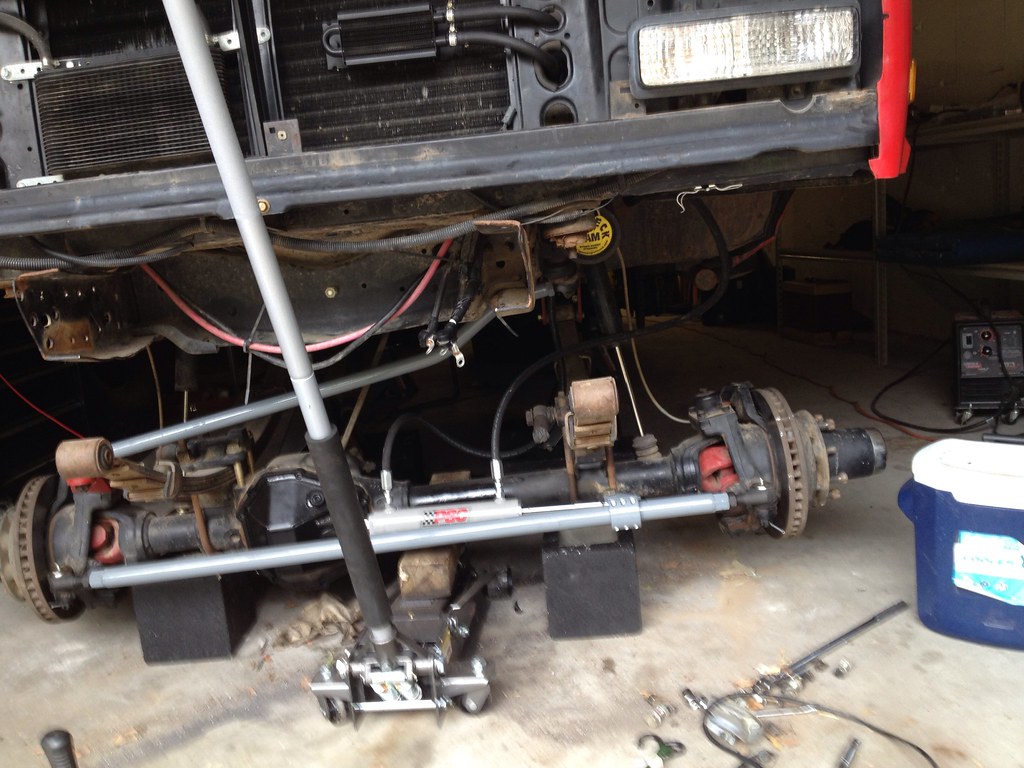

Did you get the steering all worked out. I have that set up on mine if you have any questions about it. It works great.
So far I've only been able to cycle the steering with it on jack stands, but everything seems good. Thanks for asking.

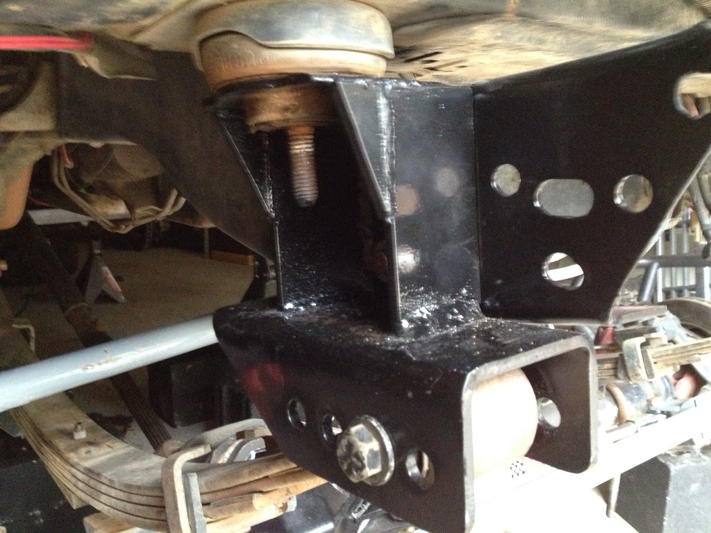

I've gotten a little more done over the past couple weeks.

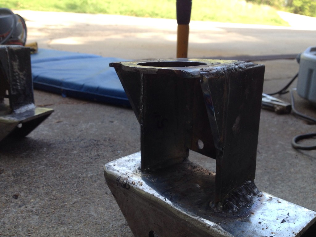

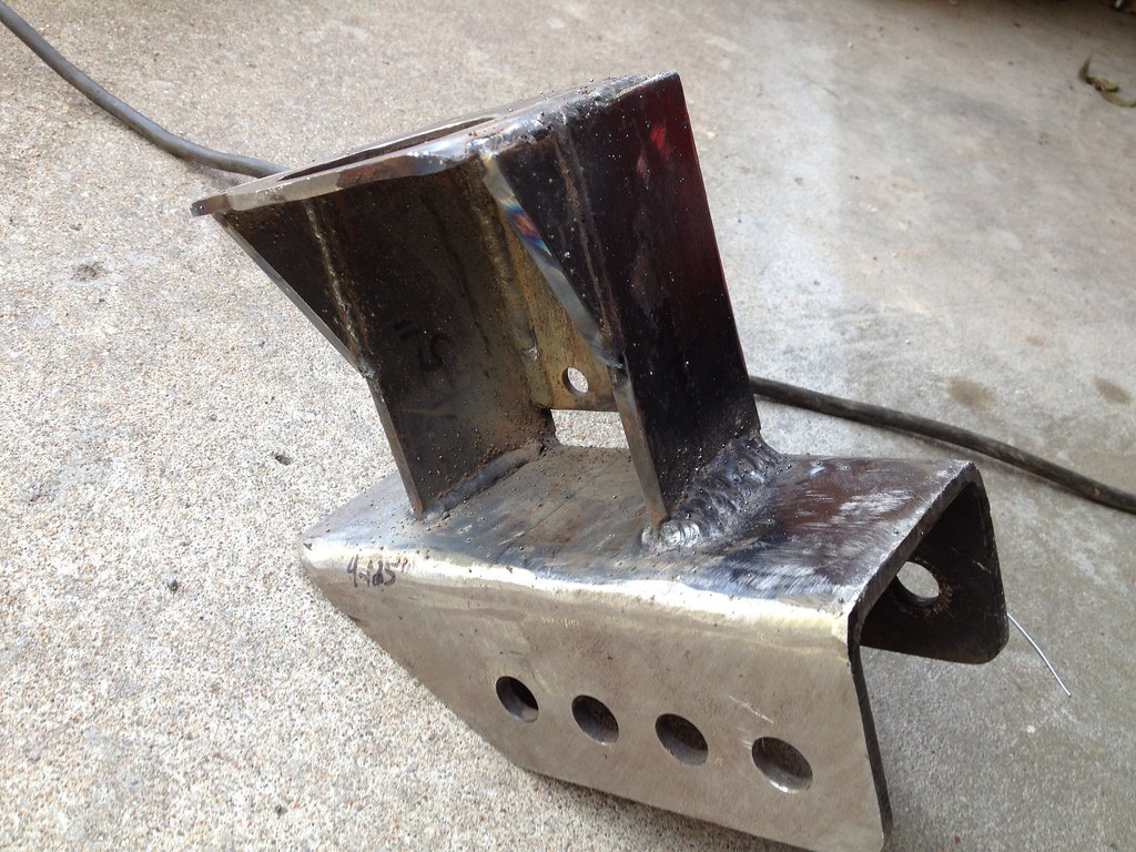

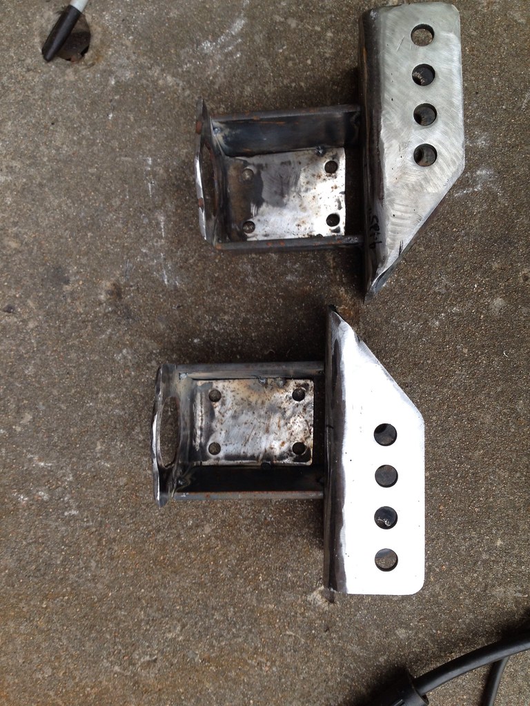

Got the hangers fully welded and added some gussets.
Got some paint on them and bolted up one side:

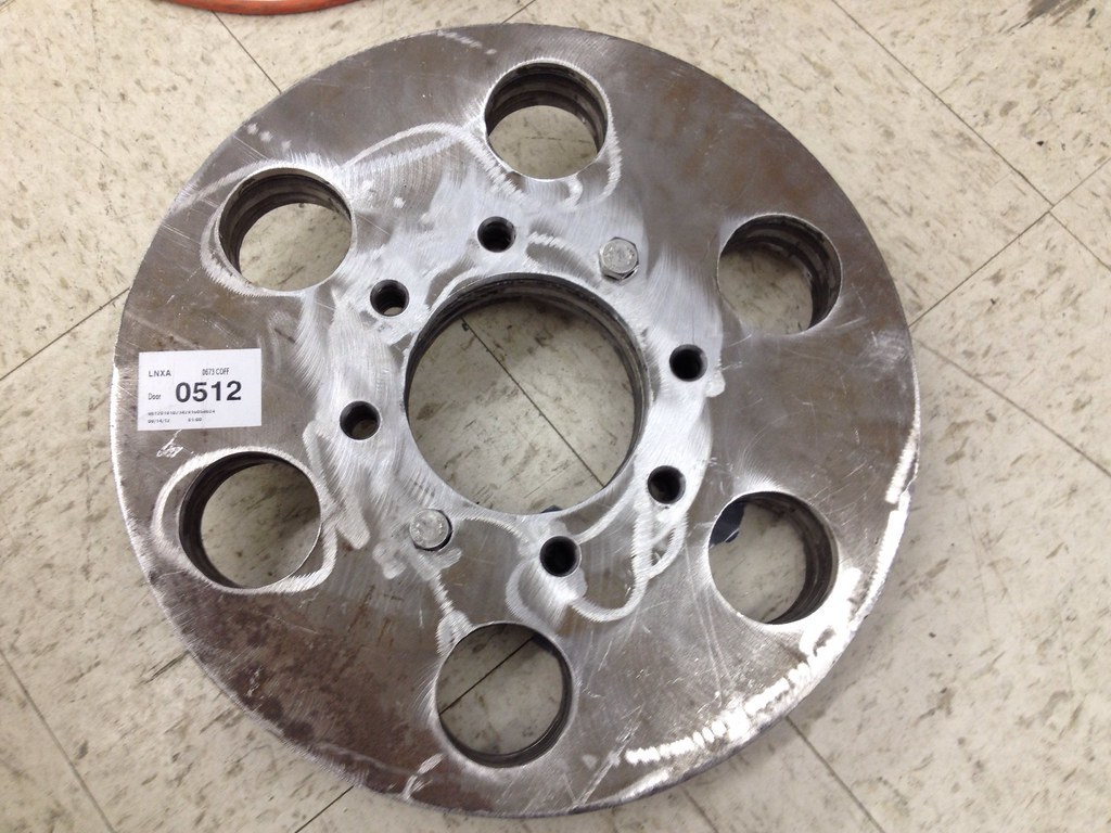

Finally got my wheels welded up. Still need to do some grinding on them before paint.

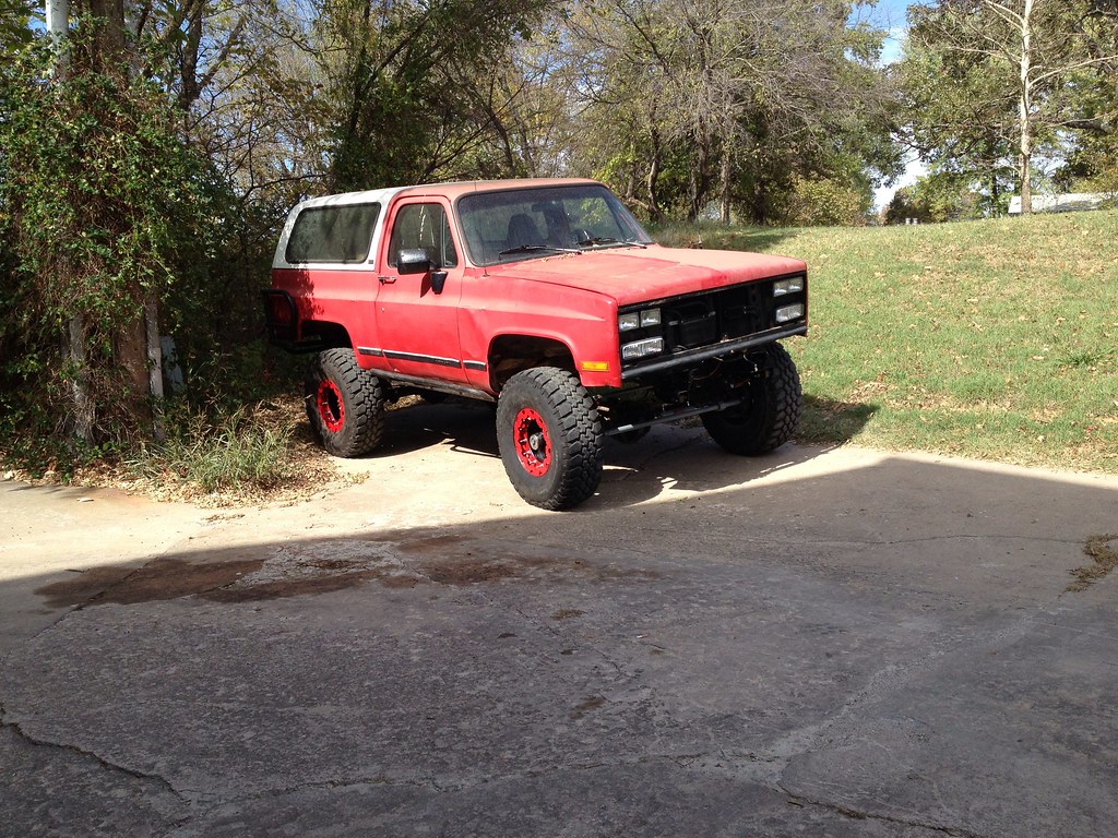

Finally made it out of the garage a week or so ago.

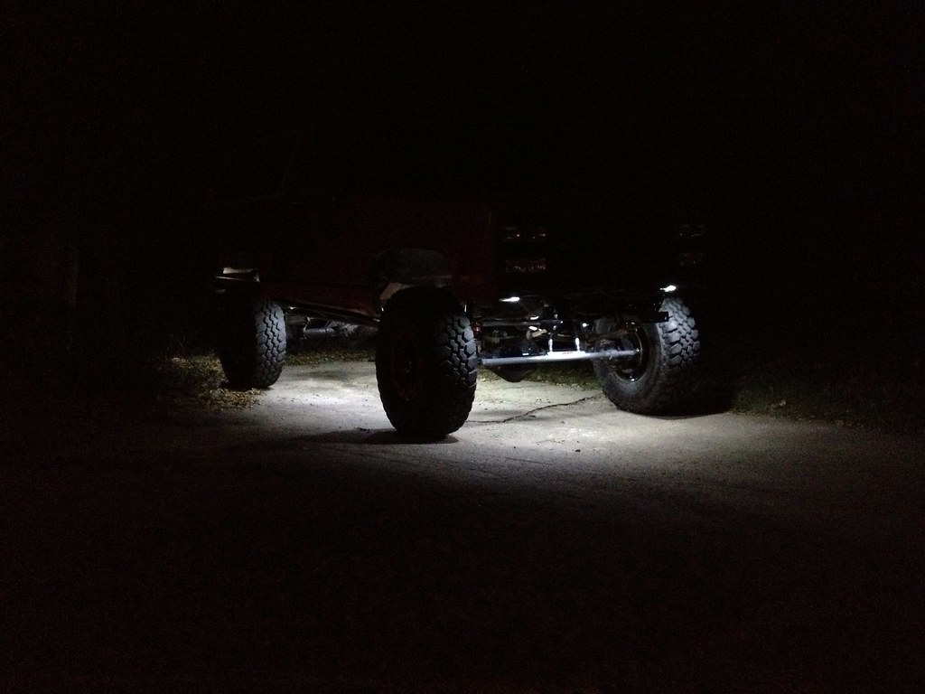

I got the rock lights finished up last night.

:eek1: Those little LEDs put out that much light!?! That's sweet! How meany lights do you have under there?
There are 4 LEDs per pod and there are 15 pods total.
I'm very satisfied with them. They put out a lot of light.
