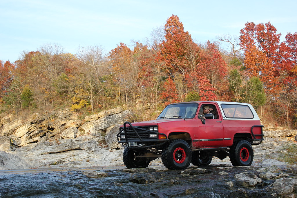

I recently sold my '91 Blazer to Nick (revvin7) up in Nebraska. I sold it to help pay down on our debt and to get something that would work better as a daily driver and wheeler, along with better access to the back seat, since we have a young one in a car seat.
Here's a pic of the blazer:

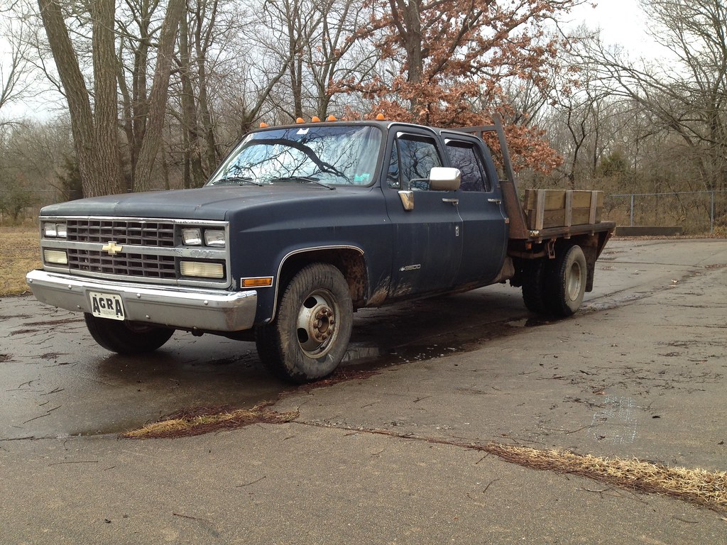

I've been casually cruising Craigslist for the last couple months looking for crew cabs. Specifically, a newer one that had fuel injection. And better yet, a '91 with a 4l80e. There were three to four '91's within driving distance of me, all 2wd. All but one were out of my price range.
After two trips, two hours away, I brought home this gem:

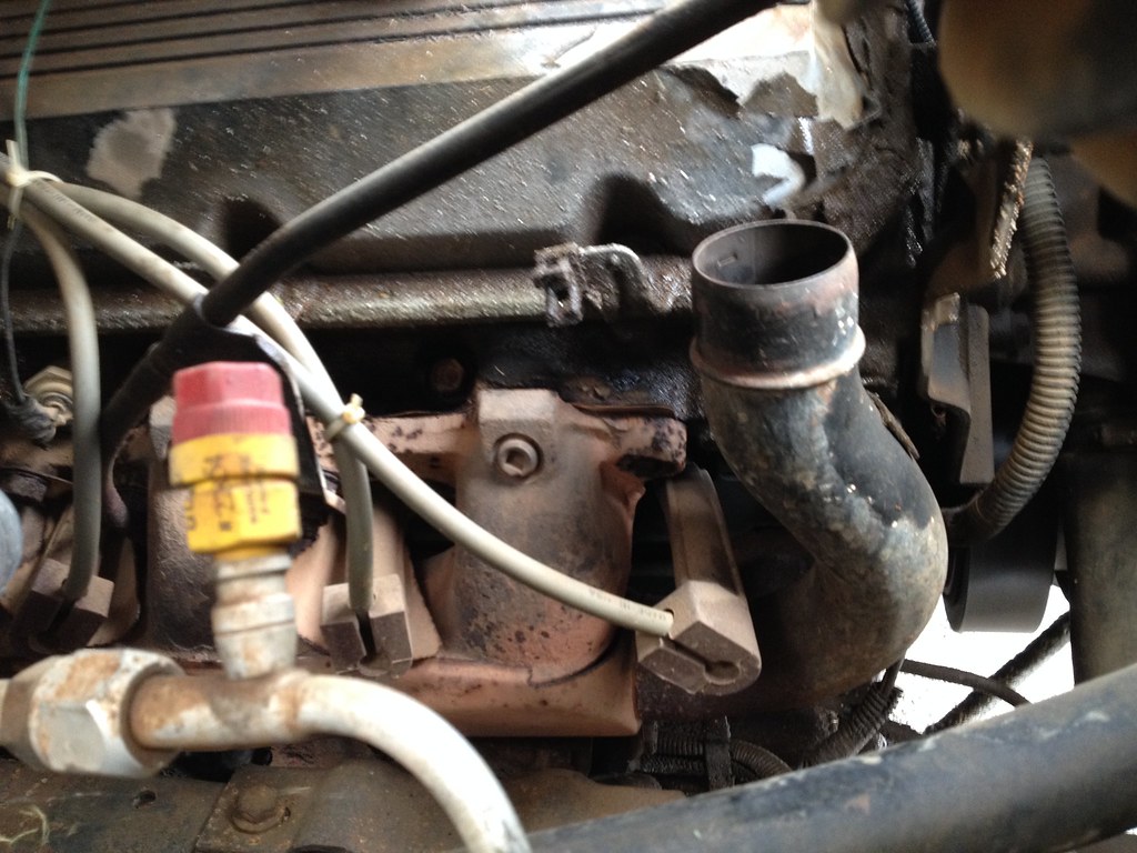

I found the exhaust leak as I was taking these pics. Looks like a broken stud/bolt:

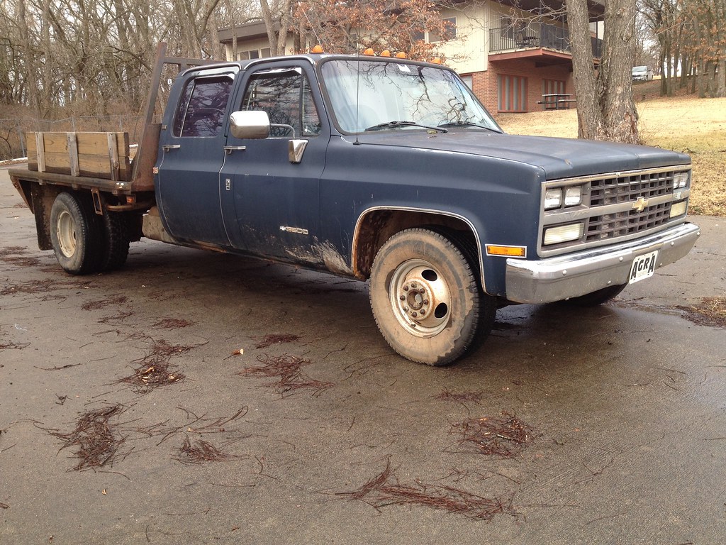

And my reasons for going for a 1-ton:
1. stronger frame
2. 454
3. stronger transmission (this one is supposed to have been recently rebuilt)
3. hydroboost
4. dana 70 rear axle (so I can run stock H1 beadlocks)

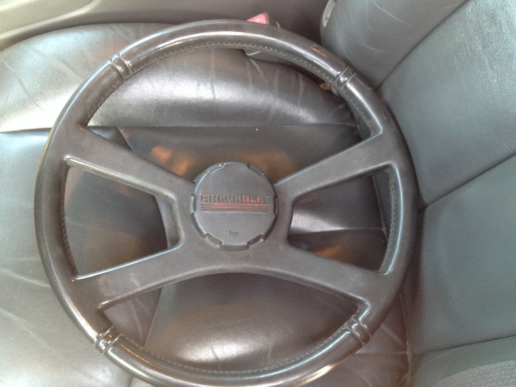

I made my first purchase for the crew cab...
Anyone have a good link to steering wheel removal and installation? I haven't done any searching yet, but thought I would ask.
There are a couple tools required. A steering wheel puller, and lock plate compressor tool. Don't even bother if you don't have those tools. You can conceivably make them, but they are cheap enough to buy and most auto parts stores stock them.
I've seen this type of wheel many times but what do they actually fit? Trucks, camaros, what years? I like them. Good purchase
