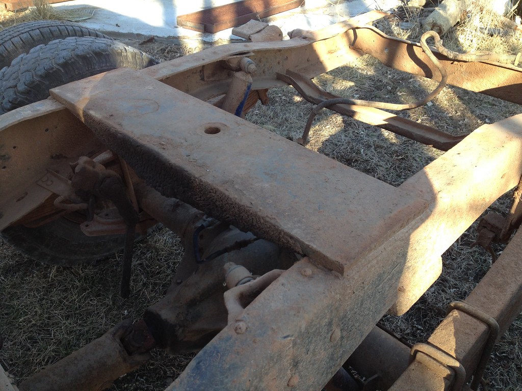

There's a gooseneck plate welded to the frame:

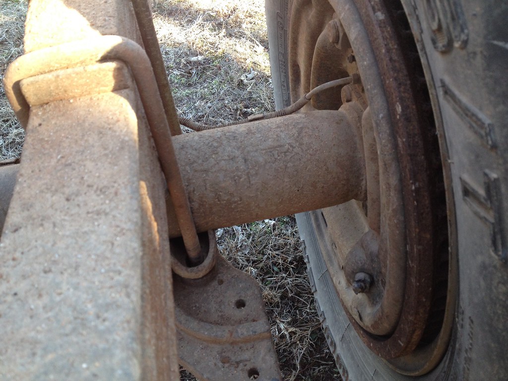

It looks like the rear axle is front a junk yard. I noticed the ubolts looked kind of new. I noticed after the bed was off that it looks like the ebrake had been torched off:
That makes sense, since the speedo was reading fast, like it came with deeper gears.

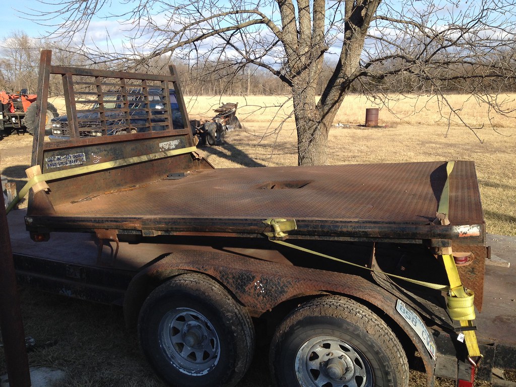

The bed loaded up:

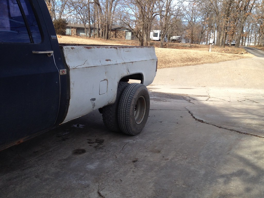

The next day I took the flatbed and traded it for a regular bed, a set of 4 doors, some front fenders and some 14 bolt srw hubs. They weren't as nice as I had hoped, but it was a straight across trade so no money out of my pocket, besides fuel. This past weekend I got the bed installed despite there being a layer of ice on the ground, which is why I didn't get any pics.

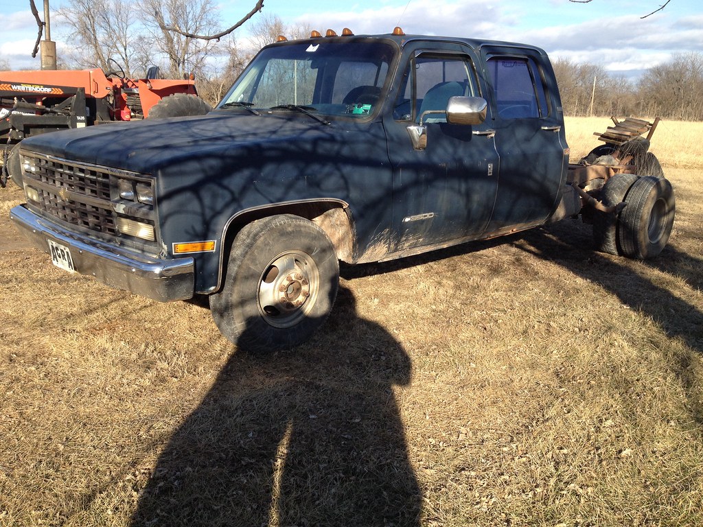

Took these today. Still rocking the duals:

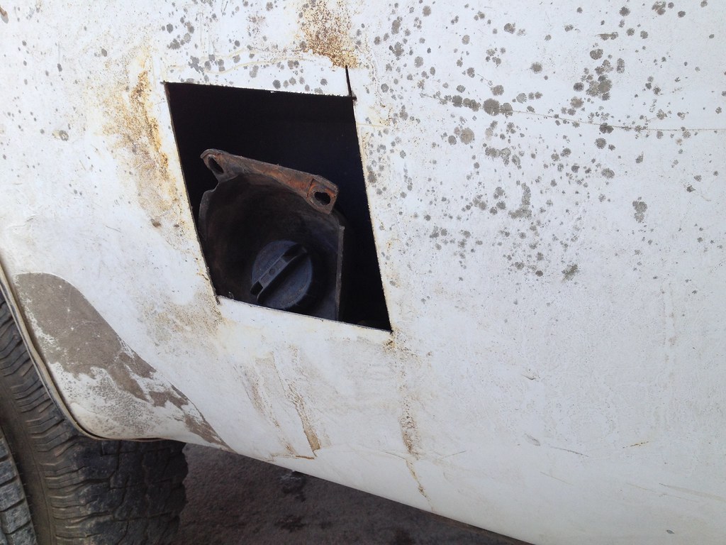

Not a dual tank bed and the known working tank is on the side without a fuel door? No problem. Just cut to access it. It was hanging out, because it had been extended to mount on the flatbed, but got it shortened down over my lunch break today.

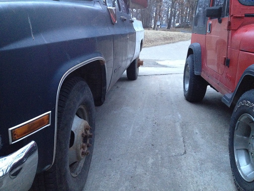

I'm sure it will be a while. More than likely I'll just pull the outer wheels and run it that way in the mean time.
I'm not sure. More than likely, I'll run it as is. I eventually plan on putting the tank either in the bed or between the frame rails.
Have a little bit of an update. Nothing huge, but worth mentioning.
A while back I pulled the outer wheels off the back.

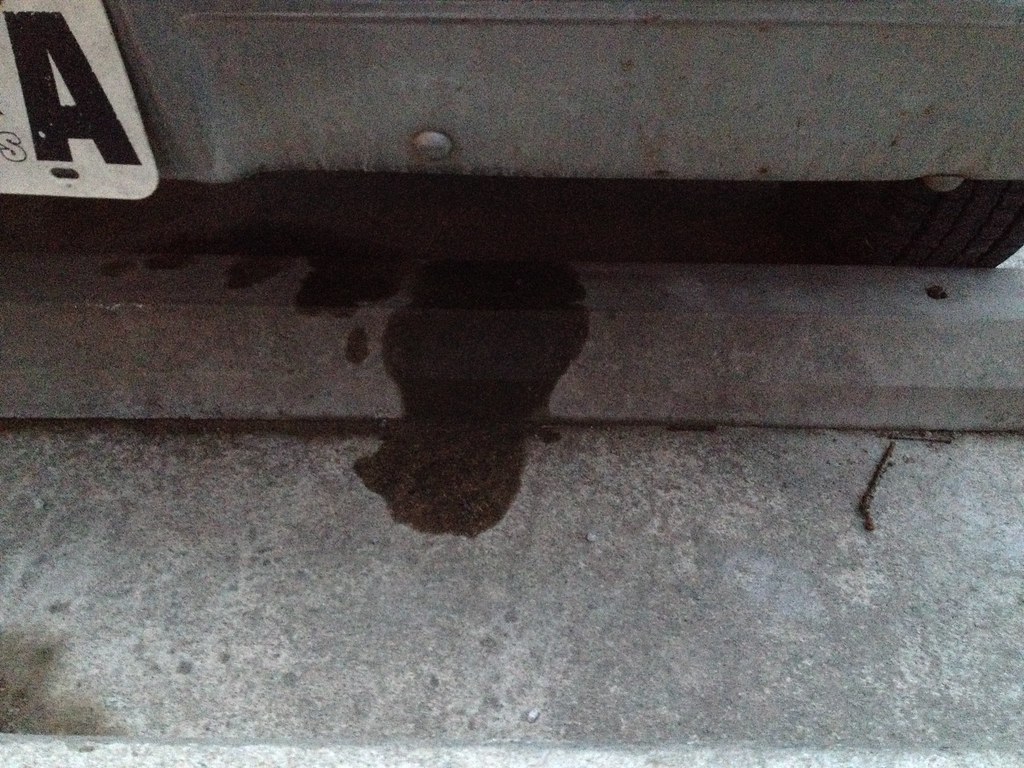

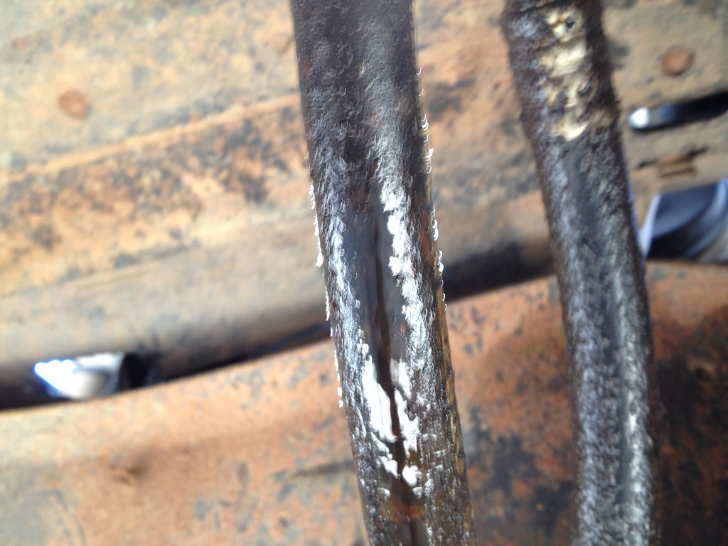

Last week, I noticed some oil under the front of the truck. Drove it home and noticed it was spraying out from somewhere underneath. After some looking, found one of the lines going to the oil cooler split.
Haven't had a chance to fix it yet, so I'm back in my father-in-law's heep...

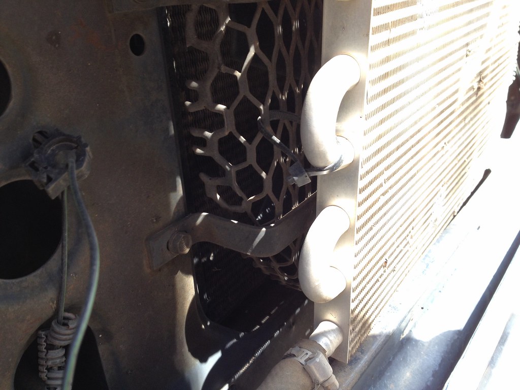

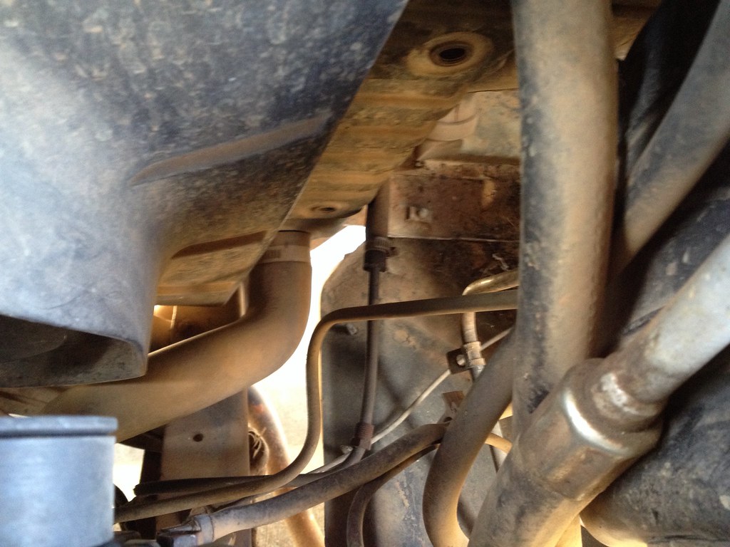

I pulled the grill off while looking for the leak and accessing how to fix it. I noticed some sort of auxiliary fan on a transmission cooler.
I know it's a trans cooler cause they bypassed the cooler in the radiator.
I'm not sure if I'll keep it that way or run it through both. I ran it through both on my blazer and it stayed cool. Time will tell.

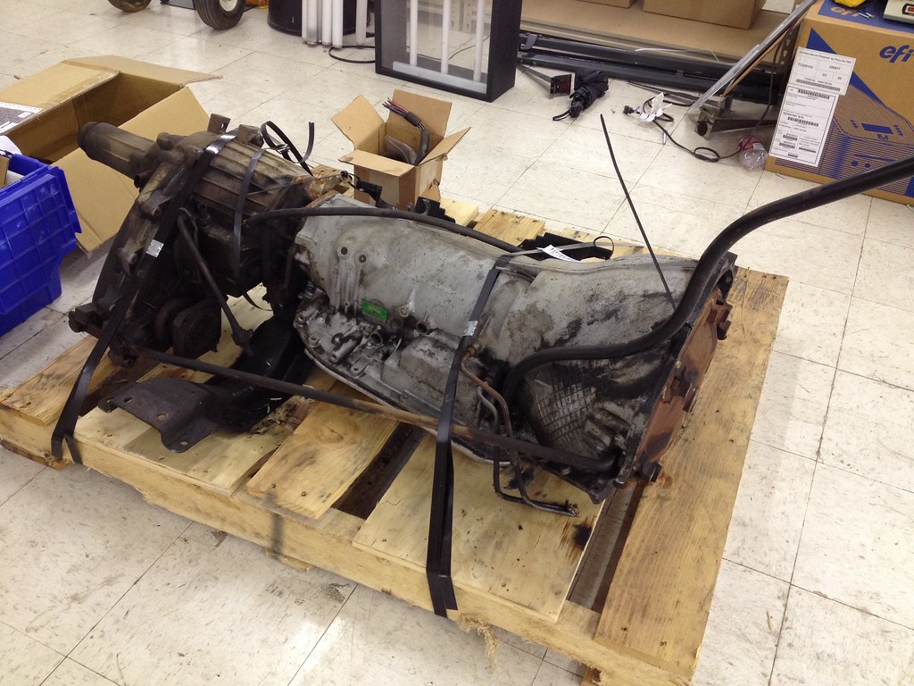

First up: a 4wd 4l80e with 50K on it with a passenger drop 241. Got it from warrpath4x4 on here.

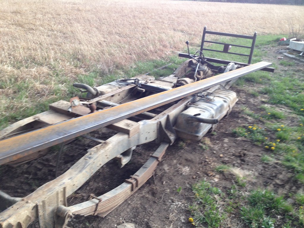

I was able to work a deal with someone on some parts and steal. I decided to swap the frame of the truck in the 4wd conversion as opposed to swapping all the parts to this frame.
I was able to get this frame, some 2x8 and 2x2 tubing for less than the cost of all the parts I would have had to get for the conversion. It's only a standard cab frame, so it may take a little more work, but from the research I've done, not a whole lot more.
Going to use the 2x8 for sliders and the 2x2 for crossmembers and such.
