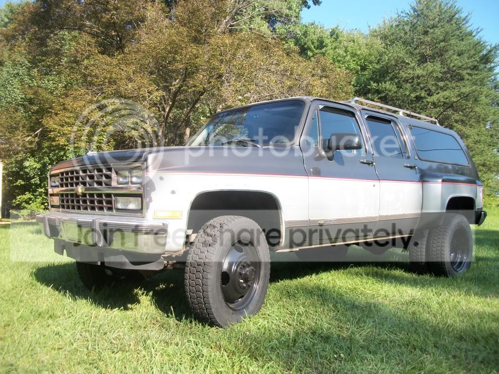

i bought the beast from my wife's cousin. it is in great shape. i really dont have to build it it was made this way from an aftermarket company but bought new like this from the dealer. my plans are to refine and update as money allows.
it has the tbi 350/4l60/241 combo with d60f/d70r with 4.10s. it drives nice with this combo deep gears and overdrive are super nice. my only project here is pm and a deep pan for the trans.

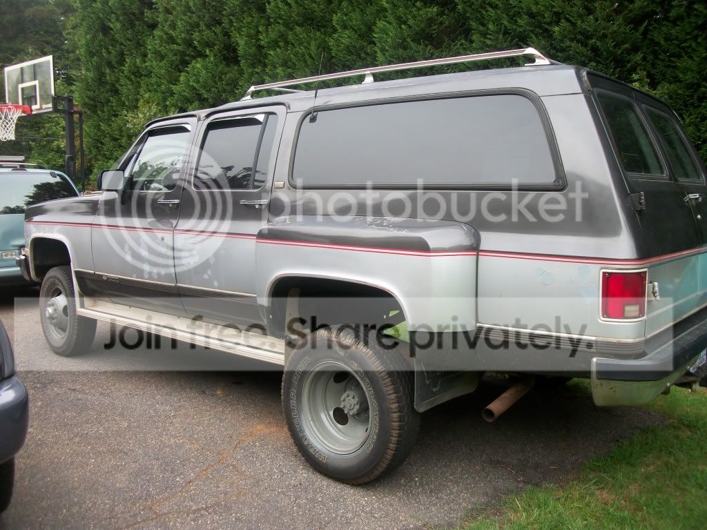

first update is wheel/tire combo. it has 215s on it and the speedo is reading 55mph when my gps says 50 so bigger meats it is. bummer right
so after talking with my long time friend kyle and he likes his 19.5s so i ordered some 245/70's and old bread truck wheels.

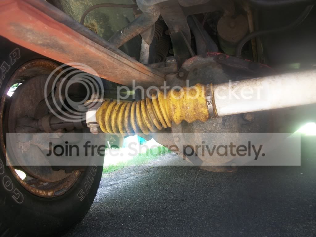

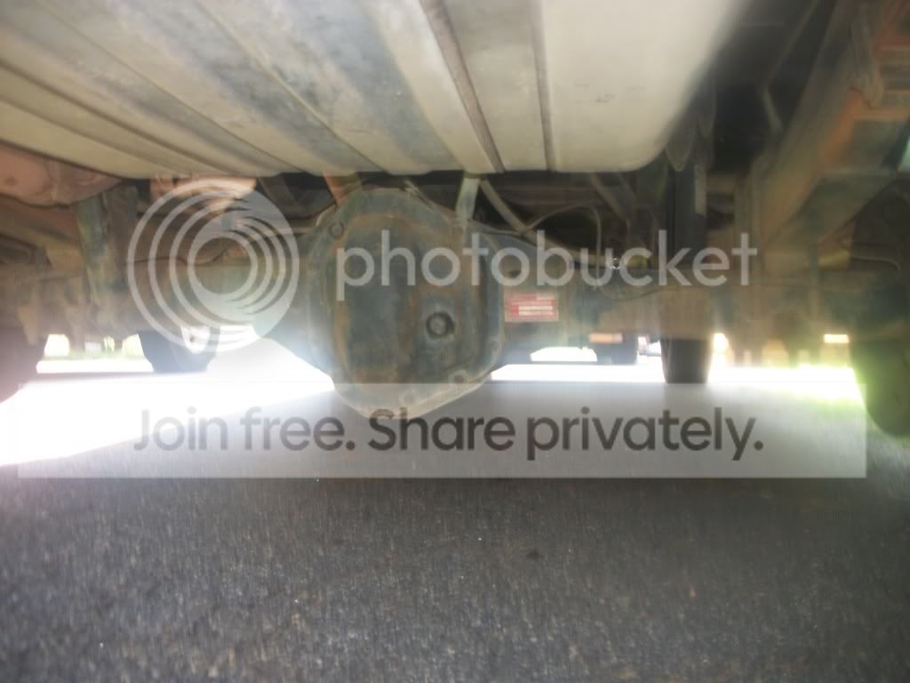

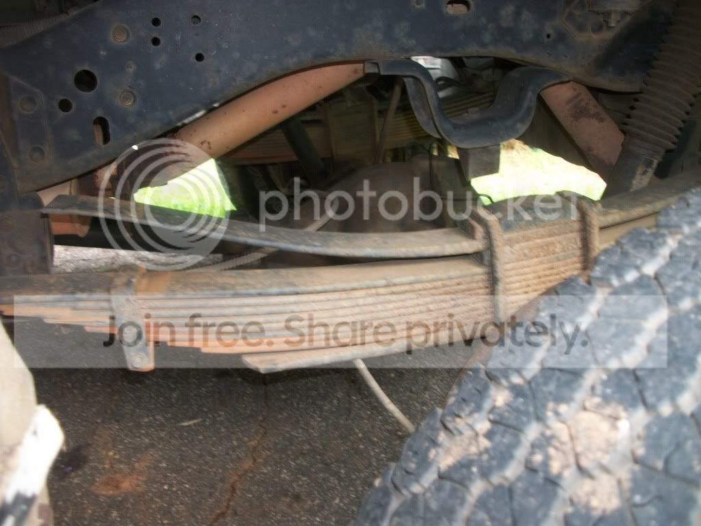

Pics of axles? Sure its a d60 front? Ive seen some goofy dually 10 bolt setups before....
yeap 60 front 70 hd rear 4 inch non neckdown tubes too bad there open
this might be why it rides like a dump truck!!!

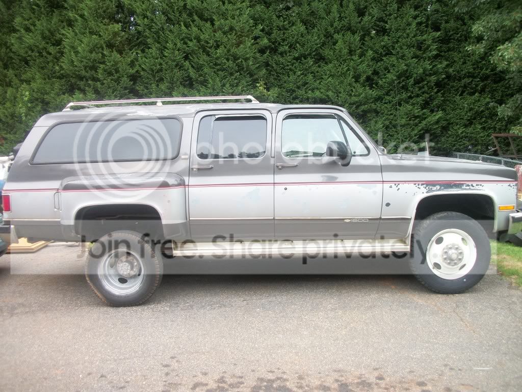

i don't want to lift it much. im thinking some 3/4 64in springs and just move the hangers?

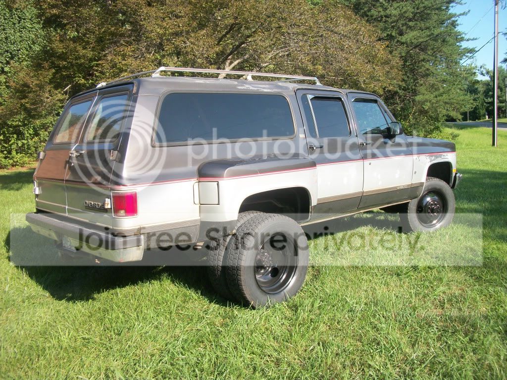

the whole reason behind the burban purchase. to take my wife and 4 kids comfortably to weekend outings and vacations. this was the big shakedown run with it. logged 500 miles on the setup.35 gallons of fuel up in the mountains fully loaded inside for 6 people for 5 days!! i love it more every time we use it. several miles of 7%, 9%, and 12% percent grades and it just chugged along. cheoah point campground santeetlah lake,nc. just below fontana dam.
Looks good!
Make sure that trans has a BIG aux cooler on it. THats a lot of truck for that trans, and excessive heat WILL kill it. A big cooler will help prolong its life.
Cool burb. But that top overload doesn't look like its doing anything
My dually has a set of those spring packs. You'd have to load a Prius in the back of the Burb along with the family to sit on the upper overloads. There's a reason why we call 'em "overloads" :haha:
-- A
