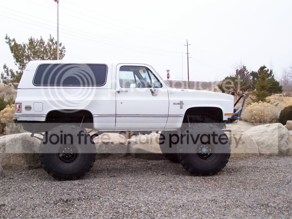

Glad to see some updates. I've always like this blazer! Anyways, i figured i would share with you what i did, because i'm running 56's flipped with the short end to the rear (to gain 4" in whell base) and like you i didnt like the offset of the wheel and wheel well, so i threw in a zero rate like you and offset the pin back to the front with the 1.5" holes, and this allowed me to get more wheel base length (2.5") and still look some what normal.
I'm sure if you wanted to go this route, it would look proportional with your newly modified wheel well openings. Just a thought. If you need any pics for reference, just let me know and i'll see what i can dig up.
Yeah, if you can throw up a pic I'd love to see it. I thought about going that route but I've read a few times about problems with wheel hop / pinion angle because you're on the wrong side of the spring arc. :dunno:
i will try and get a couple pics up tonight when i get done with work.
The sring wrap would be a concern, but depending on how bad it is you could always fab up a spring wrap bar, which may not be worth the extra 1.5" in wb gain from where you are now. I cant really give you any real life experience with this because the amount of flex my truck ever saw was some poser shots on a 4' tall embankment, but i really didnt see any real wrap effects from that (again it wasnt any real hardcore stuff either).
here is the best side shot i could find. I would get you a new one, but it will have to be this weekend, if thats ok. (it might look a little funny too because the k5 is now sitting on rockwells, and has dually rears on, ha).
let me know if you want anything specific, and i'll see what i can do.
Cory
That pic is perfect, THANKS!! Man, that thing looks good! :eek1: :pimp: :thumb:

With them backwards spring wrap is a problem. Mine would wheel hop like a bitch. I fabbed up an anti wrap bar with parts from Kert. Mine is 56's flipped & the spring perch with a new hole drilled one inch forward. Rear axle should be about 5" rearward.
