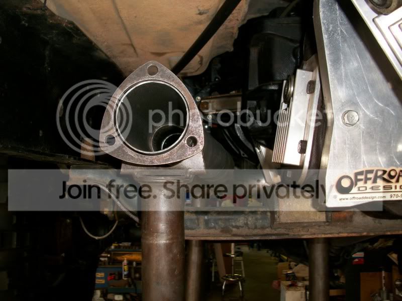

The system is Sanderson shorty headers # BB8 (specifically for 73-87(91) body trucks) into 2.5" primaries then into a Flowmaster "Y" w/ collector on the back side and single 3" pipe/Magnaflow #11259 muffler/tailpipe.

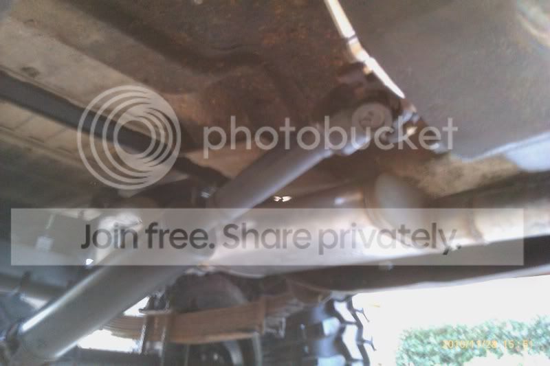

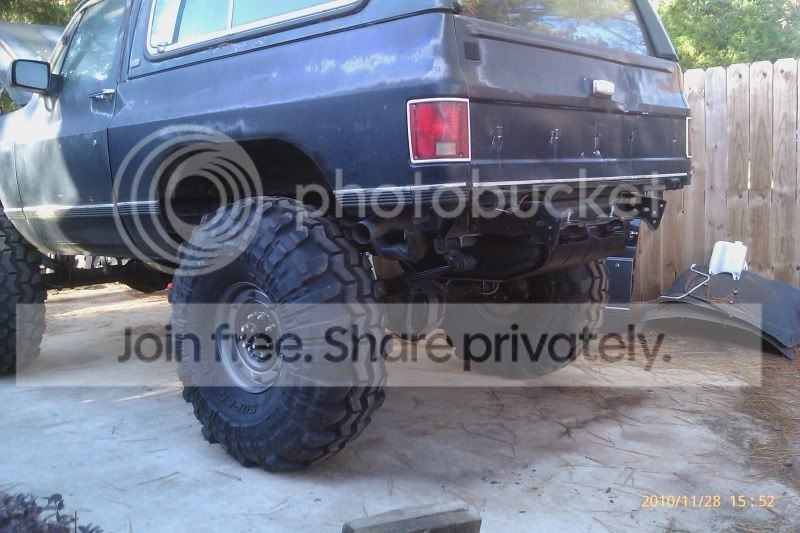

Here's a couple more pics of the exhaust to better show the "Y" pipe (you can see the rear collector @ thecrossmember), clearance around the muffler and how the tailpipe is routed. Initially I didn't want to run the tailpipe thru the frame/spring opening but to get the tailpipe to exit at the corner to avoid fumes inside it was the best option without a gay looking 90* bend.
