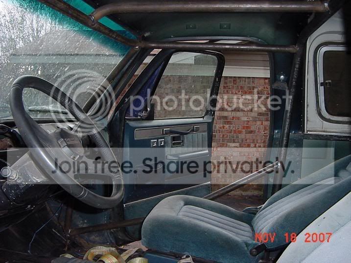

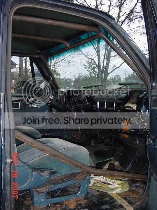

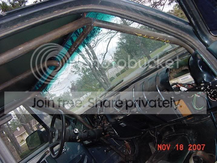

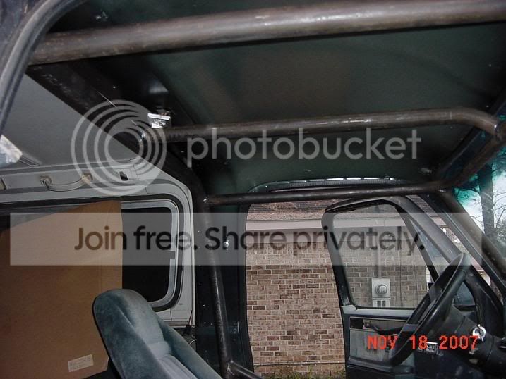

A week ago I took the family to visit a close friend in Tx, while we were there he did some cage work on my K5. Here are some pics - this is just the front half, I plan to take it back to Tx sometime after the first of the year to build the rear half, add some grab handles, etc...
looks like a great start on the cage, a couple question about ur lift thou.. are u running the b52's mounted at the forward most holes, what's the length of ur front shackle, do u have any pics of your dana 60 pinion angle and lastly, are u going to run the 3 in" body lift also? SOrry for all the questions, but it looks like a great start to a functional build..keep it up..
The B52's are mounted using the forward most holes in the brackets, meaning I could still shift them 1" forward. I actually want to push them forward but I've got to get my winch mount done first to make sure I have enough room to bolt everything together. The springs are 2.5" lift 52's with Kert's 7.25" shackles. I'll see if I have any pics that show the pinion angle. :thinking:
so ur sayin the b52's are mounted in the stock position i guess it would be called...looks sweet, from ur photos it looked like there was a bodylift on the truck before u put it back on the frame.. are u still runnin it?
Yeah, I guess they'd be in the stock position.
As for the body lift, it's got an ORD 1" on it now. The original chassis had a 3" but I ditched it when we swapped out the bent frame.
