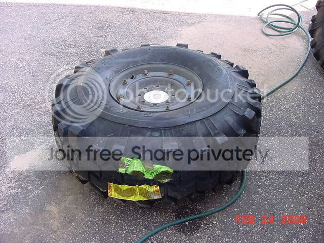

Well, I managed to do some more work... I cut down the mag runflats and mounted my tires. Here are some pics, for the record they're unmodified H1's with 42" TSL's

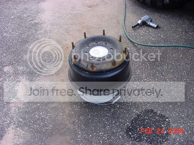

The old 5 gal bucket trick for mounting -

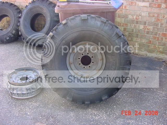

The run flats cut down (not nearly as big of a pita as I thought it'd be)
I ran out of daylight so here's a crappy nighttime pic (thanks to "NewUser" for brightening it up for me)
I'll get some better pics (with all 4 tires :D ) next weekend.
Yeah, I've got lots-o-cuttin to do but I just couldn't stand it! I wanted to see what it'd look like. :rotfl: I have to admit, it's taller that I thought it'd be. :crazy: :doah:

I used a sawzall with a wood cutting blade (10 tpi, I think it was) to cut the runflats. The hardest part was figuring out how to hold them while I cut. The best way for me was to punch a hole with a holesaw (for a starting point) and then put the rim & runflat on a 5 gal bucket while my wife rotated the runflat as I held the saw. Everything else I tried left me chasing the runflat while it flopped around loose or tried to turn on the rim when I was by myself.
I used a 4" grinder with a flapper disc to finish out the cut runflat. One thing I never noticed in any write up with that the first rib next to the bolts gets in the way of a ratchet/socket. If I did it again I would take that rib down flush so it wouldn't be in the way at all.
