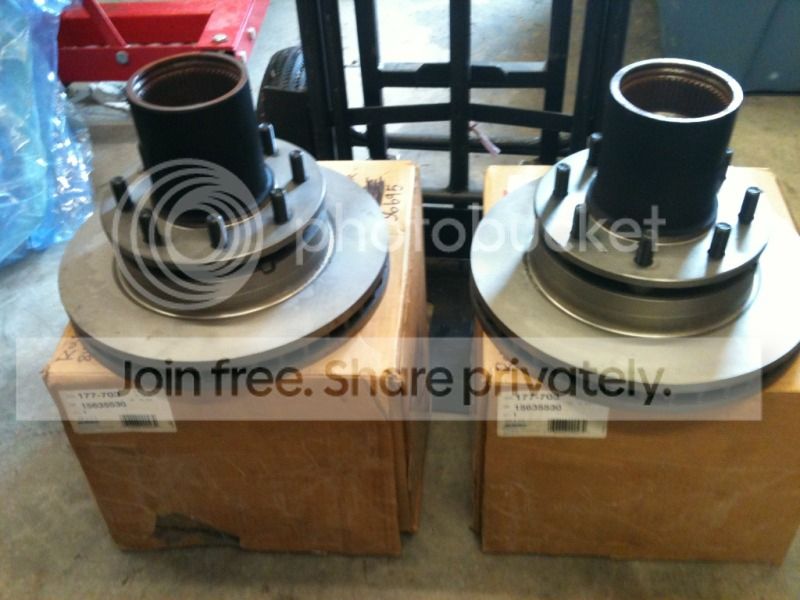

Way back, I tore the 60 down and sold some parts while the motor was out so I wanted o reassemble it enough to put tires on it (it was on jack stands and too high for the motor hoist). I spent the day cleaning and installing the new bearing hubs so I wanted to see it with all for 4 tires on -
These were so sweet, I had to stop for a pic. :pimp:
