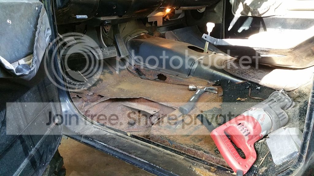

Since we're both working on the cage at the same time, I've come to a bit of a hold up that I didn't foresee and wondering if there is an easy way over this hurdle: My floor pan (assuming yours too) has another layer/pan underneath it (picture below), not sure if there is an easier way to remove it other than cutting it, but it makes the bottom not accessible to sandwich the plates. Is yours the same? Or do you have just one layer?
Not hard to cut this front one out, but the back for the B Pillar is going to be a PITA, so trying to find an easier solution.
Maybe cut a window in it but don't cut it out. That double layers are the rocker boxes that come on the 73-75 full top Blazers, it strengthens your tub since you don't have the metal roof for support. I would search and find a build thread for a 73-75 with a cage for advice.
Not having the rocker boxes is my issue. Without them when I cut the roof off my single layer tub becomes flimsy and moves around a lot. This is why I NEED to tie my cage to the body in order to add strength back in when I cut the roof off.
