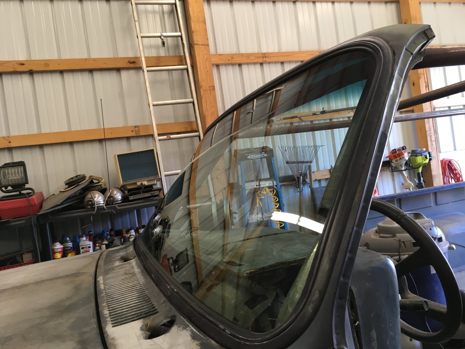

Now the part I think I'm happiest about - it's got a windshield! After doing the full top conversion, I've been worried about how well I lined up the new upper frame and the new glass fitting but it fit like a glove!

It really was. I was worried about it just because it was a big project and I’m not a body man, but it was compounded when another member here had to recut the windshield posts when his glass didn’t fit. :yikes:

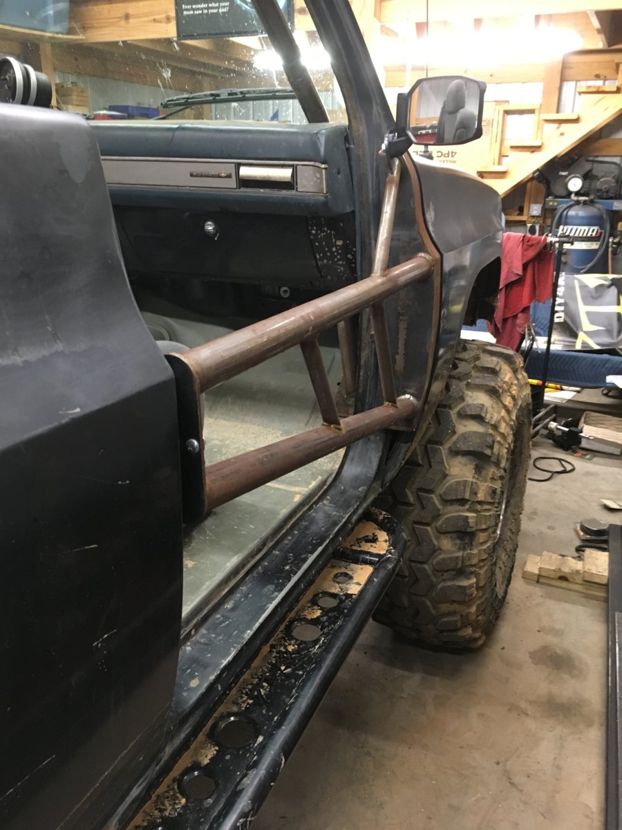

Cage stuffs...
Stepped B pillar plates I had Kert make.

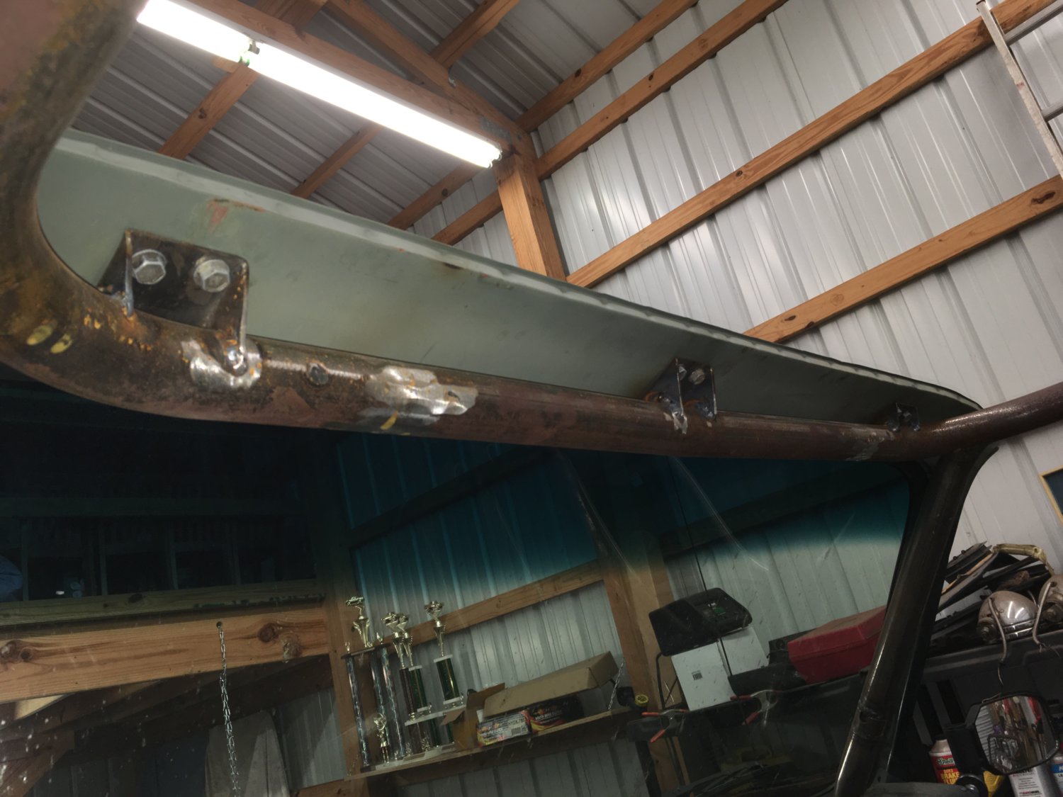

We decided to use the removable top mounting bracket holes as cage to body ties. There will be more lower later.
