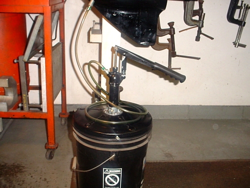

What’s the professional way to fill the drive from the bottom? I hate those disposable hand pumps
we run the 5 gallon pump set up.. like this..... take a pretty good beating...
pull both plugs... thread into bottom hole.. pump until it comes out the top hole... Bravo is about 50 to 60 pumps depending on temp... put top plug in.. unthread fill from bottom and slap that plug in...
keep in mind, it's a Bravo.. it is being fed by your bottle on the engine.... so it's gonna gravity feed fill the whole upper after... make sure you top off the bottle when you reinstall a drive.. as they will generally "burp" once run and lower the bottle.. if the bottle goes empty,you will get an alarm...
