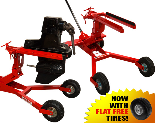

well, one more while on lunch here... your biggest issue is not having a yard arm... without it, drive install/removal can be a pain.. that bravo is about 175 lbs... (alphas only weigh about 90 but they suck cuz it's a 3 handed clusterflug with the shifter arm.. ) bravo's are easy, it's just gettting the spline to engage, and hooking the shift cable into the latch.. but it's a heavy SOB...
removal isn't that big of a deal, trim up and remove speedo hose if so equipped, trim down, pull the trim pin, 6 nuts, pull out drive a couple inches, disconnect shift cable latch, slide it till the shaft comes out.. plop it on the ground.... install without a yard arm, you're gonna need two people, and even than it can suck a bit...
That pic and emphasis is super helpful. I’ll build something I can put on dollys.
keep in mind, physically installing it, you may still need to manually jostle it around off of your cart, another pair of hands will be useful... it's not a "oh, it's close enough, shove it in" kinda deal... there's only a small window of angle and height where it will go on.. and drives vary from one to the other on how hard they are to install depending on a few things... it may have to be adjusted height-wise and angle-wise while you try to get the splines to engage.. that's what makes the yardarm so valuable, it not only goes up/down, but tilts left/right and front/back... and maintains that as you slide the drive back in..
oh, don't ever glue any rubber gaskets, o-rings in... some idjits use weatherstrip adhesive.. marine grease and press in... and don't replace the 3 o-rings on the input shaft of the drive.. make sure they are there, but leave em.. trust me on that.. you'll have a hella time getting the drive back on with fresh ones..... sometimes i actually have to take a big ole hunk of 12" x 12" lumber and drive the lower on to get it past fresh ones...
