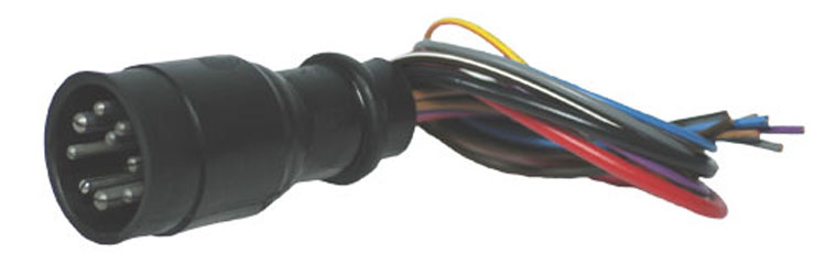

did you check the contacts on the hoseclamped, multi-pin boat to engine harness?
Nope. Hoseclamped harness? Hahaha
Any idea where I’d find that beast?
No changes to gauges or dash, so I’d expect it to be in the engine bay.
I do some hunting around the firewall. I just checked the connections at the ecm, didn’t see any other major ones, but I’ll hunt for this one now. Thanks!
it looks like this.....
should be a bracket at the back stb side head, that, that plugs into the other 1/2..... it has a hose clamp that sits in that recess there, and clamps the 2 together...
