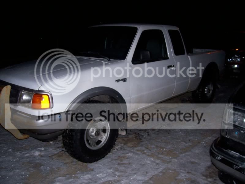

I just want it level and will stay with 31's. I am sure the alignment is off coils would actually be better than spacers. i think you are correct about the stock coils being sagged. If I remember correctly from auto class (13 years ago LMAO) it should use the bushings with an offset hole for alignment? that over time and abuse get turned and or worn out? I would imagine it uses unit bearing in the front?

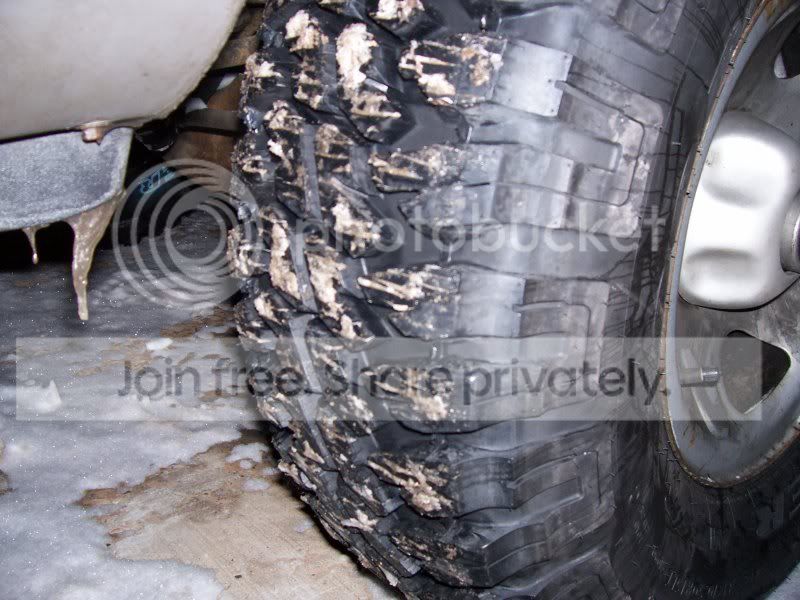

Oh im sure it is out of alignment the old tires are cupped and feathered but I kept 3 of them for spares. The MTR's are discontinued and have ZERO warranty.

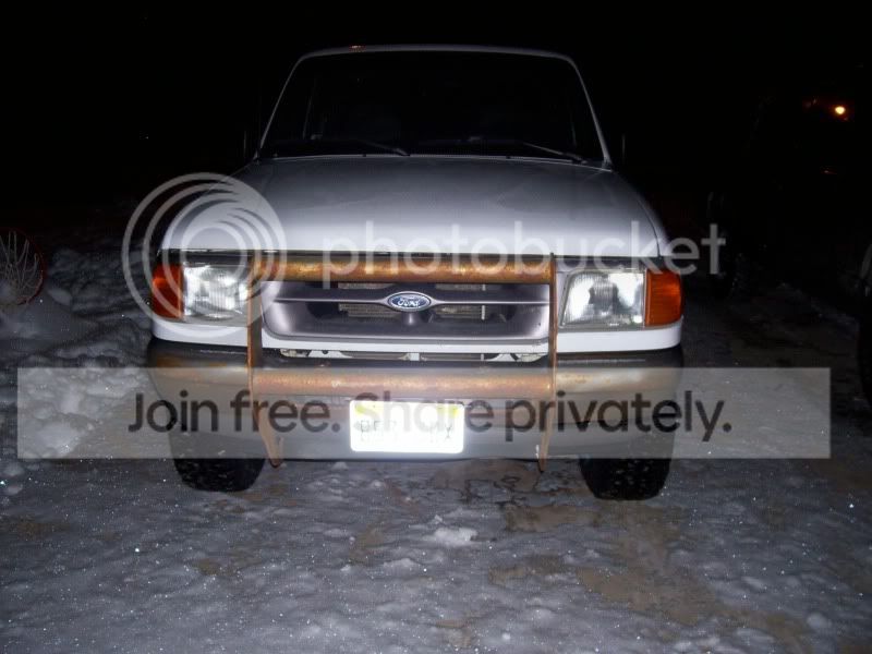

dark but heres pics.
They are good trucks. Head and shoulders above a S10/S15 and in my opinion second only to a Toyota in the minitrucks of the era. Ford did build them durable...if a bit overly complicated in some places.
