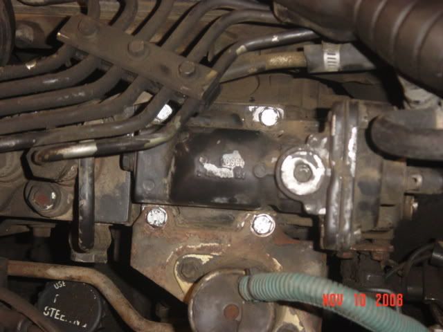

As its all been said, 15,5K is too high. check the breakout screw on the AFC housing. if its intact. either the pump has never been opened, or someone went to some pains to install a new breakout screw after they fooled with it. usually no one ever puts in a new breakout. just replace it with a metric bolt.

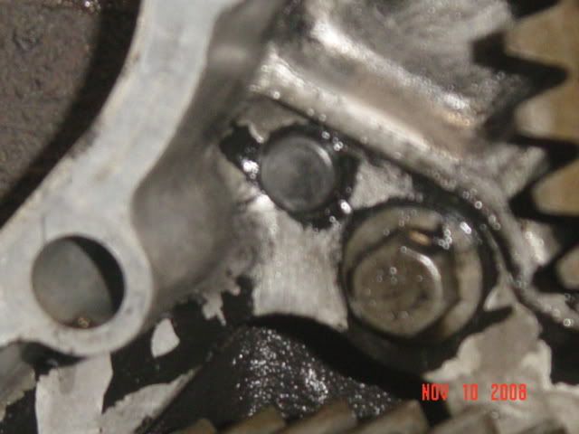

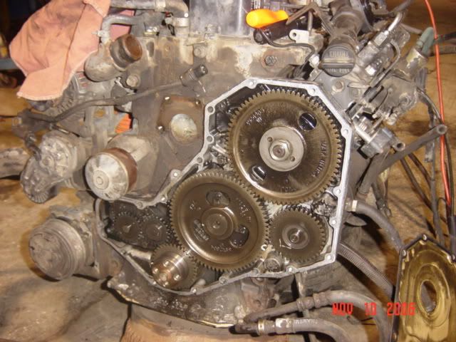

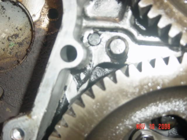

the killer dowl pin is a 100% easy, need to fix on any 12v. gearcase alignment dowl falls out into the geartrain A) nothing happens and it falls into the oil pan. B) catches a gear and gets shot out the timing case cause a major oil leak from the hole. C) gets caught between 2 gears and you have a catastrophic engine failure.
this was the 'KDP on my '95. was 1/4 of the way out already. bottom left of the injection pump gear, and almost directly above the cam gear. I just stake'd mine, but you can tab it off the bolt beside it. or drill and tap the gearcase to the left of it and put a long bolt in to block it. but you need a jig for that. BUT you don't have to remove the gearcase cover and do the front seal.
If you stand at the driverside fender and look down on the injection pump. Here the top of the AFC housing, the breakout bolt is usually the front passenger side bolt. the one under the injection lines, hardest to get to sort of thing. if its a regular bolt........someone has been in there for sure. if it looks like you'd wonder how to get it out. its the breakout bolt.
